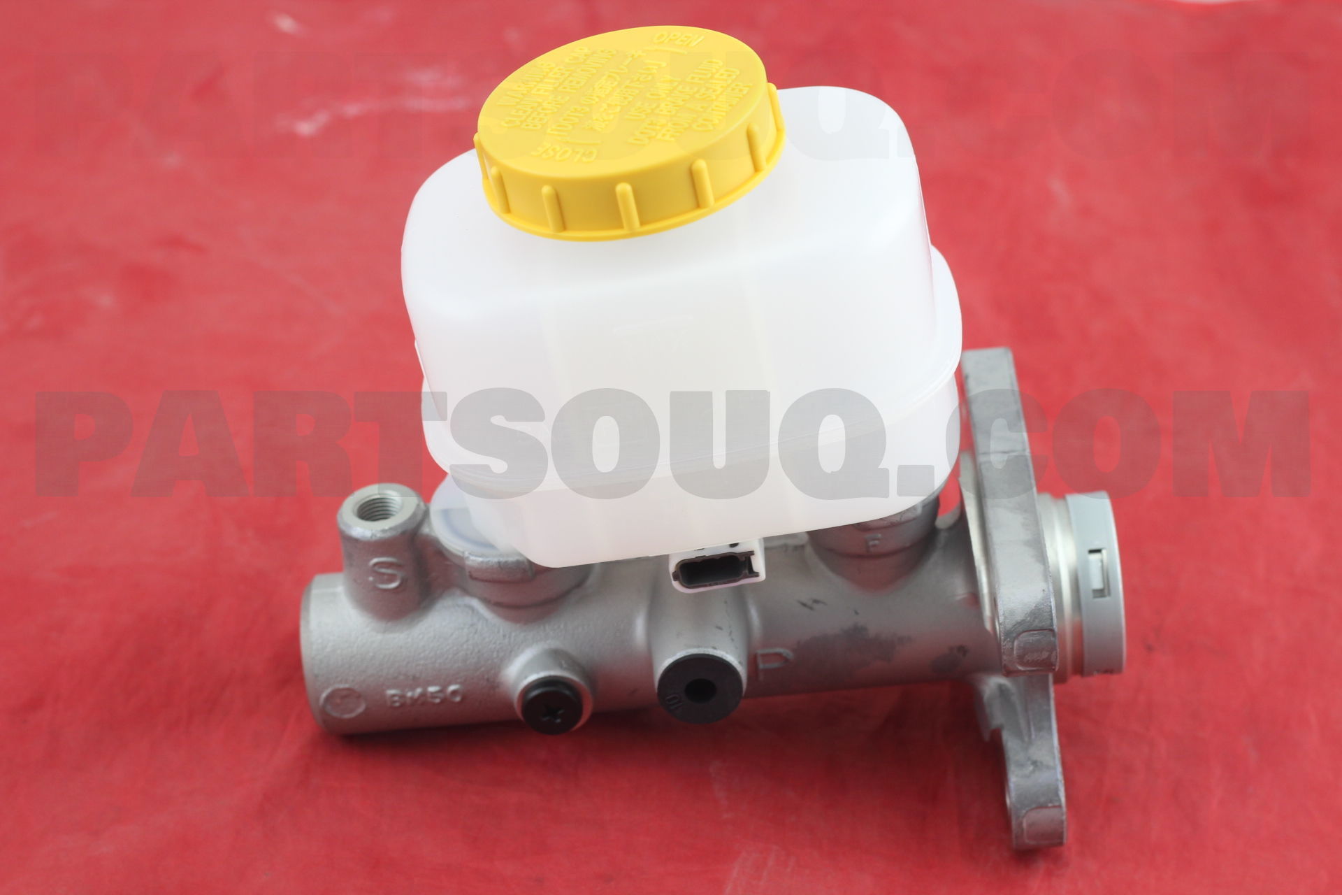

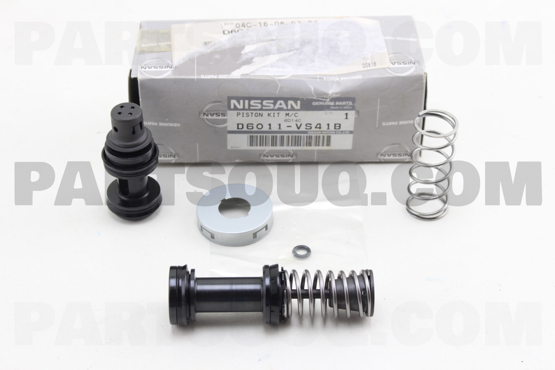

I've just finished an order fro Partsouq.com and thought I would post this:
The seal kit is freely available.
From ebay :
https://www.ebay.com/itm/114477972354?e ... SwaWFgBErY
R280 all in. Autofren is german and is used by most brands.So it matches Tokico.
From Partsouq :
Oem seal kit $35
Oem master cylinder assy $165
https://partsouq.com/en/catalog/genuine ... d=19948&q=
Stuff from Partsouq comes within a couple of weeks, you pay the import cost and bolt on.
So pop in a fong kong kit from Autozone and enjoy your Trollie while u wait for the oem item
