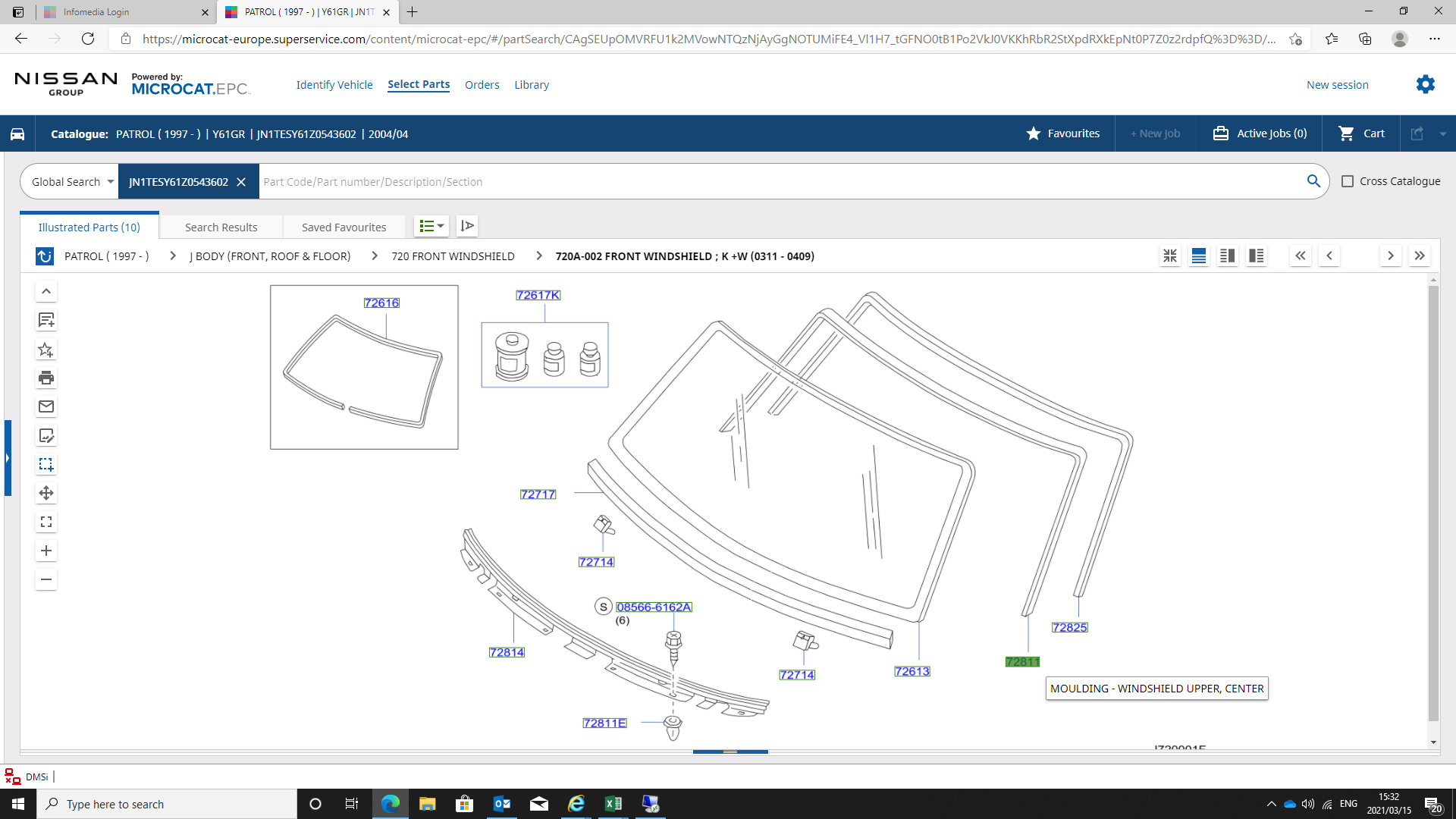

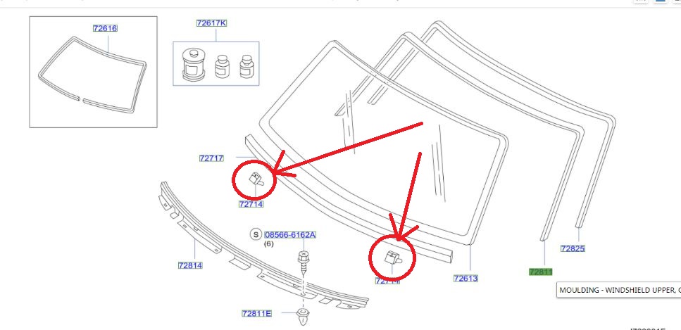

yeah these are the 2 plastic (I think orange in colour) I was talking about. The somehow break easily

So, from a simple cracked windscreen to a R6k+ quote from the panel beaters to replace both the inner and outer beads (2nd new outer bead), cowl panel clips, grommets, refit the windscreen properly for the 3rd time etc...
Of course, Nissan don't have the parts in stock, so now the long wait and fight with the insurance about the excess starts... :redface:

Been down this road before a few times and what i leant is:
- the little windscreen clips are not essential post fitment, they simply there to space the windscreen during fitment, so any good fitter just uses a spacer block or similar to do the job.
- the 2 nissan windscreen mouldings cost around R2400-R2700 for both. The inner moulding that seats against the bodywork is the most important one, as this stops water ingress etc, and has weep holes should anything pass, if this seal is Damaged or deformed, just get a new one. It's the more expensive of the 2 however. at this point, check for rust around window and repair if needed, prior to new fitment.
-The outer moulding is actually just a locking strip. This can often be reused if in decent condition. it's the cheaper of the two.
-Nissan cape town does not stock these, and must be ordered ex JHB stock. a few days.
If they no longer carry stock, it will be 6 weeks wait.
