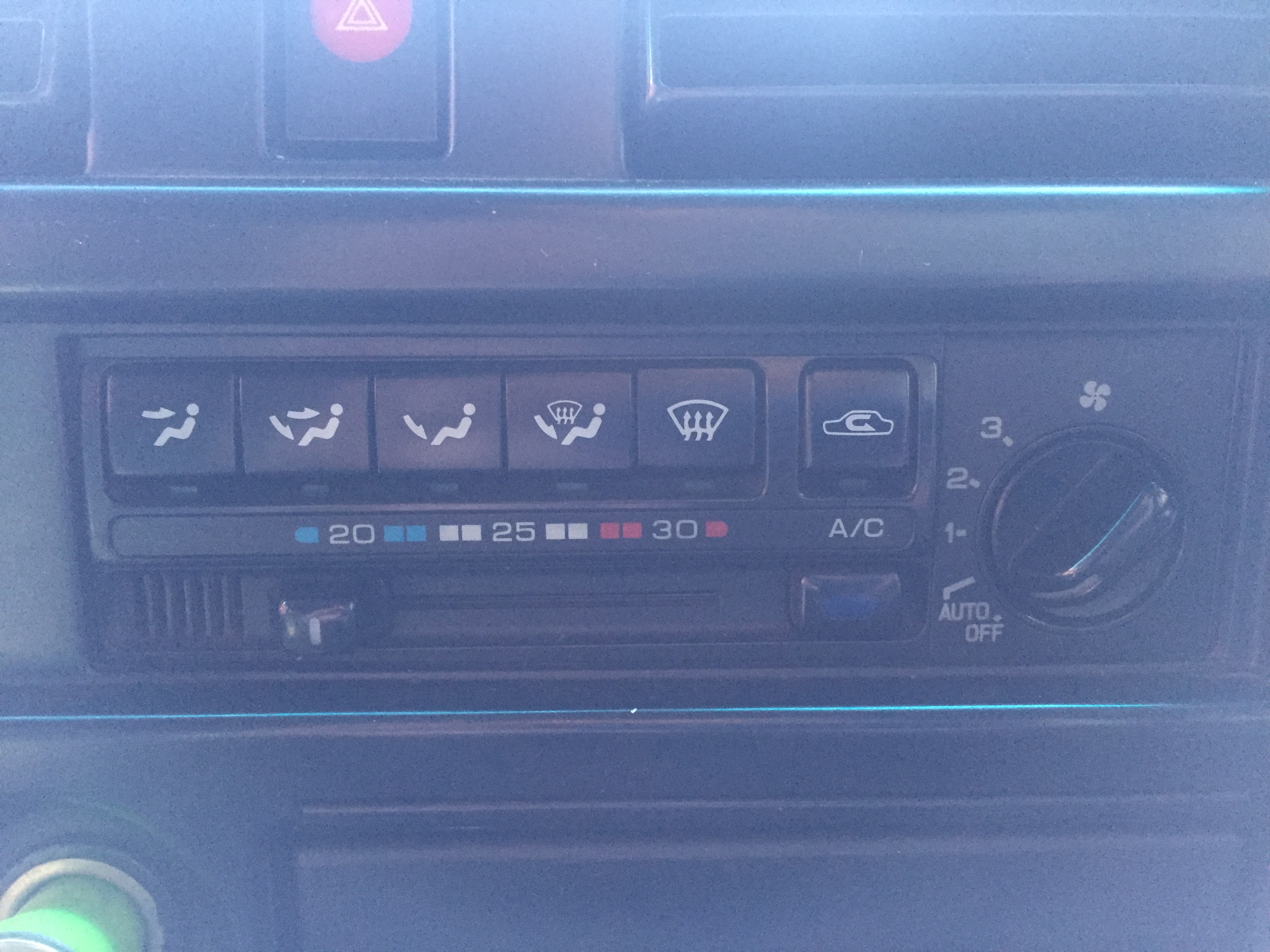

My car’s fan/heater “console” temp slider does not actually work. Ac is always at max cold setting, which makes me wonder then would there then never be water flowing through these two hoses? There will be water pressure in first hose going into heater but not flowing through heater into second hose going back to water pump/radiator? Not sure how the heater matrix works :think:
The bottom hose feels softer than the one going back to radiator side...

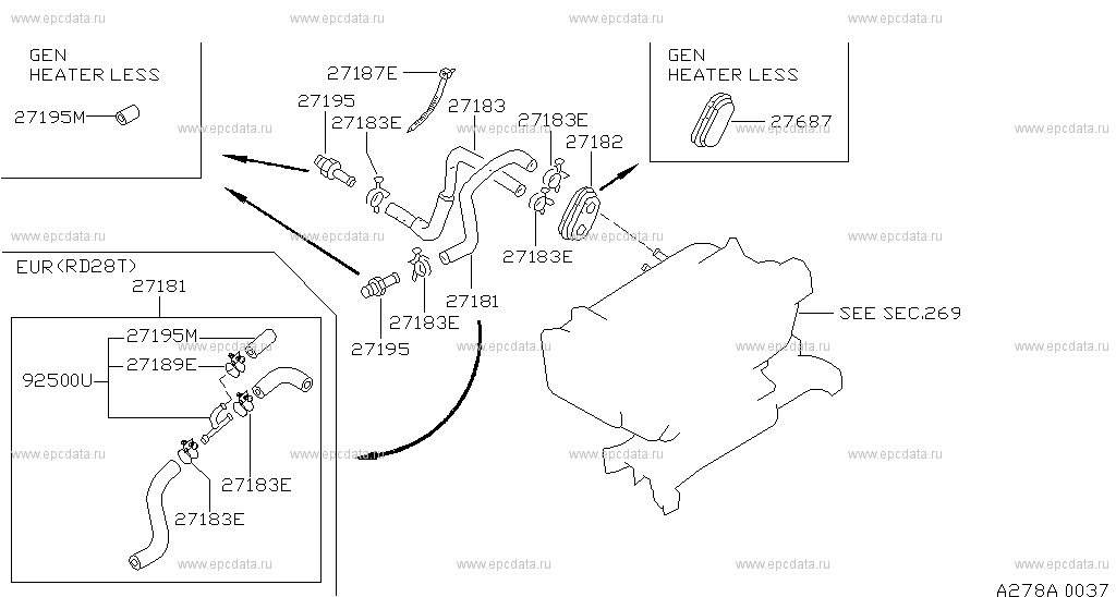

Found part numbers:
9240032J00
9241032J00
https://nissan-europe.epc-data.com/patr ... 278/27181/
