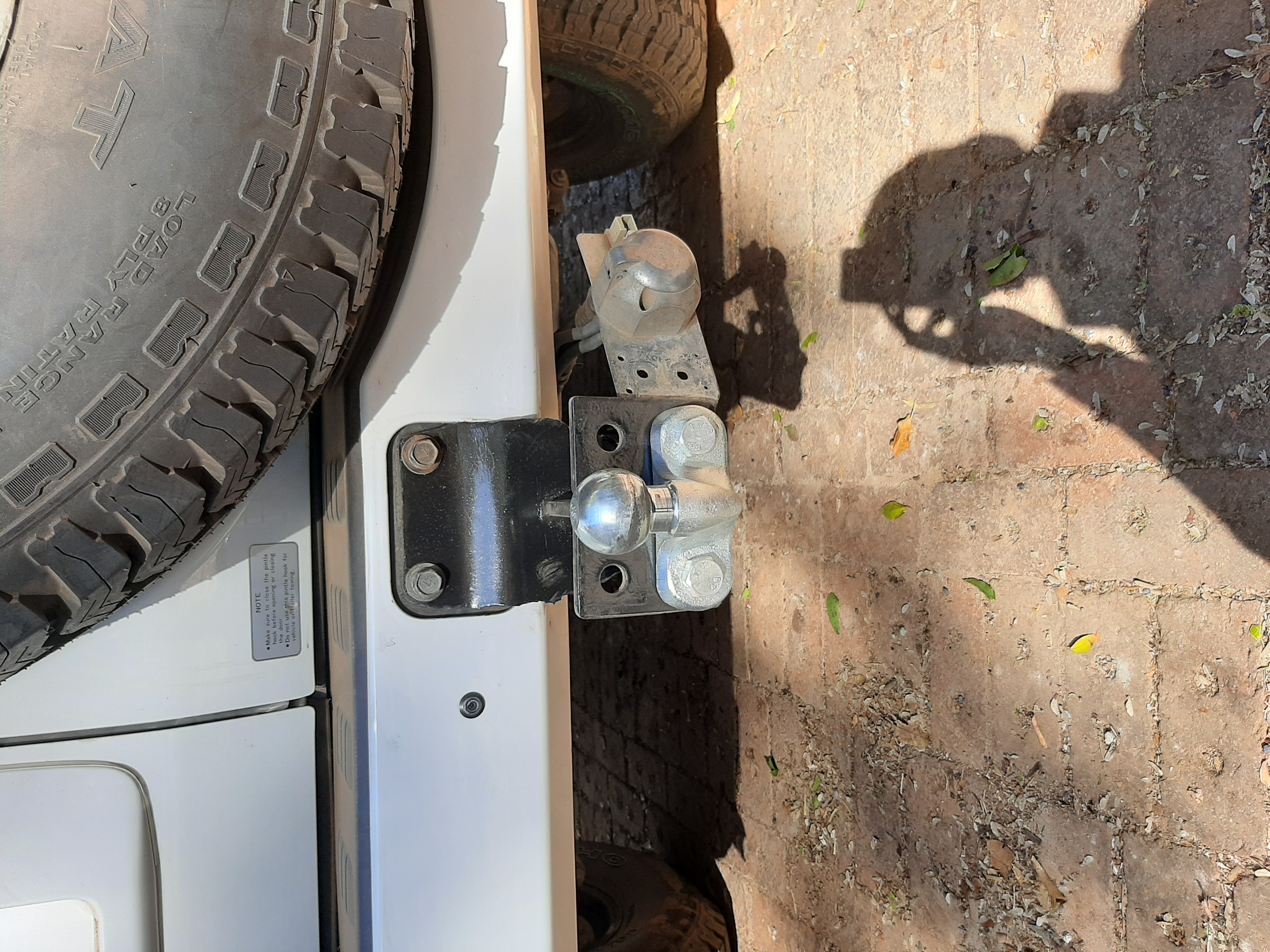

Is this towbar safe?
Re: Is this towbar safe?
DawidT wrote: 23 Jun 2020 09:17 This is what it looks like behind the bumper! Mine broke off. Rather get a proper tow hitch.
viewtopic.php?p=63346#p63346
Yip!
This is the exact post I was referring to

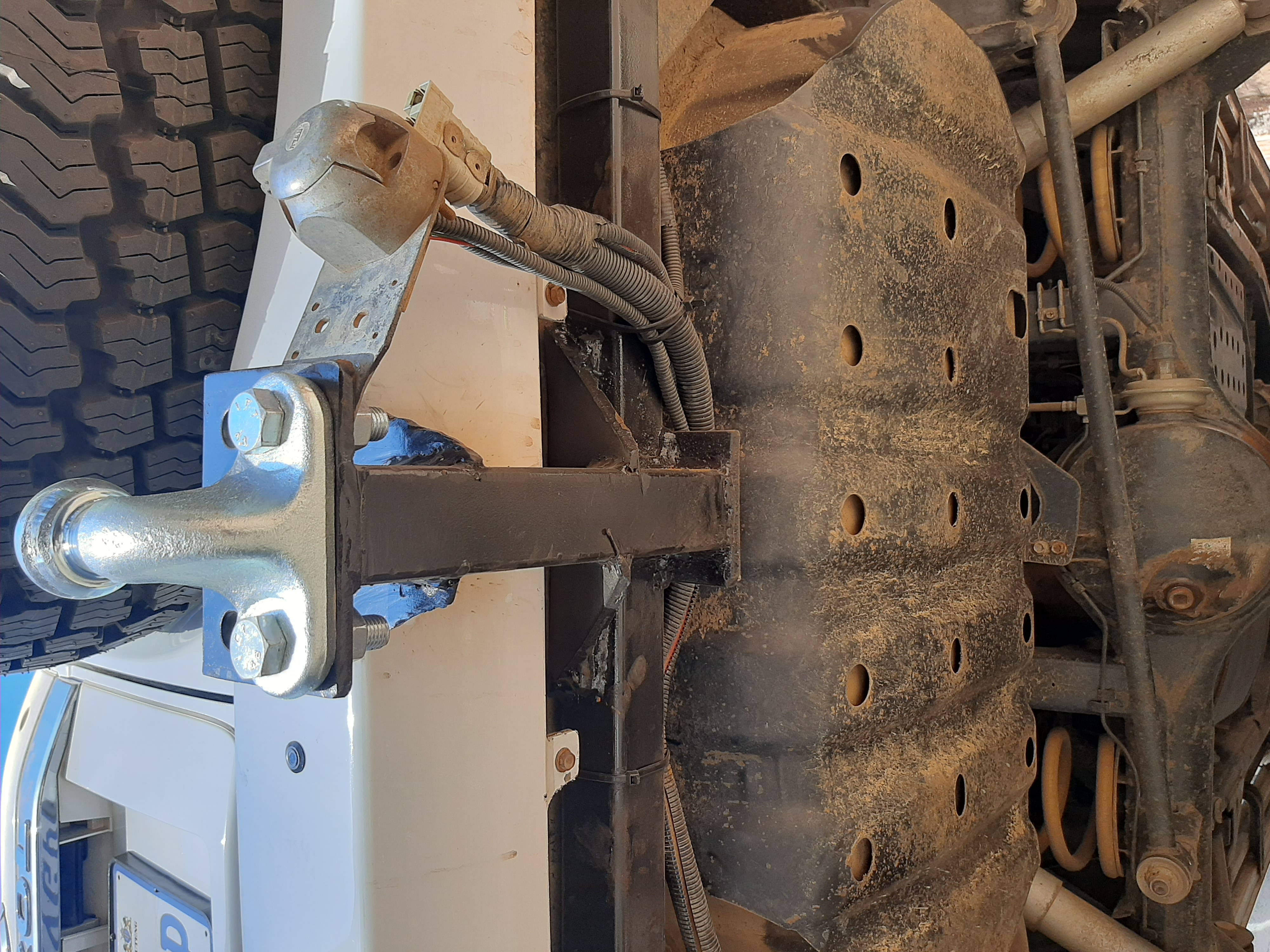

I went to Steelite and they built a towbar for me. It attaches under the bumper to the chassis rails AND to the recovery point on the back. So three points of attachment and they reckon it will tow as much as the patrol can handle. Not the prettiest construction but seems very solid! Charged me R3900 which I think is pretty reasonable.
Cheers, Gareth
