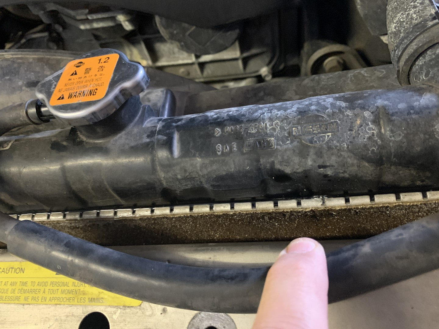

Re: HELP - Radiator leaks!!
Lyk my die ding is aansteeklik
- IMG_5044 (Large).jpeg (345.3 KiB) Viewed 6727 times

JohnBoy.... you need to sort that out bud..... I get goosebumps looking at that.....
