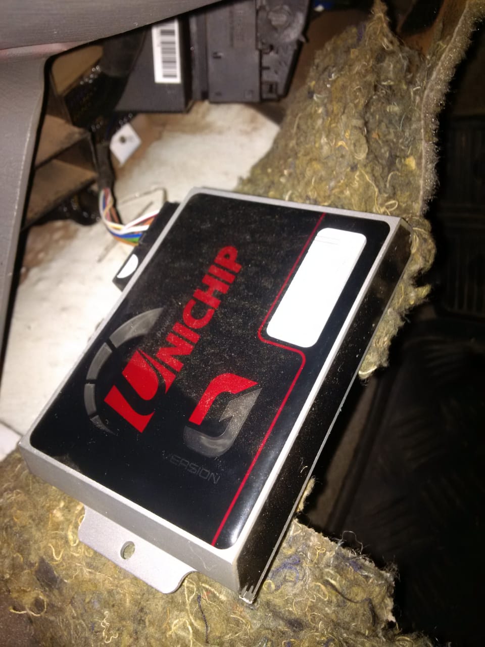

So I had a look around last night and found this :
It looks like the EGR is blocked off too. Guess we'll see what the numbers are at the dyno day on Saturday.

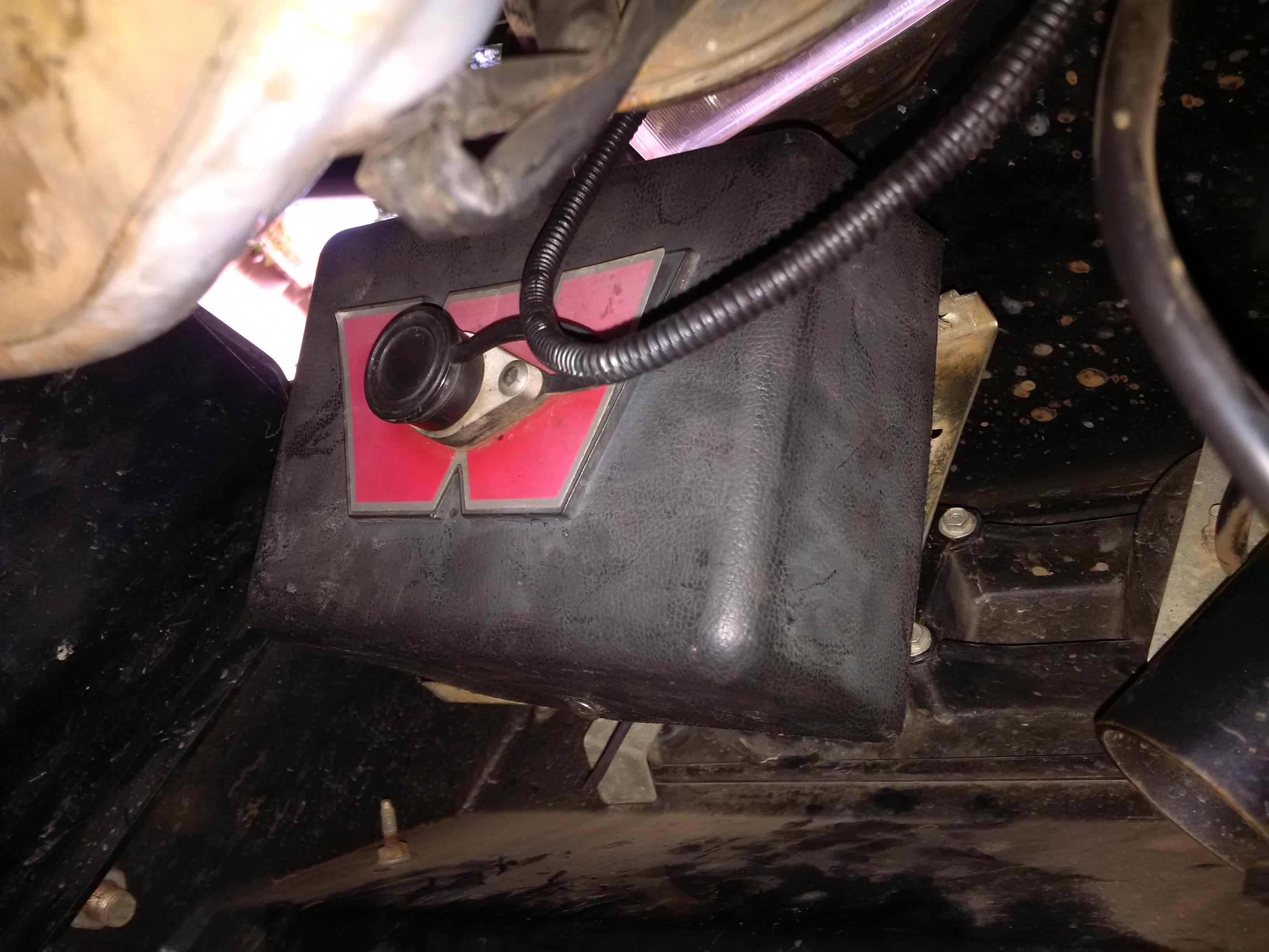

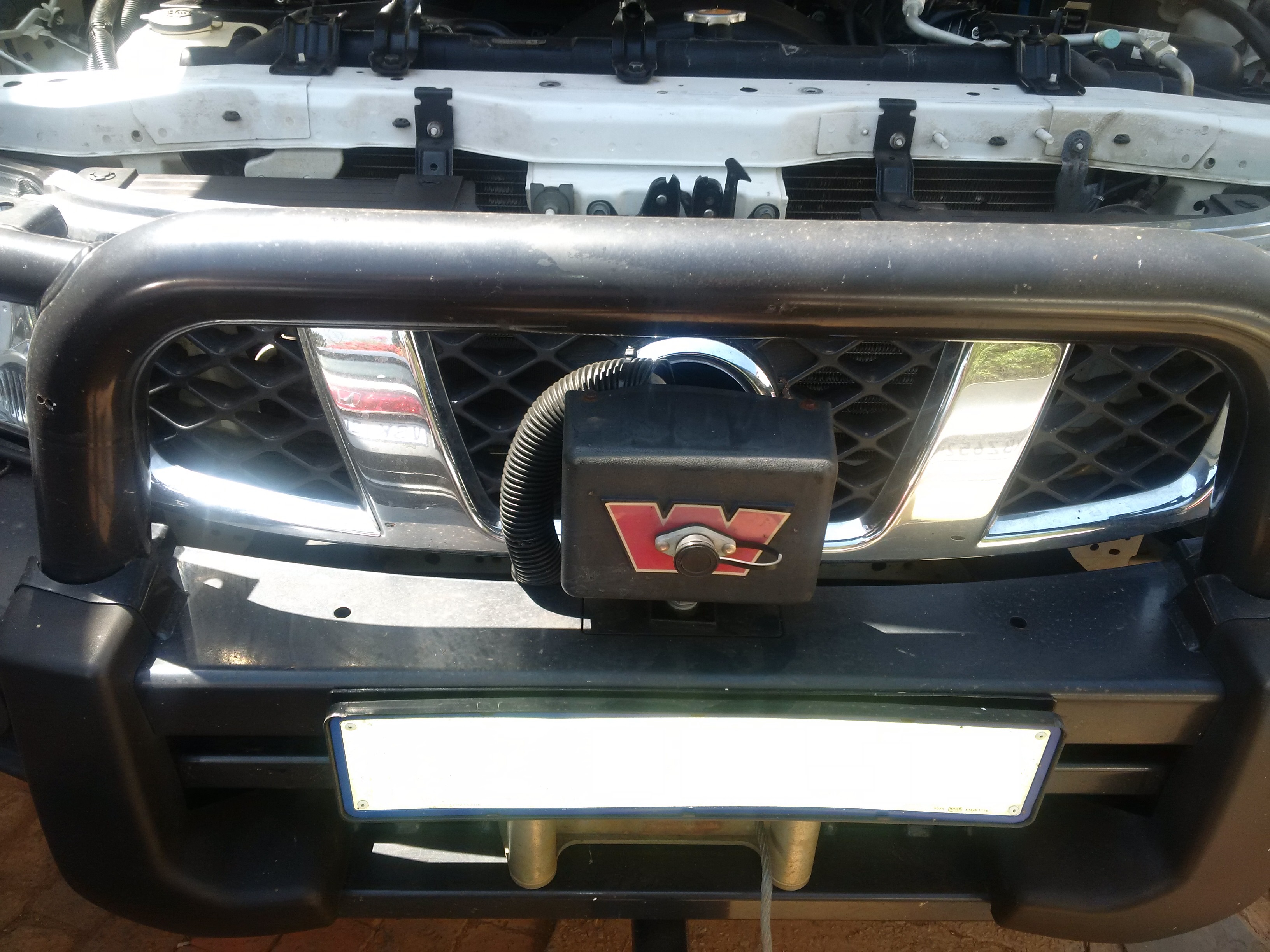

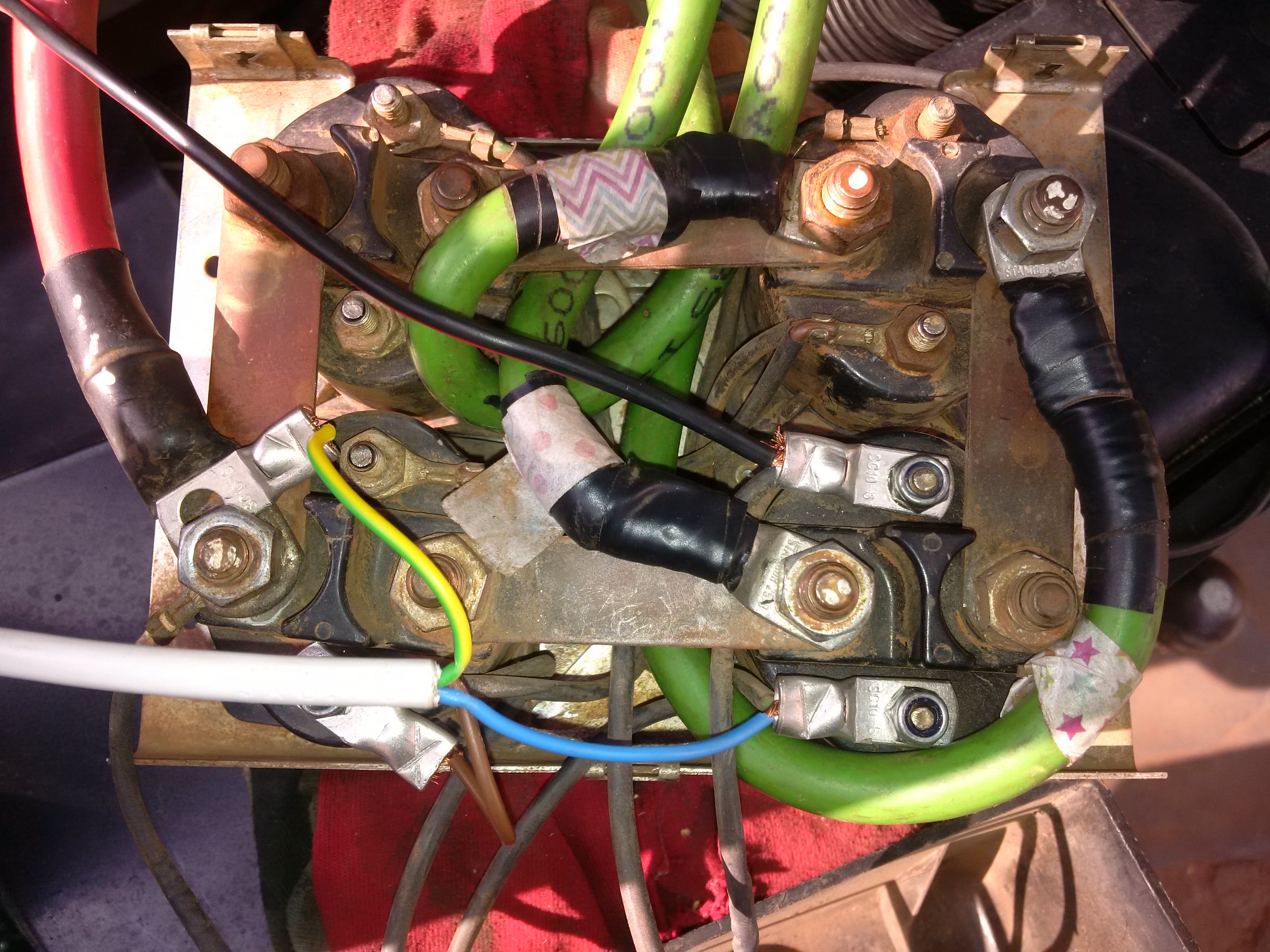

So when I purchased Patrolicus from webuycars, they had lost the winch remote. It also had the control box bolted to the top of the bullbar right in front of the Nissan badge. Bad for airflow, and bad for looks. So this weekend I set about moving it and wiring up some in cab controls.
The problem...

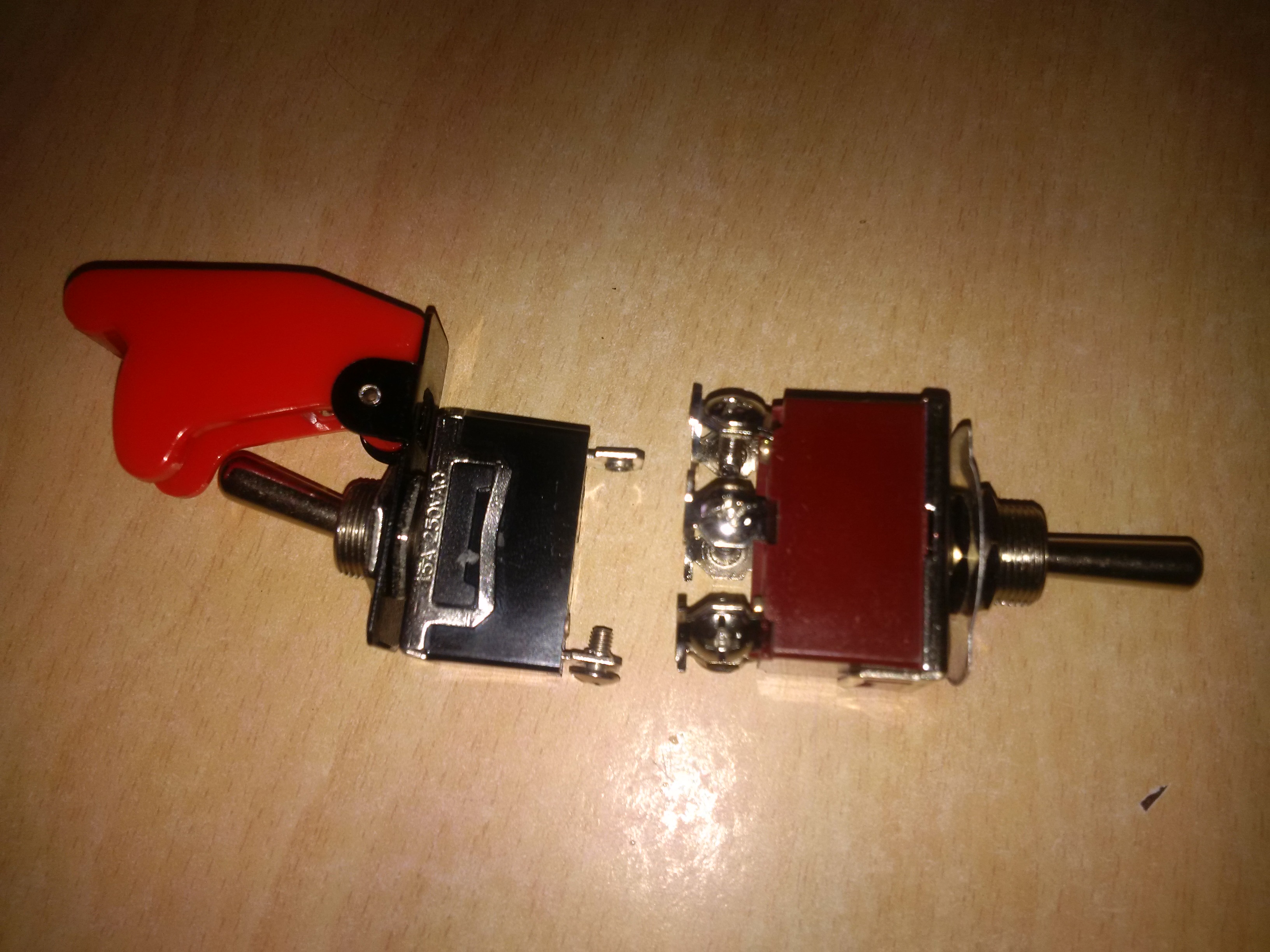

Part of the solution...
I got a safety switch and a 6 pole momentary switch from the local 4x4 supply depot for the in cab controls.

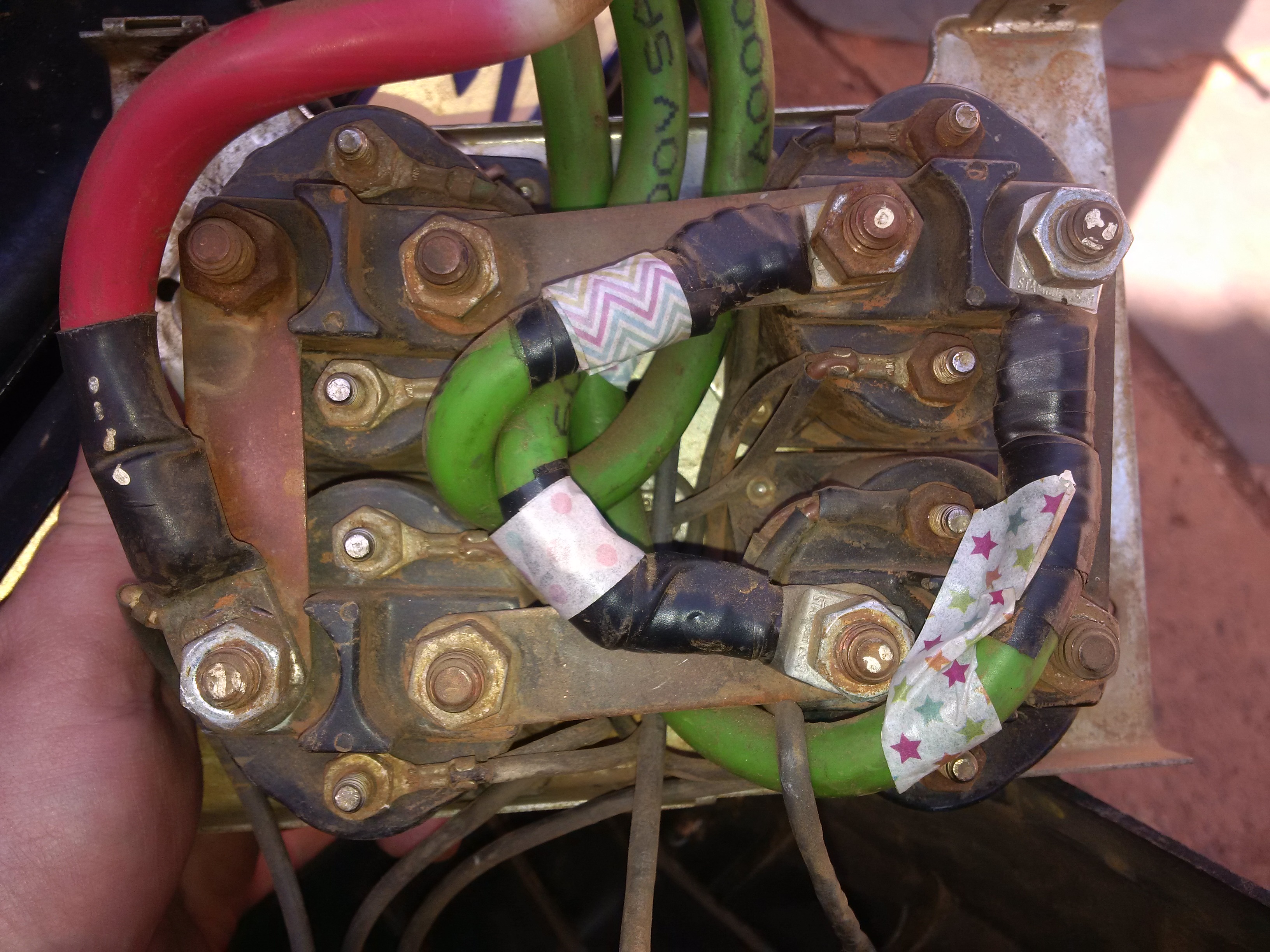

I removed the control box from the bull bar, and opened it up. Taped up the cables in the control box with somebody else's craft tape so that I could put it all back where it needed to be.

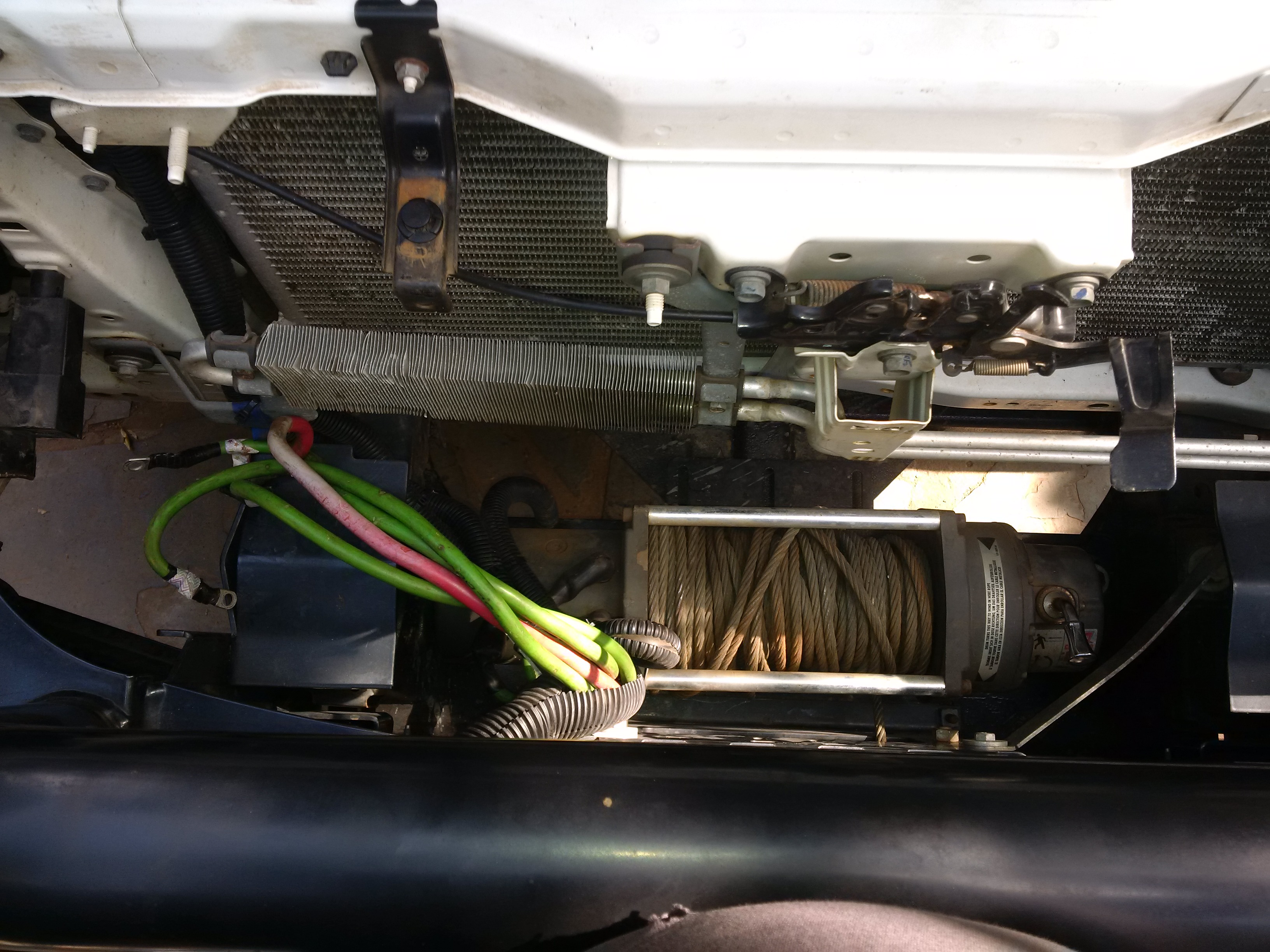

Top view of winch with no control box in the way.

To connect up the in cab controls we need a permanent ground (5 pin remote), a connection for live which goes through the safety switch first, and one for winding in and out, each.
Green/yellow = positive
Brown = winch in (I think)
Blue = winch out (I think)
Black = ground
Without getting new cables my choice of where to put the control box was limited, so I ended up tucking it inside the bullbar, below the drivers side headlight. I might move this at a later stage...

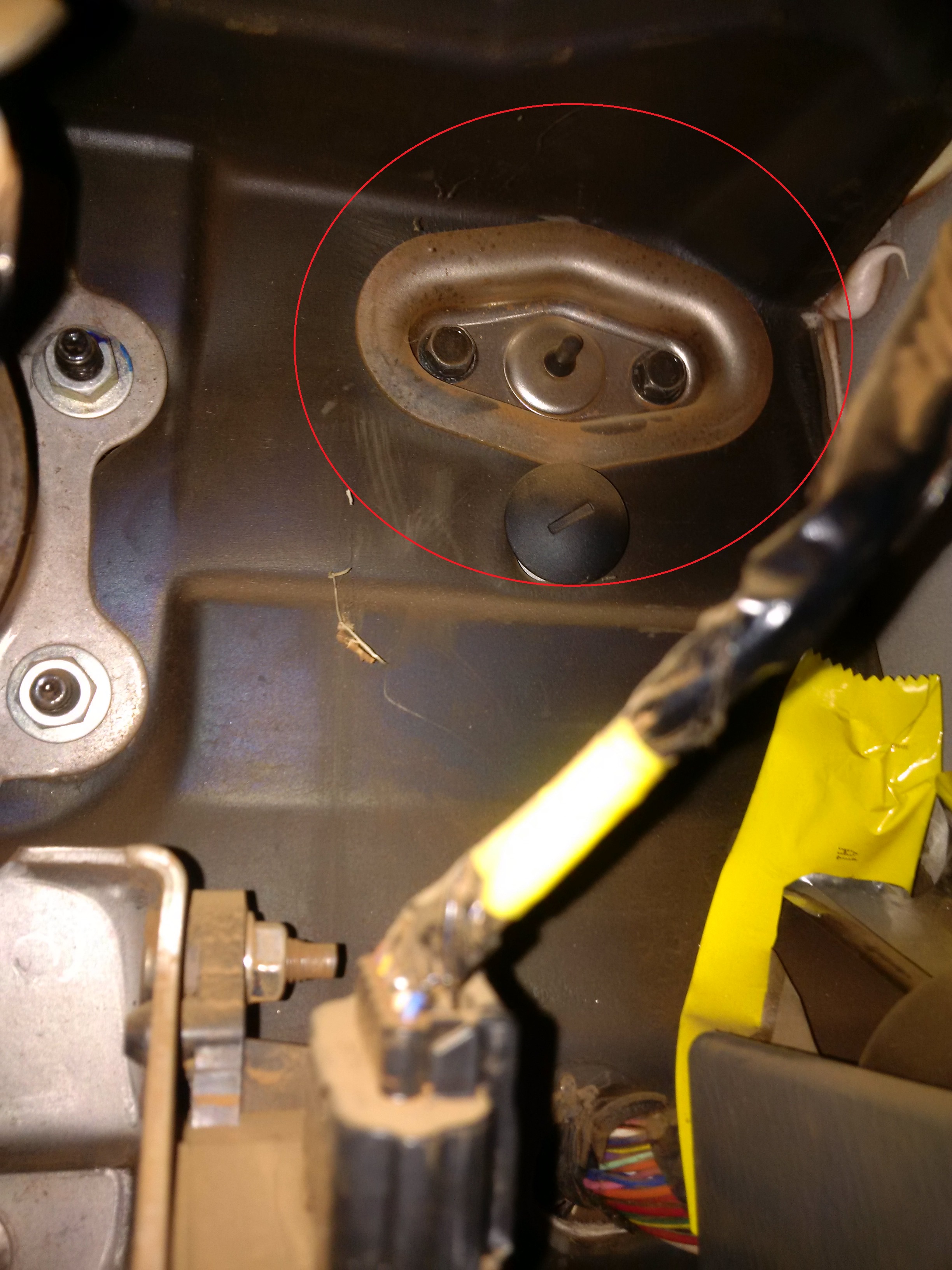

On the firewall above the pedals there is a handy plate which was apparently previously used for the throttle cable on non fly-by-wire vehicles (or so the Aussies say). This gave me a nice clean path to the engine bay. I took it out, drilled the hole a little bigger and fed my cable through there.
