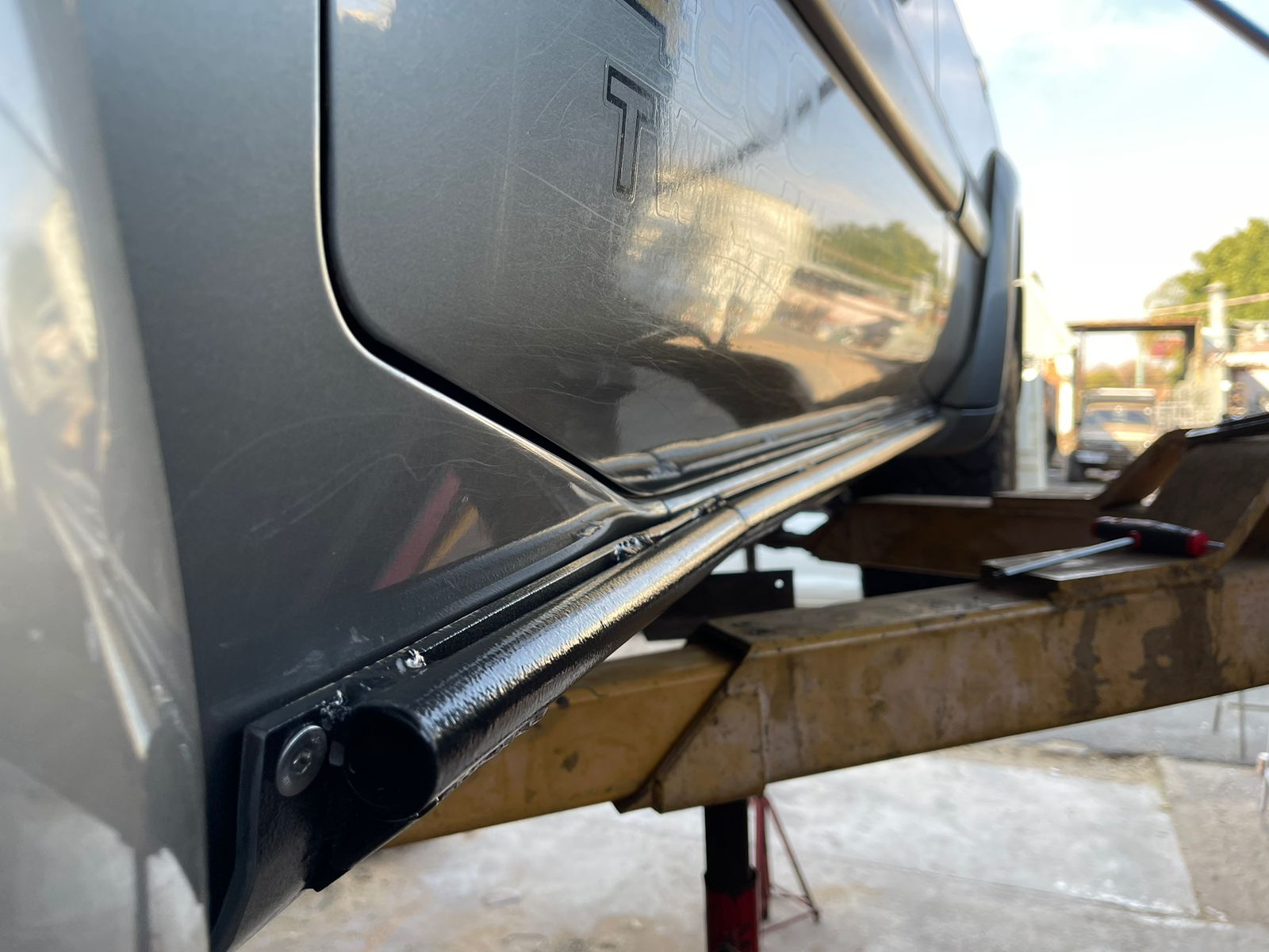

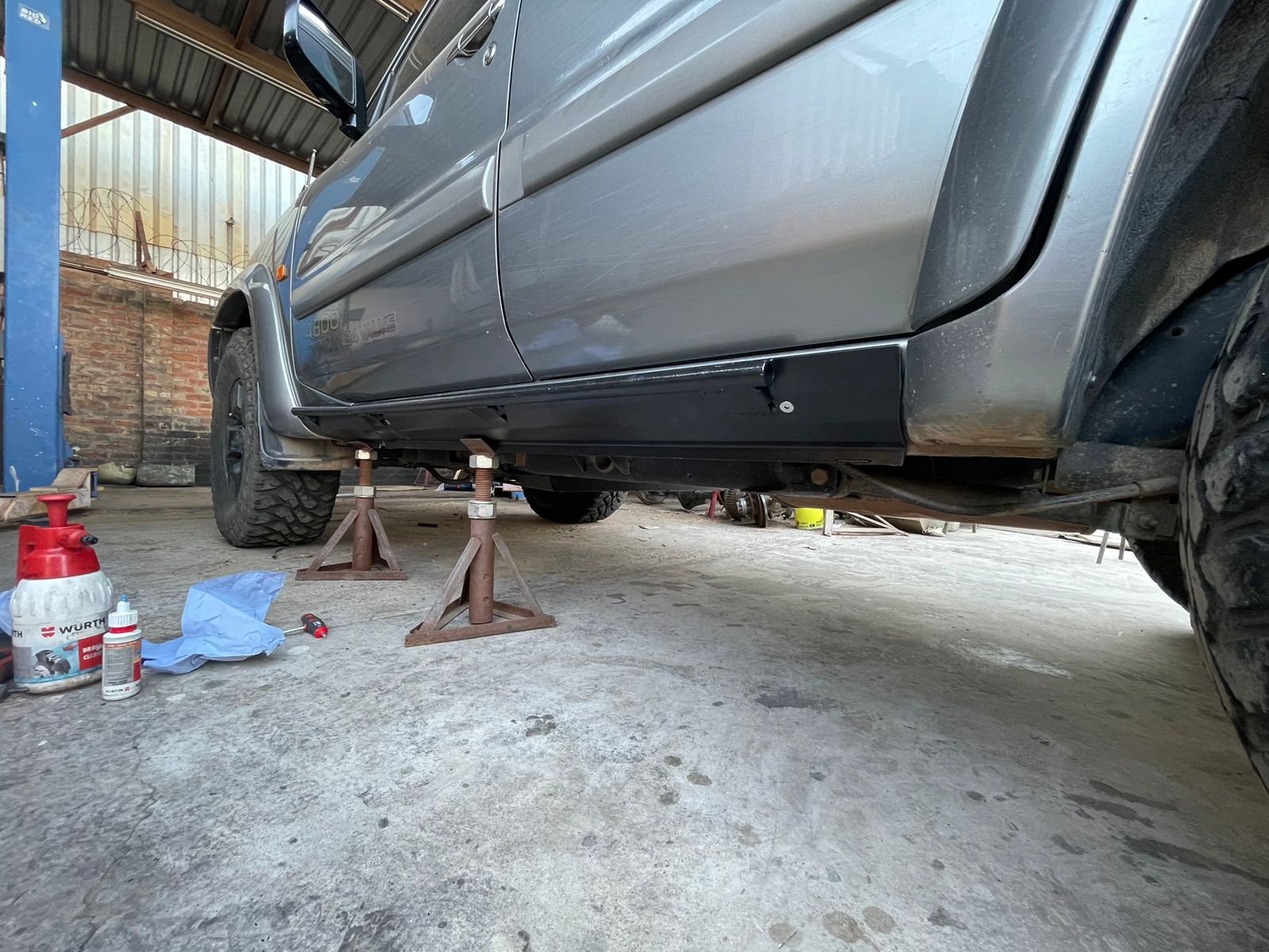

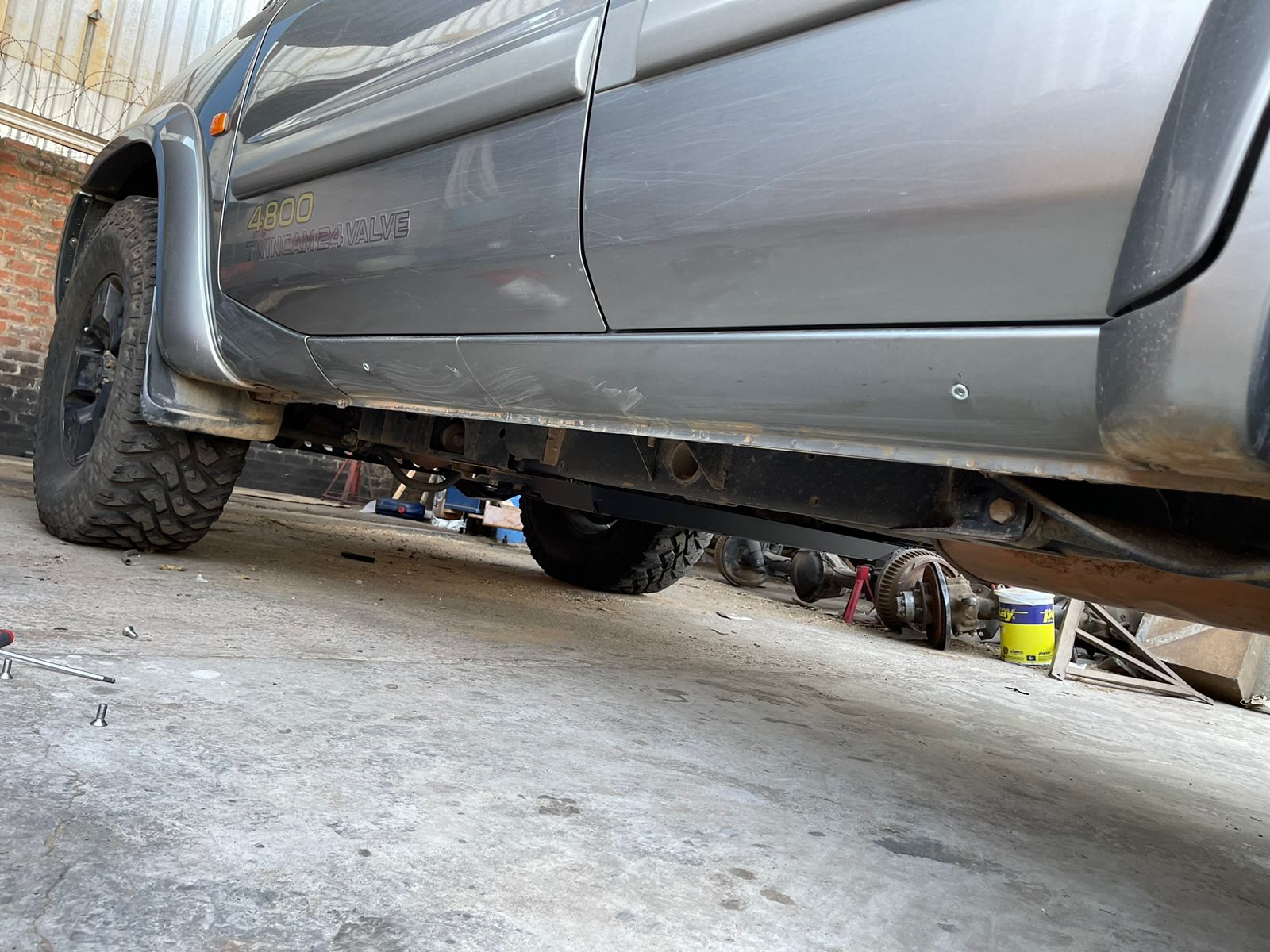

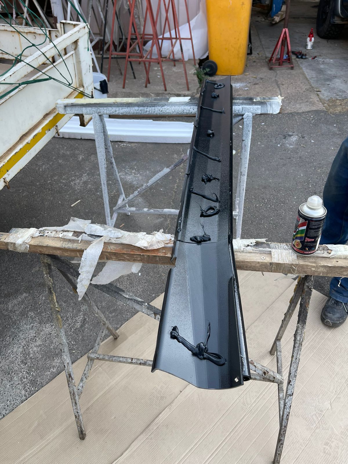

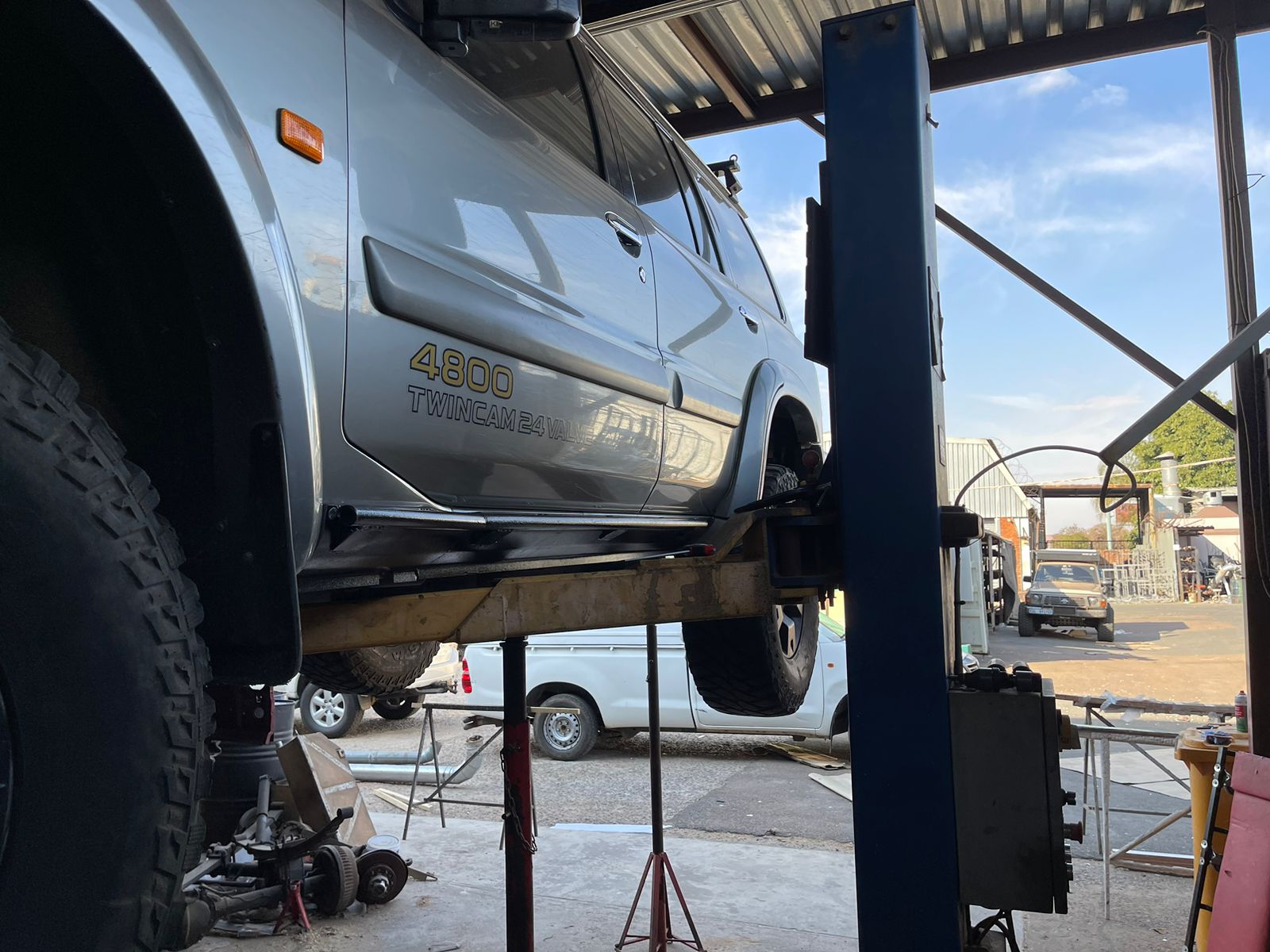

Do you have a pic of these rock sliders by now?
Posts: 6136
Has thanked: 1125 times
Been thanked: 1036 times
Re: Rock slider concept
As it happens, the first set was fitted just before the river trip. But on a Y61, not a Y60.
The owner decided to cut them a bit shorter in order not to have to trim the plastic arches, which is not what I would recommend.
