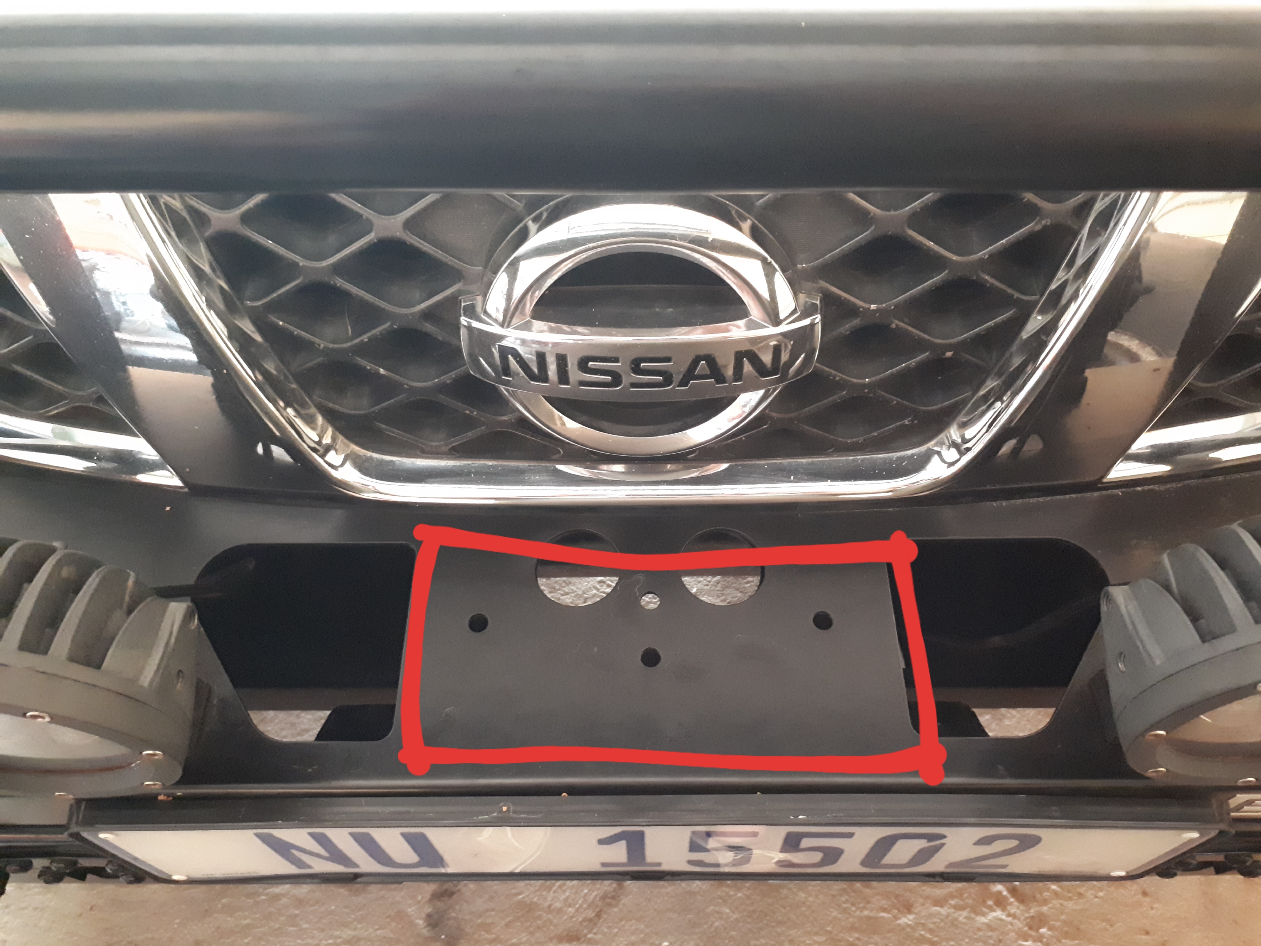

I was looking at my BZT bullbar again this morning. I am pretty sure one could cut a section out of the top panel and make a removable 'lid' for the area which would be large enough for batteries when the grill at the front is removed. Removing the grill is a 5 minute job - and a far sight easier than removing the bumper or even the winch plate....Craig Lord wrote: ↑09 Feb 2019 18:21 ...
I wish it was easier to put them in and take them out so that they didnt have to live in there constantly during the times I dont need them. I wonder if there is a way to make the winch tray independent of the rest of the barit would be ideal if you could unbolt it and drop it down without having to remove the whole bar.... not sure if that's even possible, I'm sure it would be something an engineering company would need to look at or maybe even the guys from BZT... but that's a whole nother issue.

That's a good observation Ian. Just went to check and I see what you mean about getting in through the top. Presumably if you made it so that the "lid" bolted back into place you would not loose too much strength. Just behind the number plate there is extra support built in for a winch so you cant cut it all the way to the front so I see what you mean about taking off the grill to make more room. Forgive my childlike attempt at illustrating the idea
Think it's best to go to an engineering works to work out the best plan. Will try put it on the list for when we come back to SA in April. As for the restrictions on airflow
I guess the only way to find out is to try it but as Peter mentioned one would think that it shouldnt be too much different than if you have a 12000 pound winch in the same space

Checked it this morning, and that was my idea....
Biggest issue for me, would be airflow. Volume-wise, in terms of the space a winch occupies, the winch will be considerably larger than the average battery. But it will let a lot more air through than the battery will.
But I guess nobody knows if someone does not try it....

Haha I'm happy to be the guinea pig I guess. I will look into what it would mean to cut a section out of the top because it would be awesome to be able to take them out with minimal fuss. If that's not going to work then I suppose the bar will just have to come off to do the job and they would be more permanent.
Also need to find out size battery would be best, One large one or 2 smaller ones. I was thinking that something between 100ah and 120ah would be suitable. Will also need to consider airflow like you say. Maybe 2 smaller separate batteries would be better for this...
Ok well i guess that's semantics. First il try sort out the bar.
