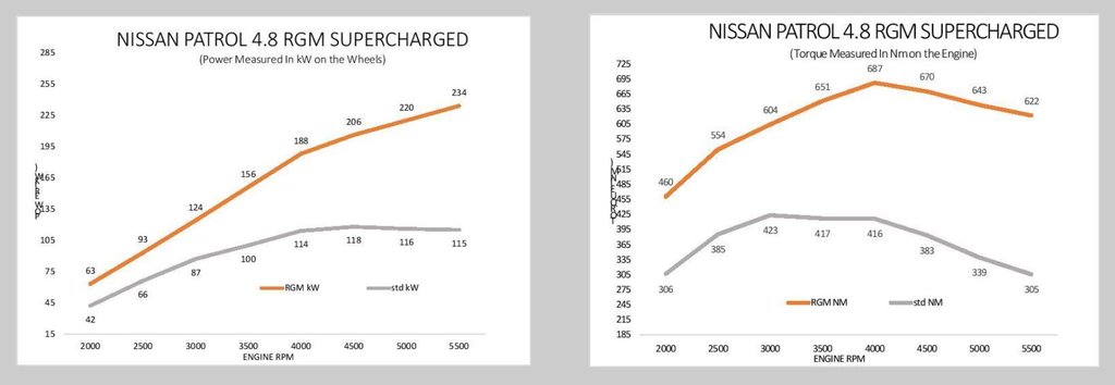

Thanks Peter - I agree with your and Tinus' point on the difficulty with getting torque gains low down in the rev range simply by improving the air characteristics.
It appears from my research (I have a lot time on my hands
) that the supercharger option version is the most effective from obtaining torque evenly through the rev range. I have attached a dyno stat from one of the companies that apparently was from a real life car they did. +-R125k quote to do that. (I'm sure it can be done for about 80k but I don't have the data to back this assumption up.)
Given the varying views on what could be done and the gains achievable/not I'll try and measure the modifications as objectively and independently as possible so that, if nothing else, the next guy that wants to do this will have yet another data point to work from.

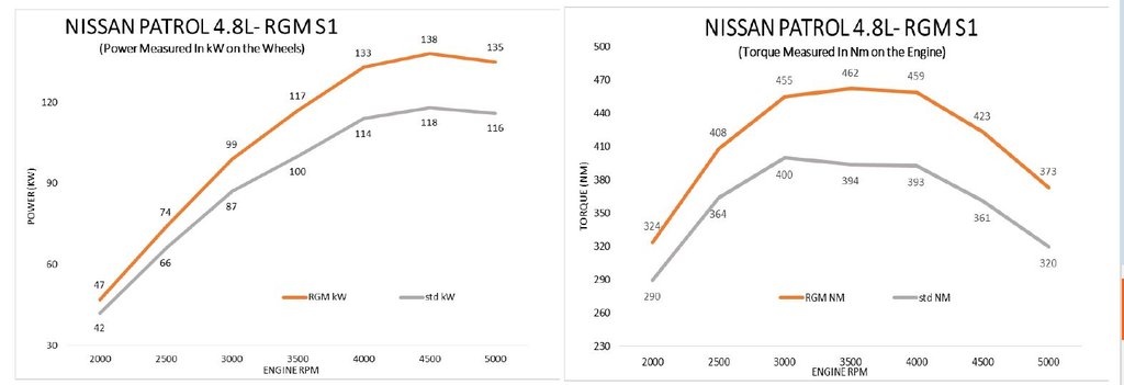

And these are the actual results from: free flow exhaust (no branches); Unichip; K&N air filter,
