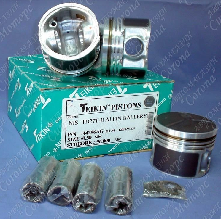

Cedric have a look at the T after the td27t those have the keystone rings and the inserts . The top piston is the real one that has the more holes ect for oil irrigation and comes in the td42t truck and bakkie motors. I have a set of those turbo td27t in my motor and they work

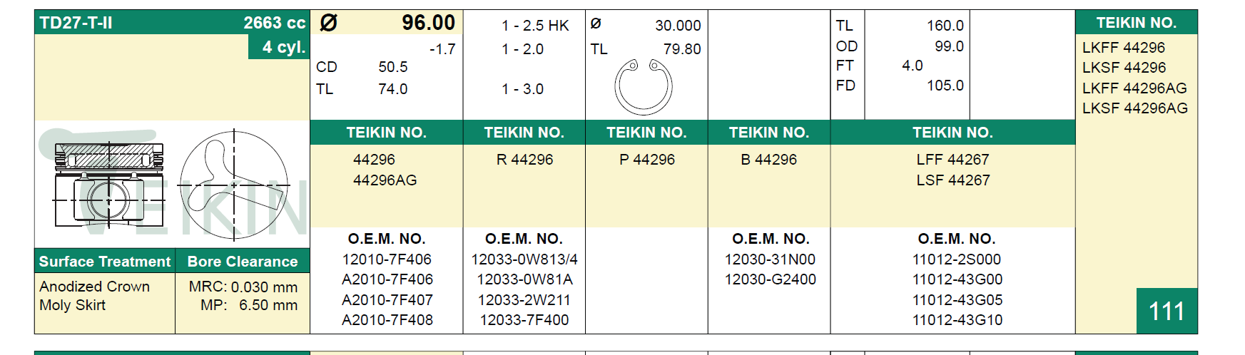

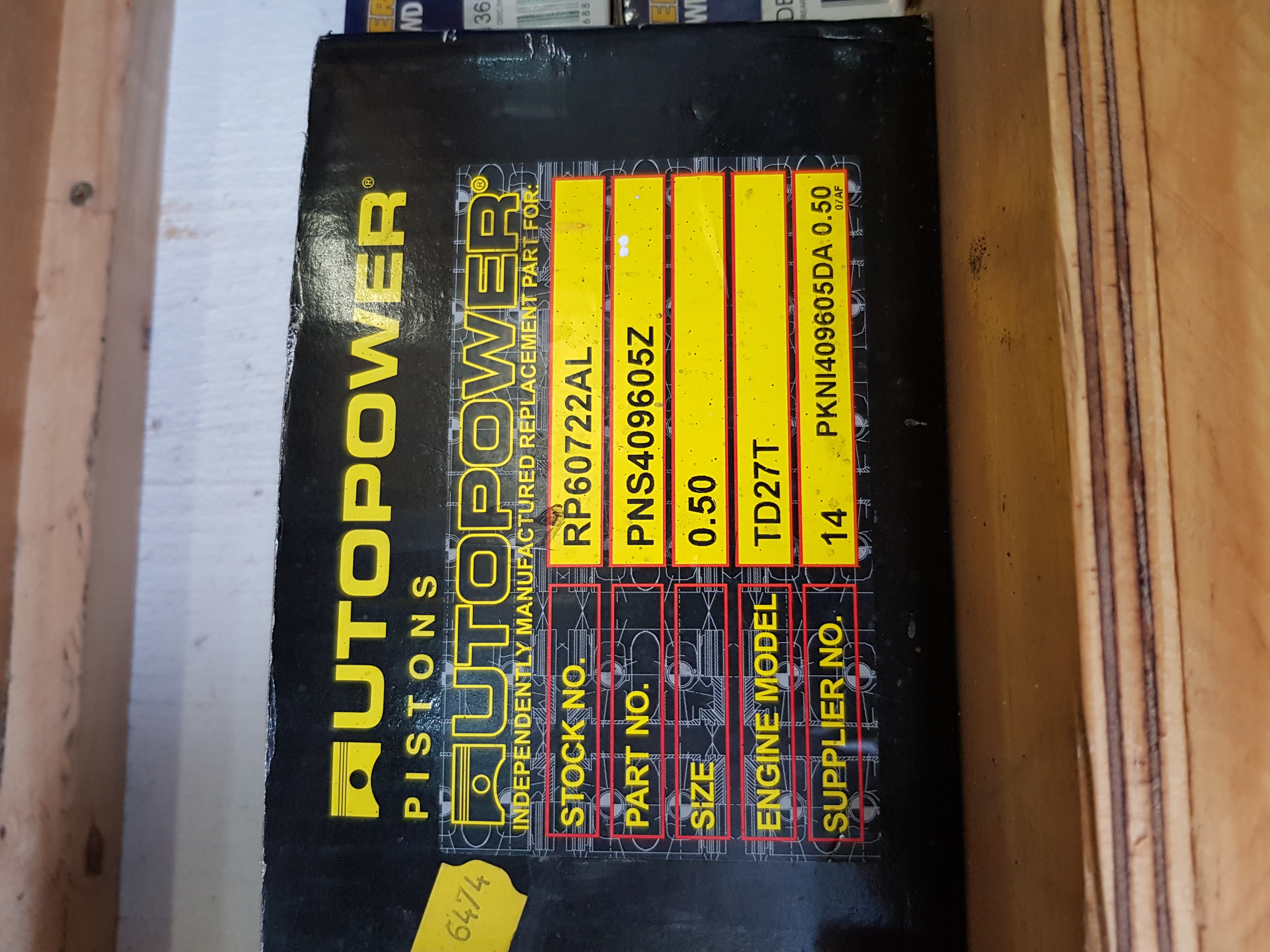

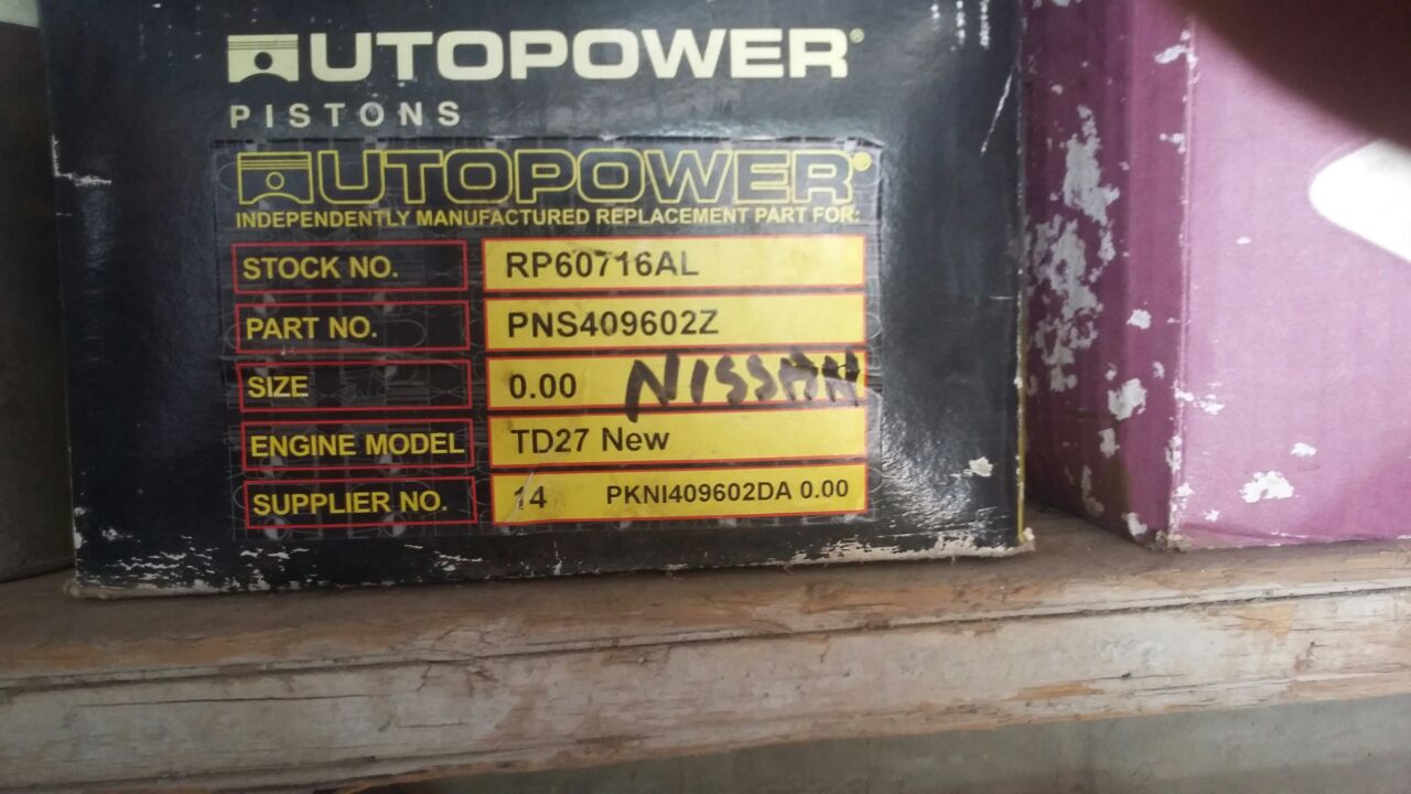

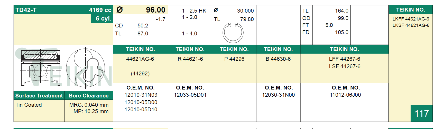

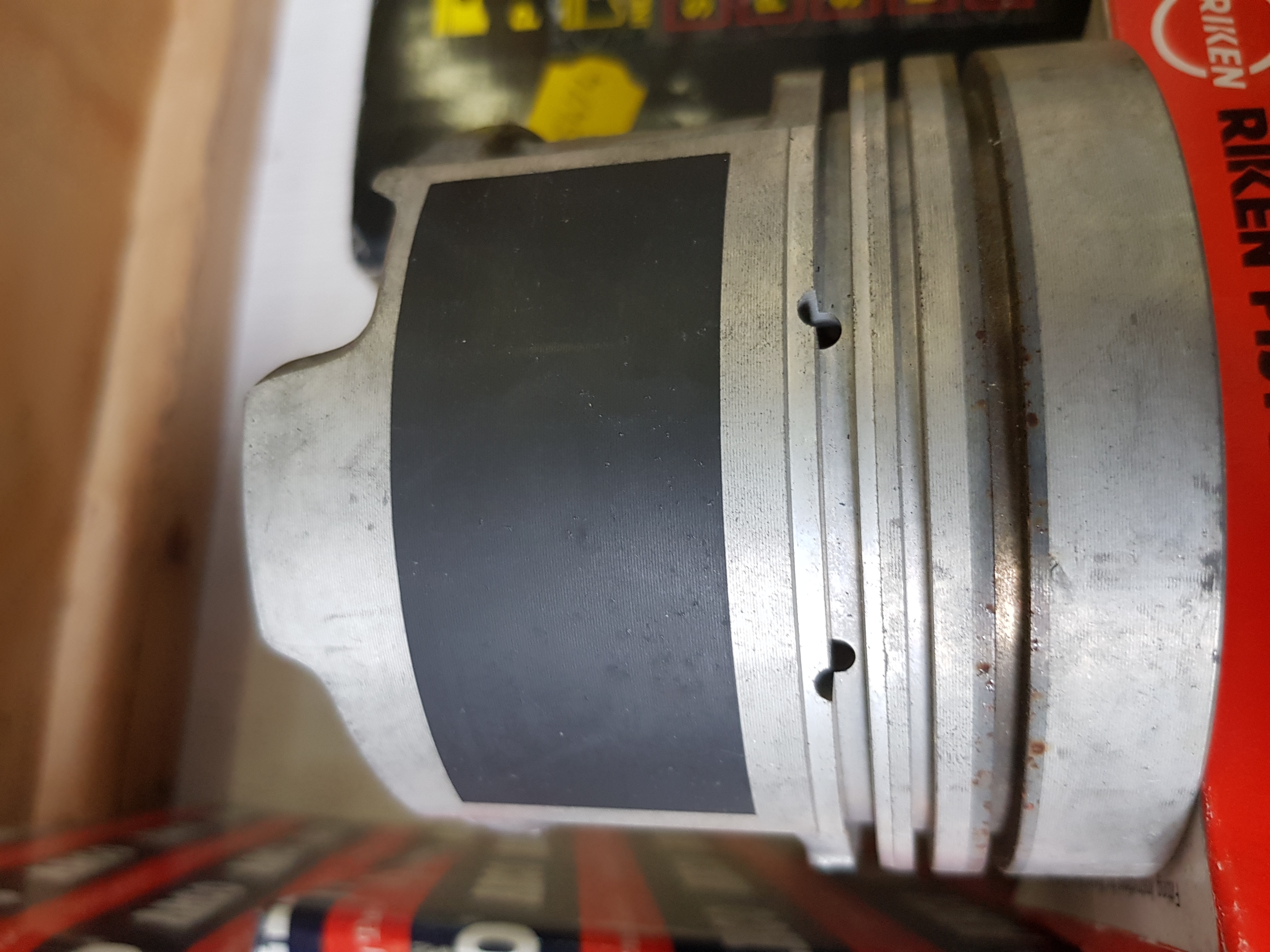

I found a set of pistons that have caught my interest for a td27t, they are shorter than the normal td27 and td42
better lighter or not, at least they both have the cooling gallery?
TD27t not sure about the shorter skirt and pattern on the top, but they are anodized on top
td42 the skirts are considerably longer and the design on top is different
any comments from the experts??
