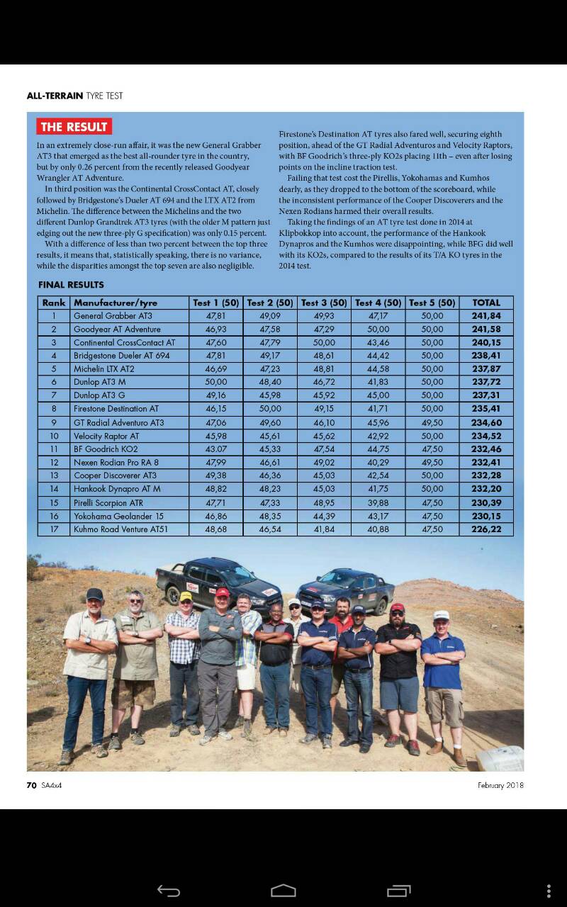

All terrain Tyre Test
Been thanked: 430 times
Re: All terrain Tyre Test
Ha ha those tests really does not make or brake a tyre. If you dont have 3ply tyres when overlanding you are going to take a bigger chance of getting home safe than with 2ply tyres that can brake a little bit better.
A 2ply tyre will also never in its life be able to carry the weight of a 3ply so yes....... safety safety safety :lol:
Sien hulle het cooper at3's getoets en nie st maxx's nie - sal dink dat n 4x4 tydskrif eerder st maxx sou toets? :think:
Grant wrote: 31 Jan 2018 17:45Getting to Bots or Moz you need to drive + 500 km on tar, and this is also were you need a tyre that can stop the load vehicle. With all our lifts and extras the tyre plays a more important role. Safety Safety Safety
I would be very scared to hit a pothole with a loaded vehicle with some of those tyres on the top half of the list...
Hierdie toetse is regtig onrelevant, om dit meer realisties te maak moet hulle dieselfde toetse op die bande doen na elke 10k km en sien wat dan die resultate is...Die meeste bande gaan goed perform wanneer hulle splinternuut is..

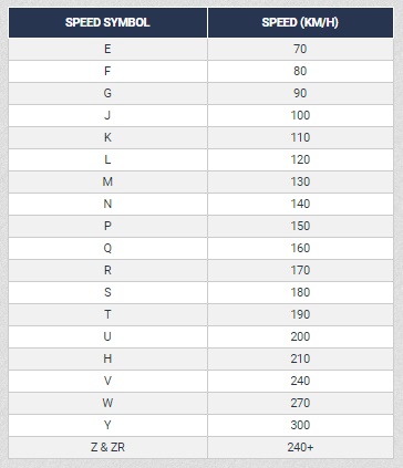

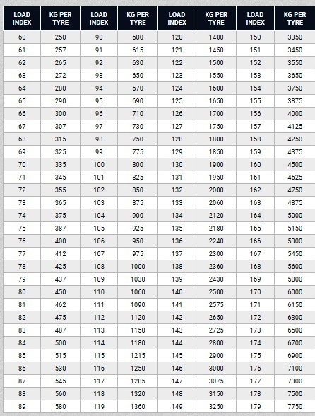

From errols tyres:
grabber at3: 265/70 R16 112H FR (not available in bigger size :redface: ) - R1938
at adventure: 265/75 R16 LT 112/109Q WRL - R2274
cross contact: 235/85 R16 C 120/116S COMMERCIAL - R2007. biggest size available (in 16"), not LT rated. not meant for real 4x4's..
bridgstone: ???
michelin: 265/75 R16 123/120R LT COMMERCIAL - R3363
dunlop at3: 265/75 R16 112/109S 6PR MFS COMMERCIAL - R2305
firestone: ???
gt radial: 265/70 R16 111T (biggest 16" size available) - R1639, not LT.
bfg: 265/75 R16 119/116R LT LRD RWL GO COMMERCIAL - R3608
velocity raptor: ??
nexen: ??
cooper at3: 265/75 R16 112/109R LT COMMERCIAL - R3500. (also a non LT version available for R3056)
hankook: 265/75 R16 120R 10PLY - R3492, (not LT?)
pirelli: 265/70 R16 112T - R2295, 275/70 R16 114T - R3098. (nothing bigger than 31" available :redface:, not LT? )
yokohama: 265/75 R16 123R LT COMMERCIAL OWL - R2616
kumho: 265/75 R16 114T - R2280 not LT...
Tinus lotz wrote: 30 Jan 2018 18:12 Biggest load of bul i ever read .....but if it makes you happy to drive arround with soft sidewalls and get stuck with every piece of stone and wood penetrating your tyre belief it and buy them ....4x4 tyres are not about breaking distances ...its about what lasts and what is going to let you down half way in Bots or Namibia ....cooper bf and goodyear mtr geotrac et c. Are built for a reason ......they are strong and gets you home . Alex has a pic of Ossewa on baboons pass ...it speaks a thousand words
JA JA Jy weet mos alles. Getting to Bots or Moz you need to drive + 500 km on tar, and this is also were you need a tyre that can stop the load vehicle. With all our lifts and extras the tyre plays a more important role. Safety Safety Safety
The little bit of safety that they say you gain on a tar road is negated thousands of times over the second you go offroad. Why do most of us own Patrol's?
Afraid in my opinion that test is not worth the paper it is written on. The Kumho's I used to have on came last yet I rate them the best all round tyre I have ever owned. Only thing I could ever fault them on is their performance in Transkei mud/clay and I know a lot of MT's that don't do well there.
