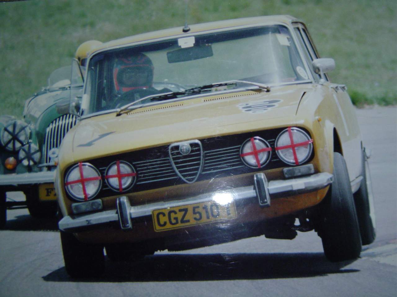

I used to race motor cars (classic Alfas) and won the championship 3 years running for classic marque cars (pre 1975 street legal cars) in a 1969 1750 Berlina. In all those years of racing, I learnt a lot about cooling. I managed the cooling so well that I ran my Berlina with a standard radiator without a fan because I understood the dynamics of cooling of a vehicle's engine and also because a fan robs an engine of power. This included sometimes standing idling and even revving on the grid for sometimes as long as 5 minutes.... (see a picture of this car at Zwartkops at the bottom of this post)
One important factor is to block off as much airflow from getting into the engine bay without it first going through a cooling device such as a radiator and/or an intercooler. That is my reasoning. Chris from Cirrus also advised me to close the intake off or block it, as his experience taught him the same principal.
Many years ago, Basil Green fitted a Mustang V8 engine into the Ford Granada Ghia and called it a Ford Granada V8 Perana. Ford USA's head honcho was so impressed, he wanted to acquired one for himself, but Basil Green refused to sell him one at that stage.
The problem was that the V8 Granada overheated and no matter how big a radiator and how many electric fans they fitted, they could not solve the problem. In fact, the fans made it overheat even sooner!!
After many months they eventually found the problem, and a simple deflection plate above the radiator solved the problem. Air takes the route of least resistance, that is an undisputed fact. So what does that have to do with the problem you may ask?
There was quite a gap (for various structural reasons) between the top of radiator and the bonnet. It let more air into the engine bay over the radiator than went through the radiator to cool the engine. In fact, the fan sucking air only resulted in more air going over the radiator rather than through it.
Basil Green fitted a plate to the front bulkhead, just above the grille, behind where the bonnet clip is situated , blocking the air route over the radiator into the engine bay. This solved the problem and led to the Ford Executive eventually receiving his long awaited Granada Perana V8 in North America!!
So, too much air, going into the engine bay via the wrong routes, can and probably will cause problems, more so on a turbocharged vehicle where the under bonnet temperature needs to be correctly managed. With the scoop directing cold air through the intercooler, this helped keep the temperature down. I would rather err on the side of caution after Chris from Cirrus confirmed what I suspected.
Notice the number "1" on the right front of the bonnet in the picture below. The number "1" indicates the current champion, for those who do not know.
