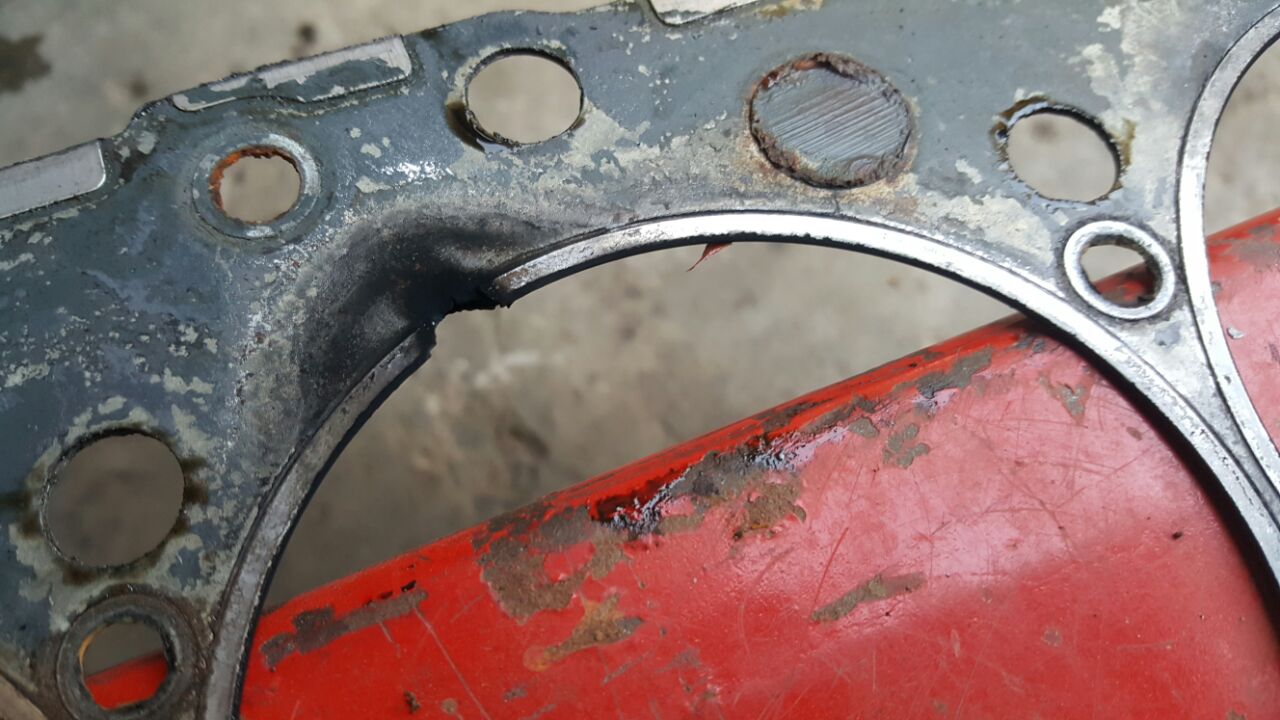

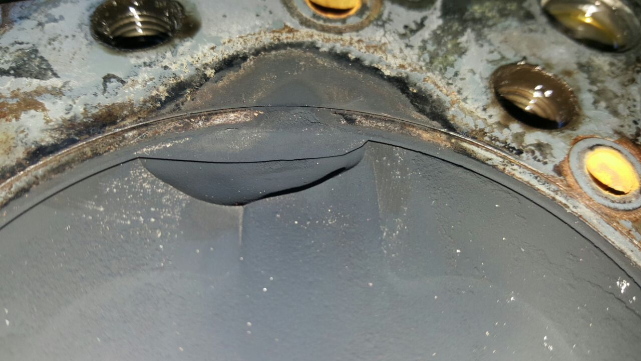

Oom Mac, glad your Patrol is running like it should againKagiso II wrote:Nouja .. Vanaand vir iNyathi by Michael gaan haal.
Hy loop soos stroop ..Ek sal terugvoer gee wanner ik trug is uit Botswana .. oor 3 weke
Michael .. jy kan gerus bikki hier uitlê wat jy alles moes doen om 'n anner (vent) se gebrou ongedaan te maak ...
oompie darem ook net se BAIE DANKIE Michael dat jy tot middernag ure ingesit het om iNyathi aan't loop te kry.
Hy ry soos n NUWE Patrol![]()
Just some history on what happened to his Patrol engine after the head was replaced by another company a while back.
A pirate head was purchased as a result of Nissans MAD prices on cylinder heads and what I can only call a combenation of under tightening of head bolts and not as food quality heads as the OEM had the following impact on the engine.
Four combustion chambers came loose and two was so loose they fell out as the head was lifted up. The gaskit was blown exactly where the two very loose ones were and a heat spot was created because the combustion gas could now leak between the head and the combustion chamber.
As a result the two pistons melted on the corners where the combustion chamber sits.
The injectors was also installed without injector cooling tips and this caused the tips to over heat badly and all had to be replaced.
- IMG-20170804-WA0009.jpg (122.95 KiB) Viewed 12043 times
