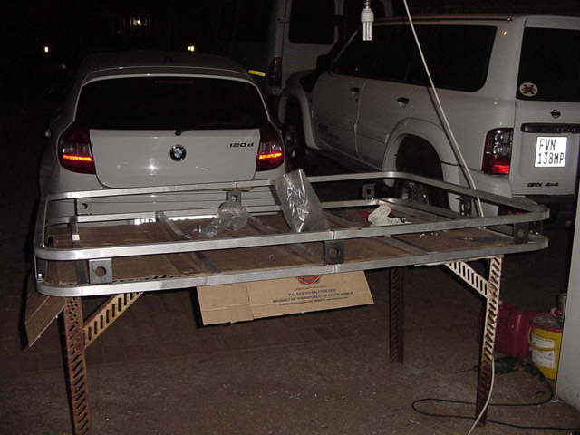

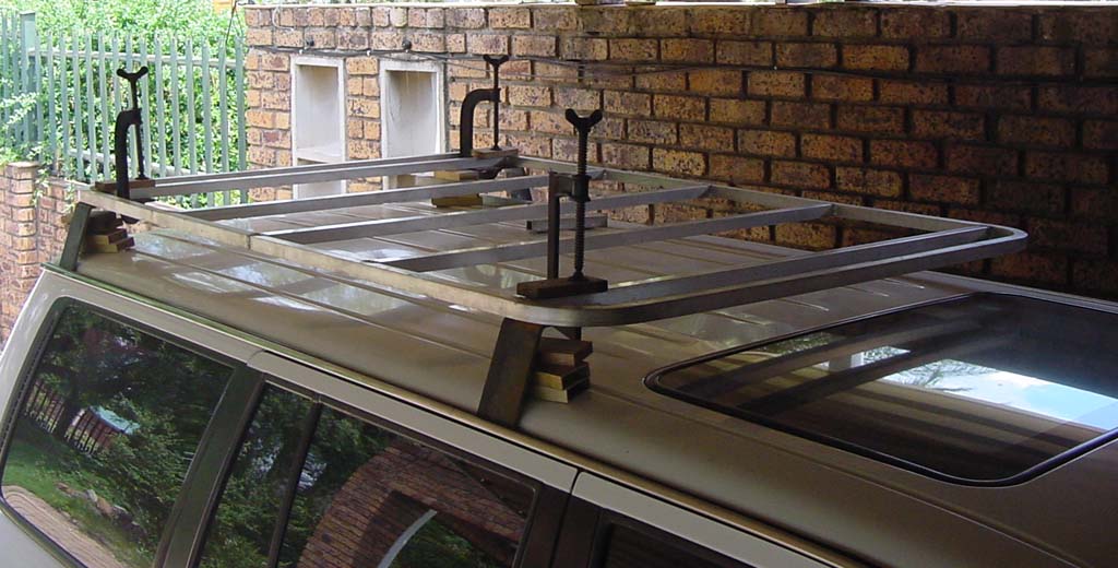

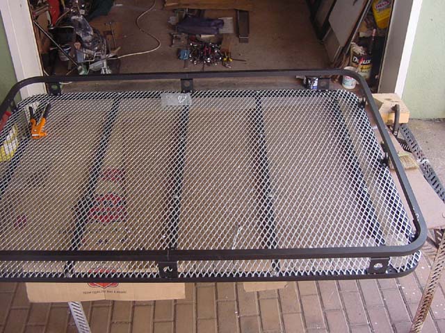

I built my roofrack out of 25 x 25 x 3 aluminium tubing. Bending was done by AM Tubebending (in Bredell) and they also do welding but my welding was done by my Nephew
Ek het die fout gemaak en die ding gaan staan en verf met 'n verkeerde onderlaag.

Carel wrote:I built my roofrack out of 25 x 25 x 3 aluminium tubing. Bending was done by AM Tubebending (in Bredell) and they also do welding but my welding was done by my Nephew
This design is so simple yet so effective...... Well done..... Is the mesh aluminium as well?

David, it is galvinised mesh that I used.
Michael, on our trip to Angola I had 4 jerry cans full of petrol and 50l of water plus spares especially driving towards and through the "Doodsakker". So that was close to 200kg on the roof.
The feet (6 off) are made out of 6 x 75mm mild steel bolted to the aluminium frame with 2 x m8 bolts each

Carel wrote:David, it is galvinised mesh that I used.
Does anyone know if aluminium mesh is available??????
