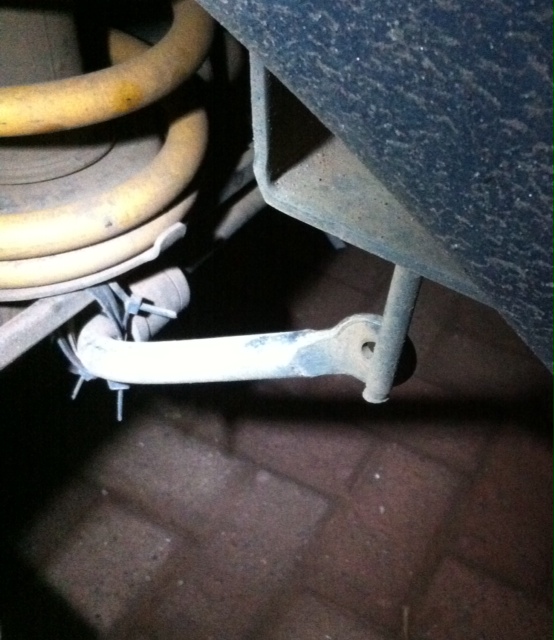

My rear one came loose, and boy o boy it was not good............

Dirkoffroadbiker wrote:My rear one came loose, and boy o boy it was not good............
In your case, it looks like the rod and bar is still in tact.
For the rear, if I were you. I would just have the rods made longer.
I think the lift puts it under too much strain in standard form.

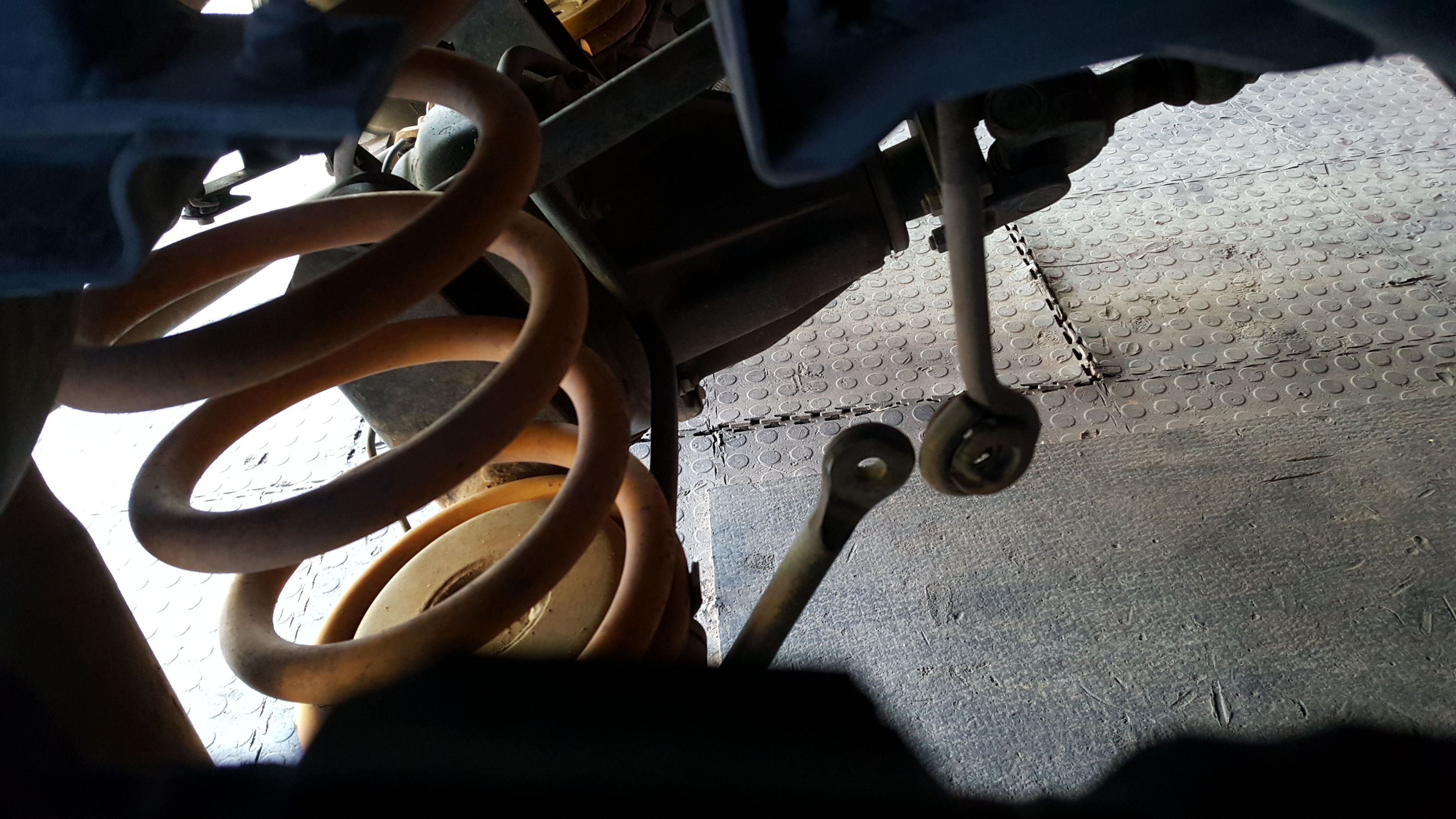

Re: Front anti-sway bar QD's
Dis hoe/waar myne gebreek het.
Het ander kant se raam los gemaak en sway bar met cable ties vas gemaak om ratles te elimineer...
Yep, luckily did not brake/snapped, just came undone, but the handling was bad, could not go past 95km/h so I would definitely never consider removing mine.Alex Roux wrote:Dirkoffroadbiker wrote:My rear one came loose, and boy o boy it was not good............
