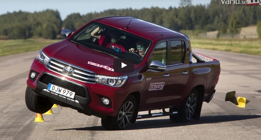

Would like to see how a lifted, no sway bars ect Patrol does on this test compared to a standard Patrol. would be interesting...Tinus lotz wrote:Me thinks a new unlifted patrol will be fine ....us with lift kits roofracks ect ...no anti sway bars....we need to put more lights to see them first....
But if you look at he pic of the Hilux, I recon a Patrol would still have all four wheels on the ground....

Going slightly back on topic, the moose test is more about swerving to avoid the "moose" (kudu). ABS or no ABS, on sand or on tar, there is a point in which the car will dig one of its front wheels in to the surface with enough traction and with the forward momentum of the vehicle, flip it over. The higher the vehicle, to more likely the car will flip over. The narrower the wheel base in relation to the vehicle the easier it will flip over. That's why formula one cars can swerve and corner at 150Km/h, where as our Patrols for example could probably do the same corner at 50km/h before flipping over.
Center of gravity is the key point, as well as tyre wall height. The amount of flex in our 31" or even 33" tyres (75 profile ) is massive compared to the BMW I had with 45 profile tyres. If you watch all the youtube videos carefully, watch the deformation of the front tyres. The one front tyre will be absorbing tremendous pressures where as the opposite, or for that matter both rear wheels will have either minimal pressure or be completely up in the air.

"But if you look at he pic of the Hilux, I recon a Patrol would still have all four wheels on the ground....
Highly unlikely bud.... without sway bars it will be even worse !!!!..... like in EPIC FAIL !! Sway bars are there for just that reason to try keep the vehicle level. If one wheel is up and the other one down, the up is going to push down and the down one will be pushing up trying to get the balance.
