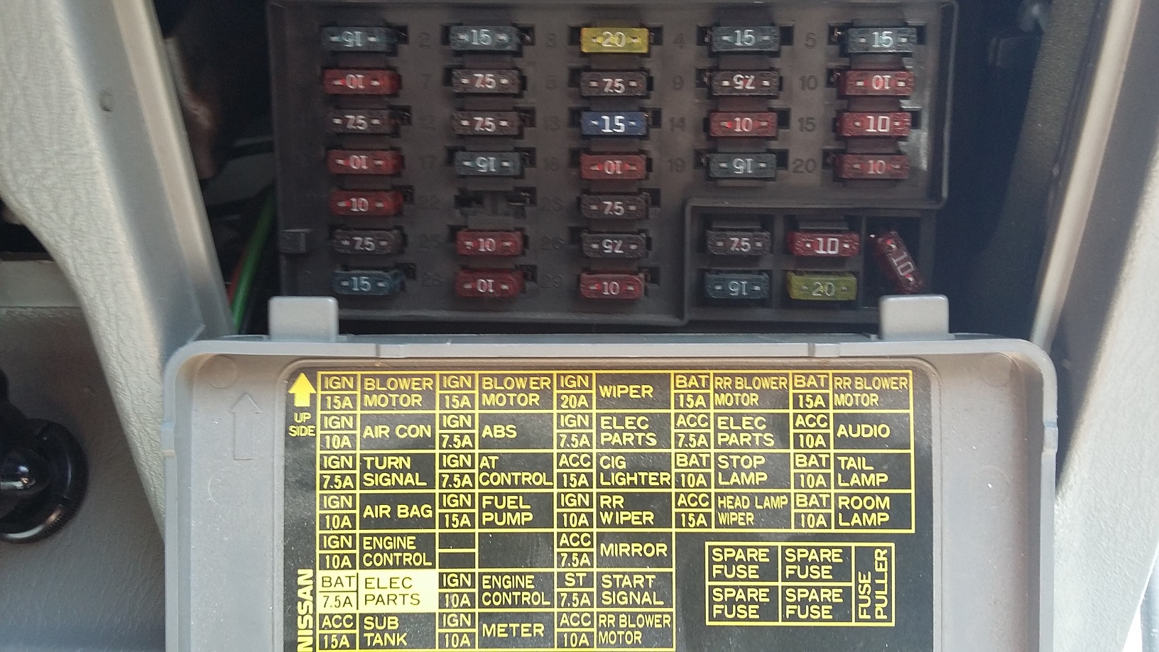

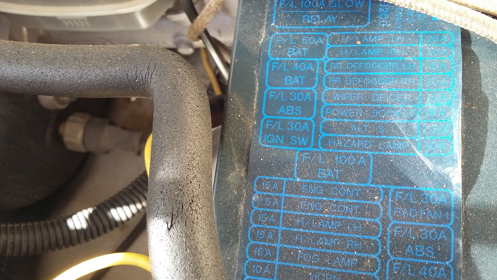

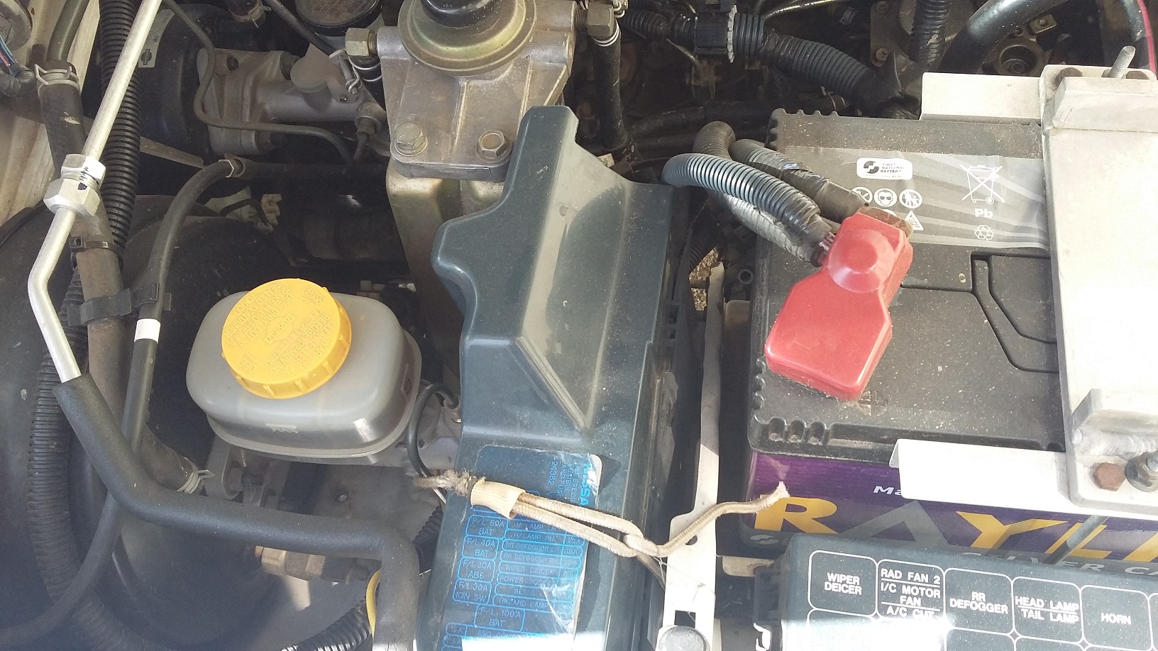

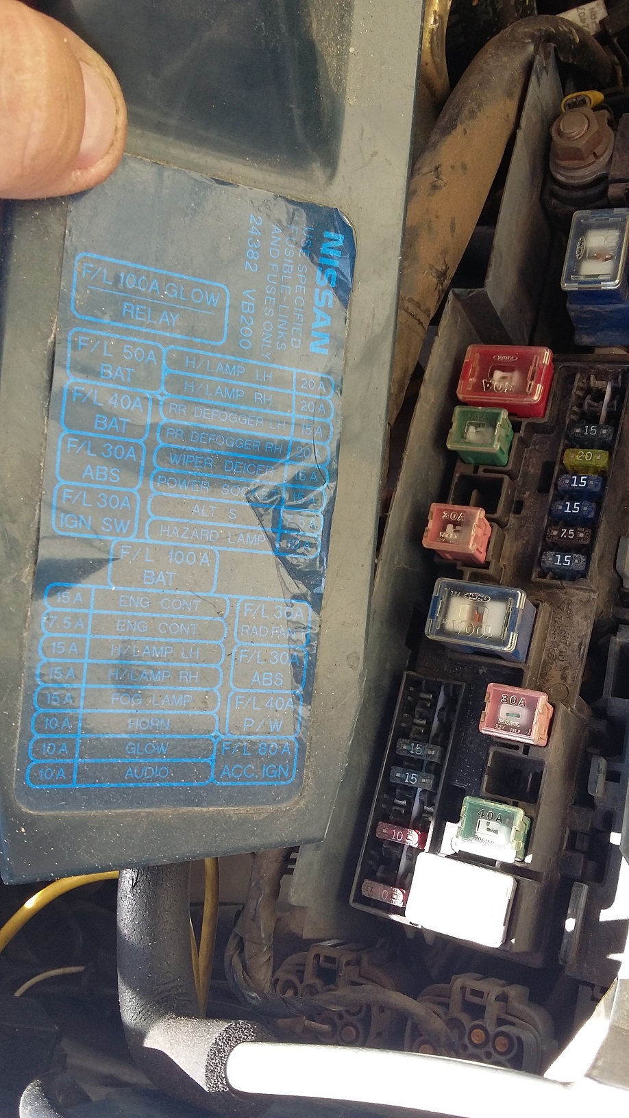

My 1998 4.2D GL has the ABS fuse under the dash, but both 30A fuses in the engine bay are not there.
Also, there is no ABS "unit" visible in the engine bay.

The easiest way of determining whether you have ABS or not is look for the modulator valve. It is a box sitting in the engine bay against the firewall on the passenger side (I think all of them are in the same position) which has metal tubes running in and out (I think 6) and some then run across the firewall.

Dustin, the ABS unit sits on the left hand side of the engine bay where the vacum serervoirs are.
Also check if you have speed sensors going to each wheel.
Most GL's came without ABS........ I think I have one of the very few that has ABS
