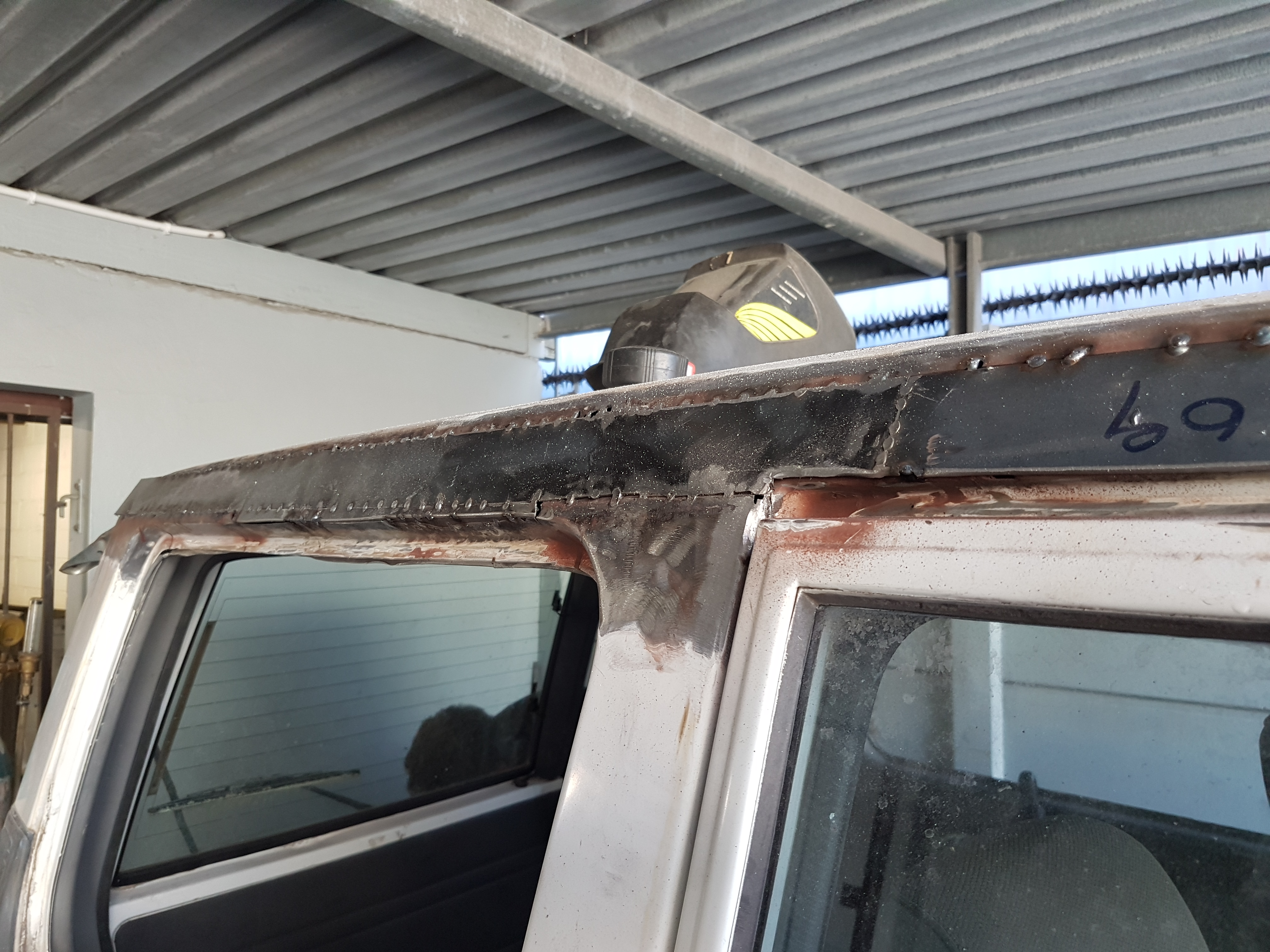

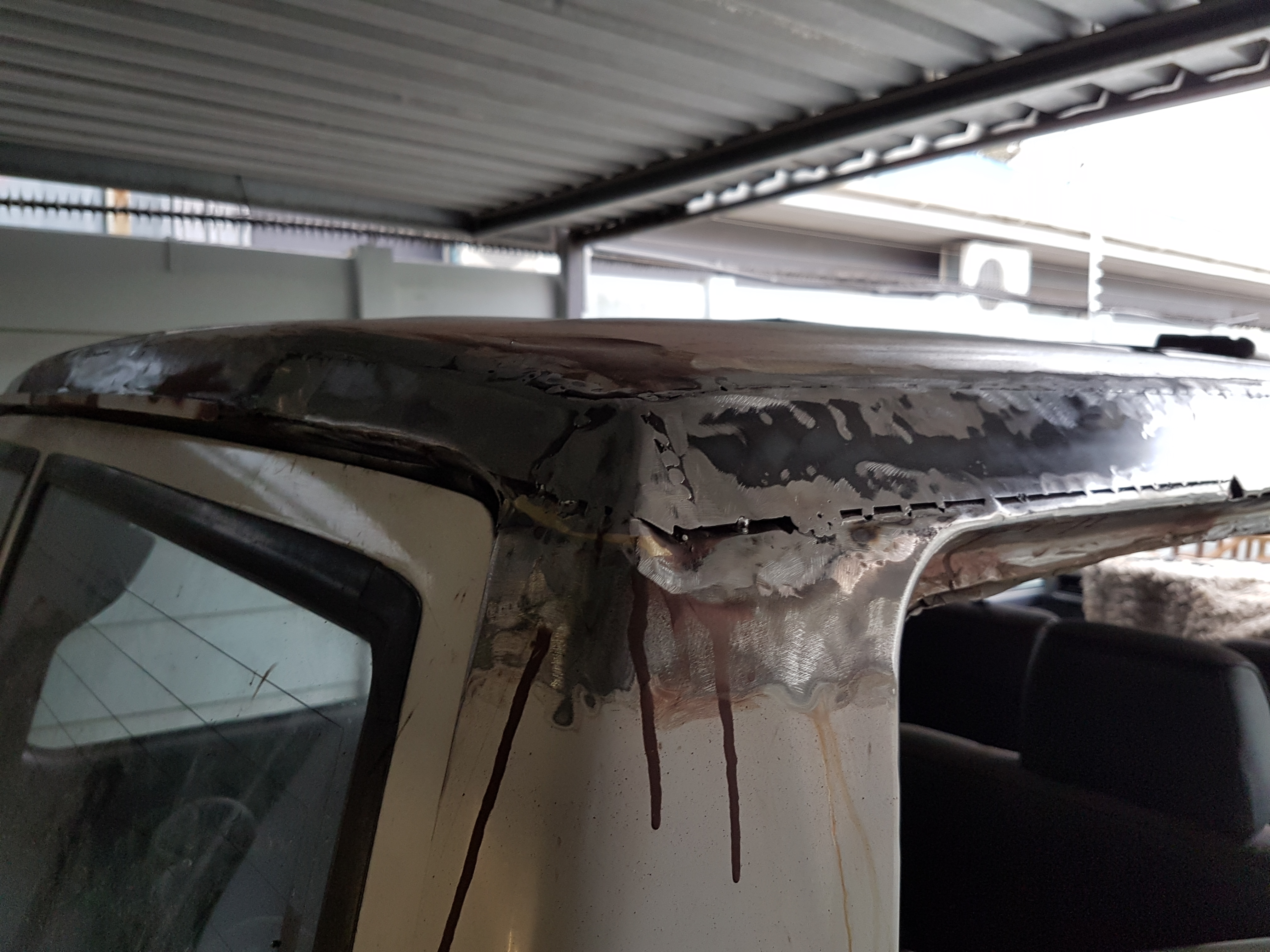

Morning

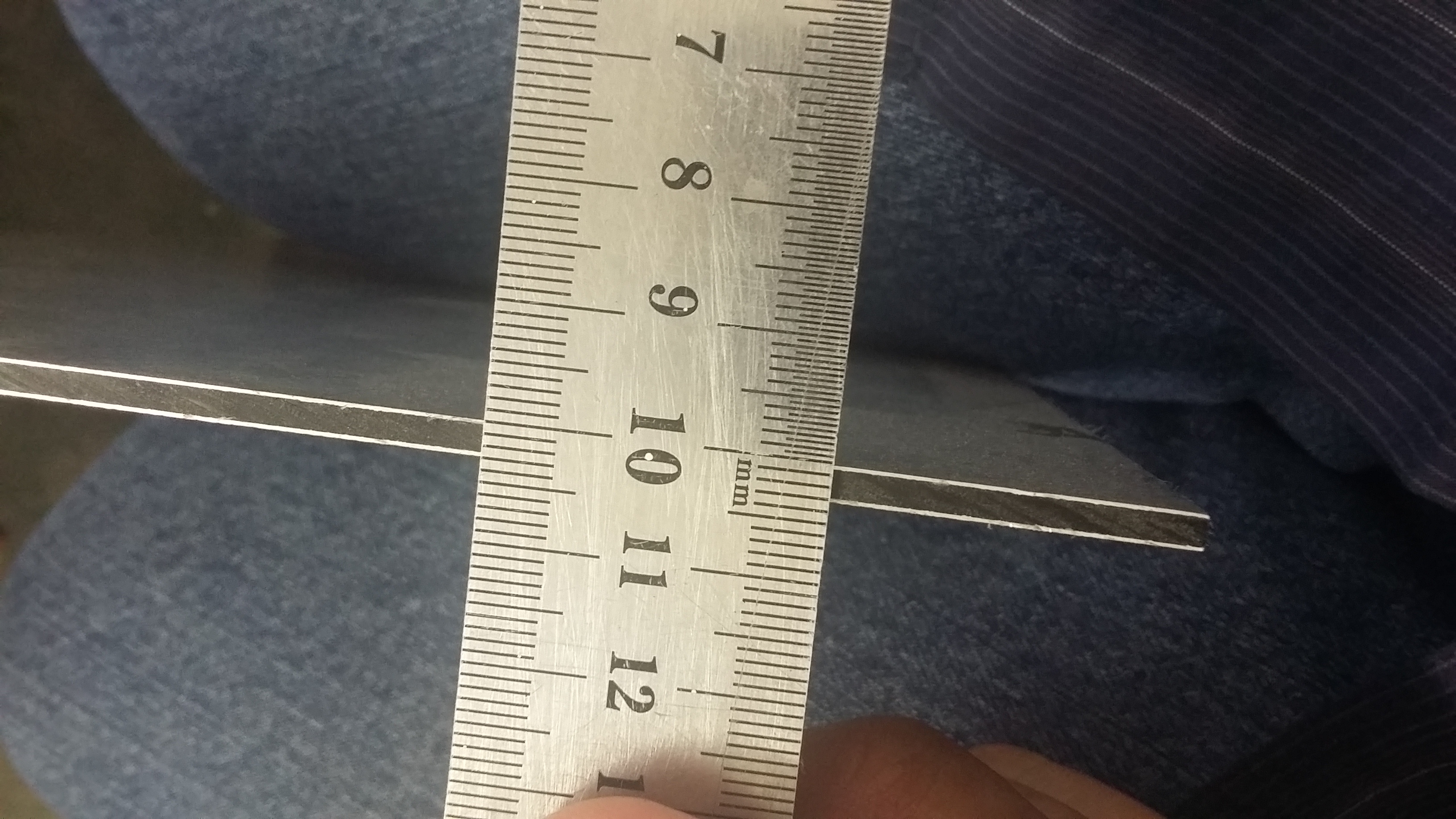

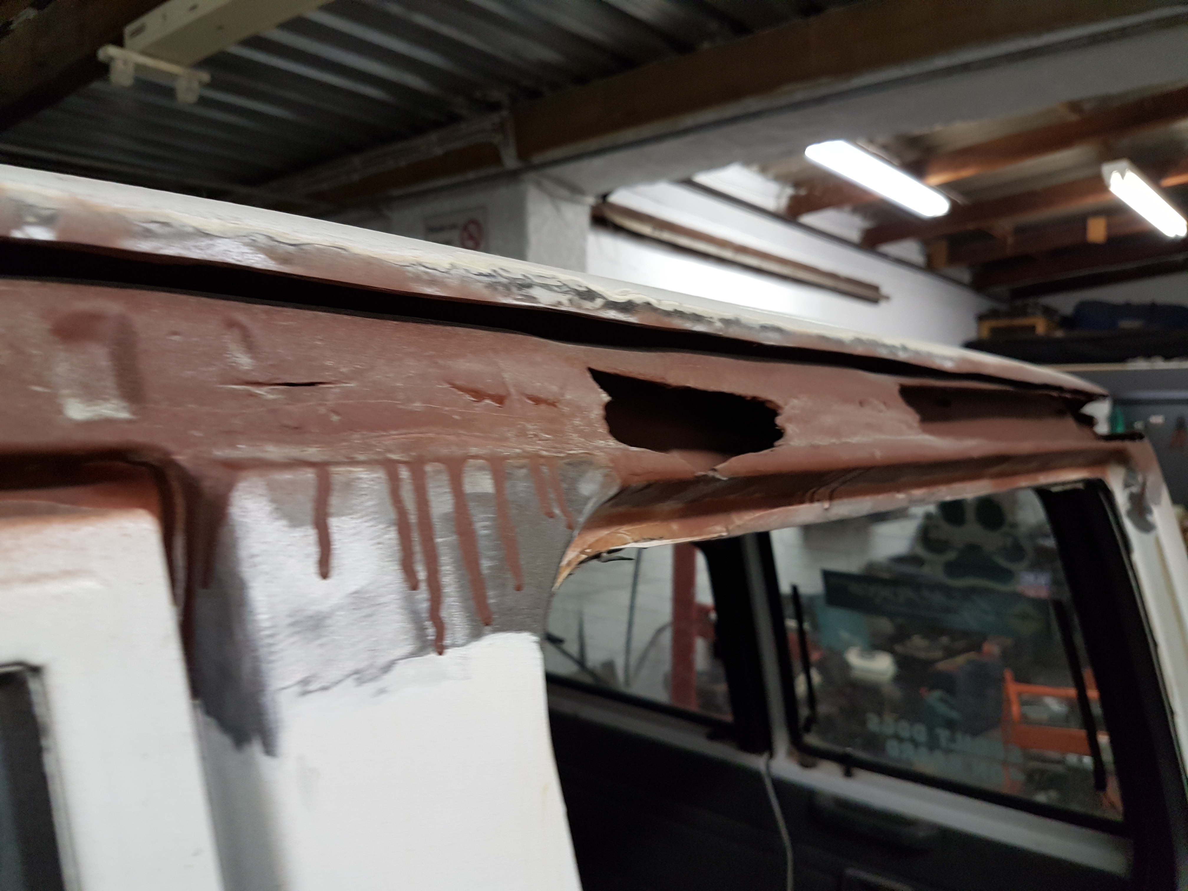

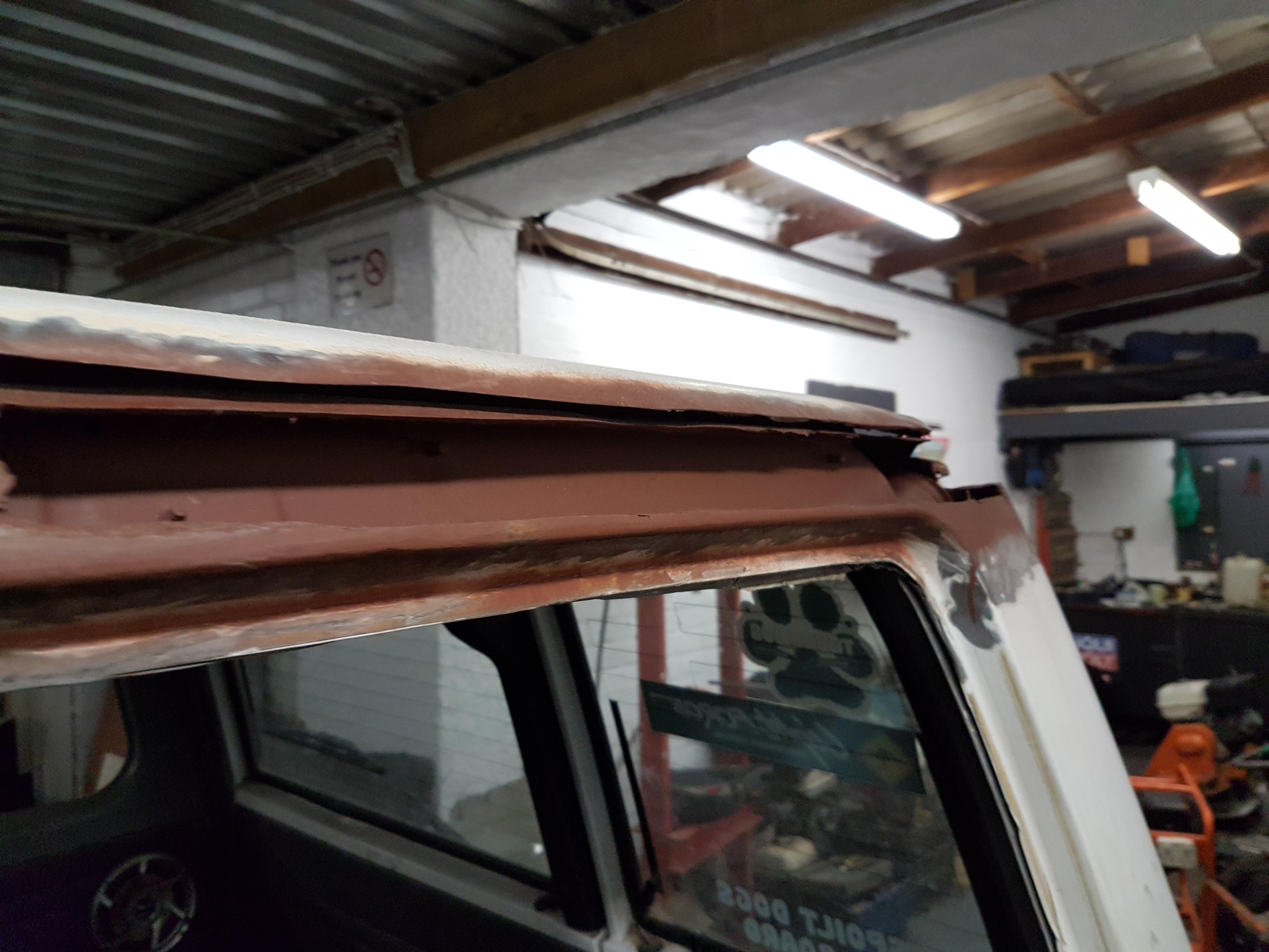

Looking at the pictures it is clearly visible just how strong these vehicles where built. At the gutter rail, you have three layers of metal, inside layer that is attached to the inner structure of the vehicle, second layer is the outer shell of the vehicle that attaches to the A, B and C pillars, then you have the roof layer and then the gutter attaches to that. Mine was rusted on the outer layer and middle layer.
The project started somewhere in July / August this year, and I have lost track on how much money I have spend.....well maybe its better that way. :surprised:

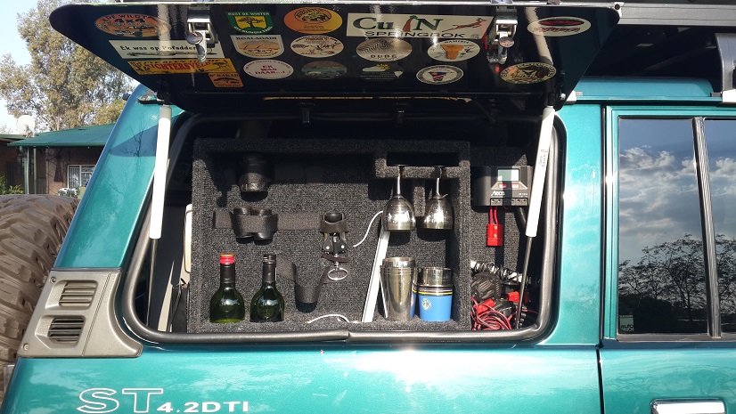

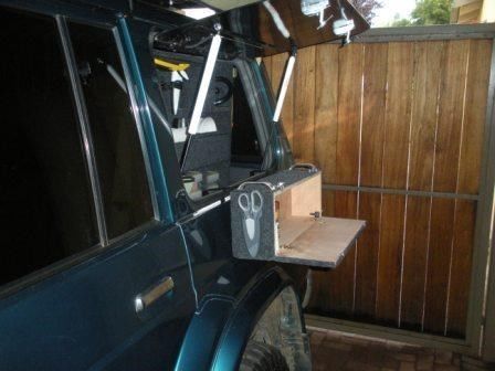

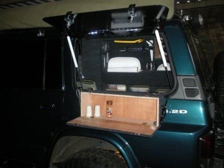

I am considering replacing the rear sliding windows with a pop-up type window, has anyone done this before that can post a picture of yours?

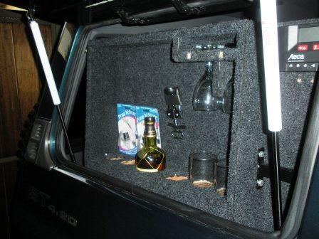

Kyk na dirk ofroad biker se kar hy het dit op
Posts: 2859
Has thanked: 189 times
Been thanked: 270 times

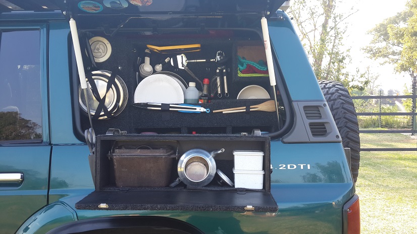

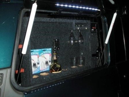

Re: The Rebuild 1991 Nissan Patrol
What I got on the PC
17 Kitchen re-done.jpg (169.98 KiB) Viewed 3655 times
15 Bar & Stecca controller.jpg (206.21 KiB) Viewed 3655 times

Hi Dirk
What material did you use, as well as, do you perhaps have a cad drawing or something similar?\
Posts: 2859
Sorry no such plans, the vehicle had them when I bought it, but it is I would say a 2mm steel plate.
My previous Patrol I had done at Meano and Sons in Krugersdorp, the used checker plate with a steel frame.
They are called Gull wings.
Maybe ask the smart guys to draw you some plans..... you should basically be able to use the standard window as a template, as the window rubber that is currently there stays in place so the Gull wing just replaces the window.
Meano just pop riveted a hinge at the top and added the gas struts, looks very simple to do

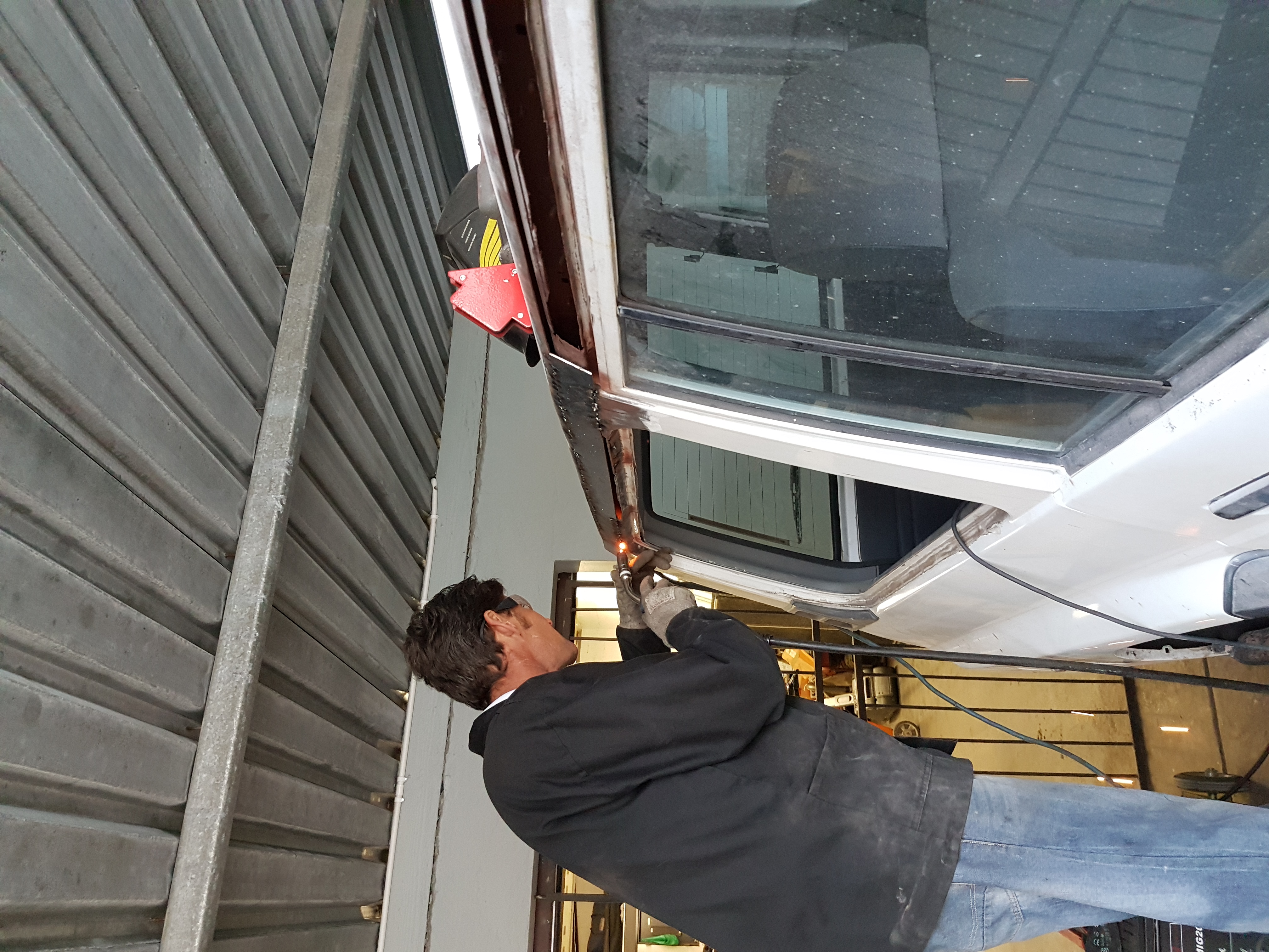

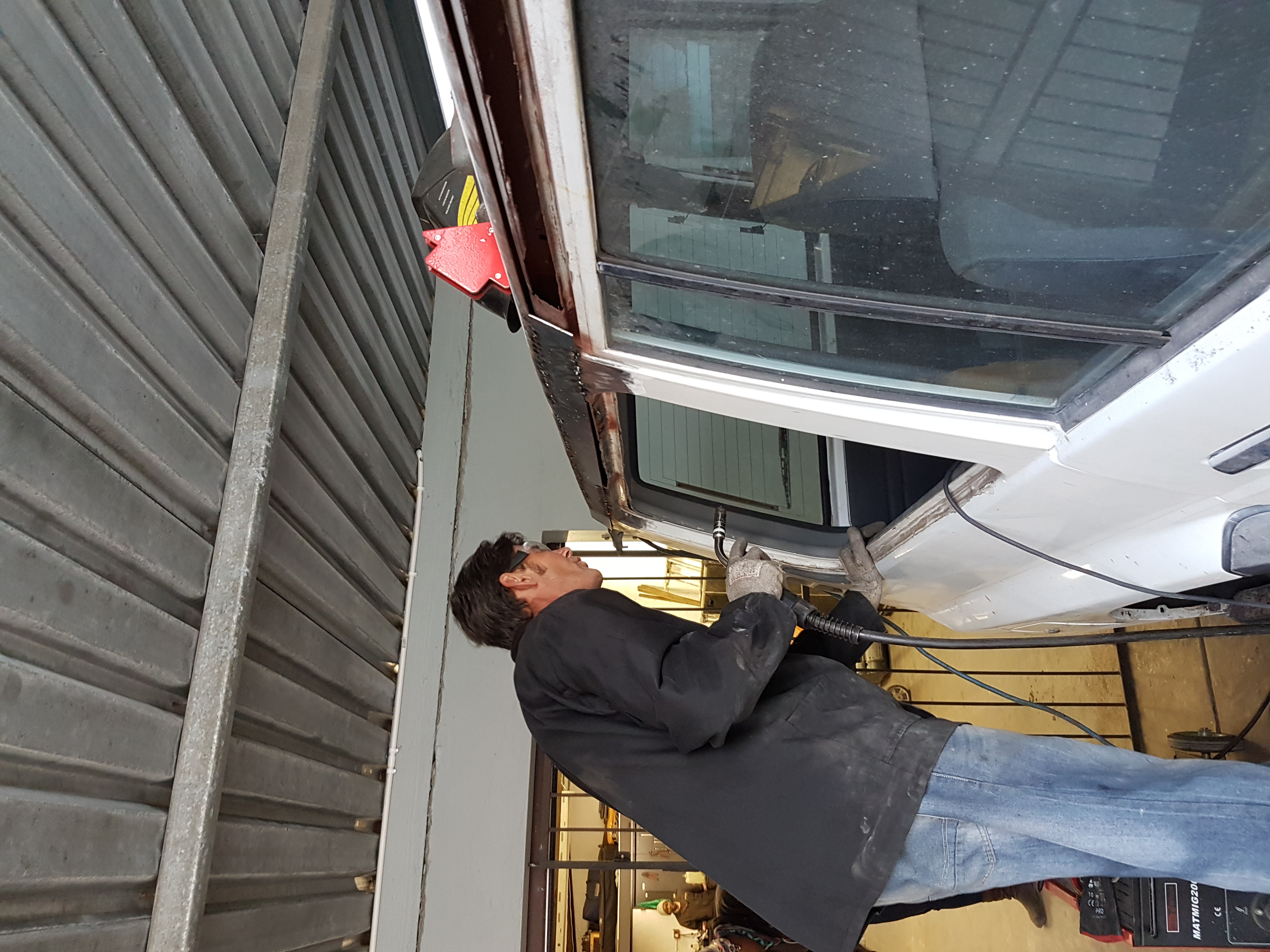

After we done all this welding, the holes, the area between the plates and welding was filled up with sikaflex.
