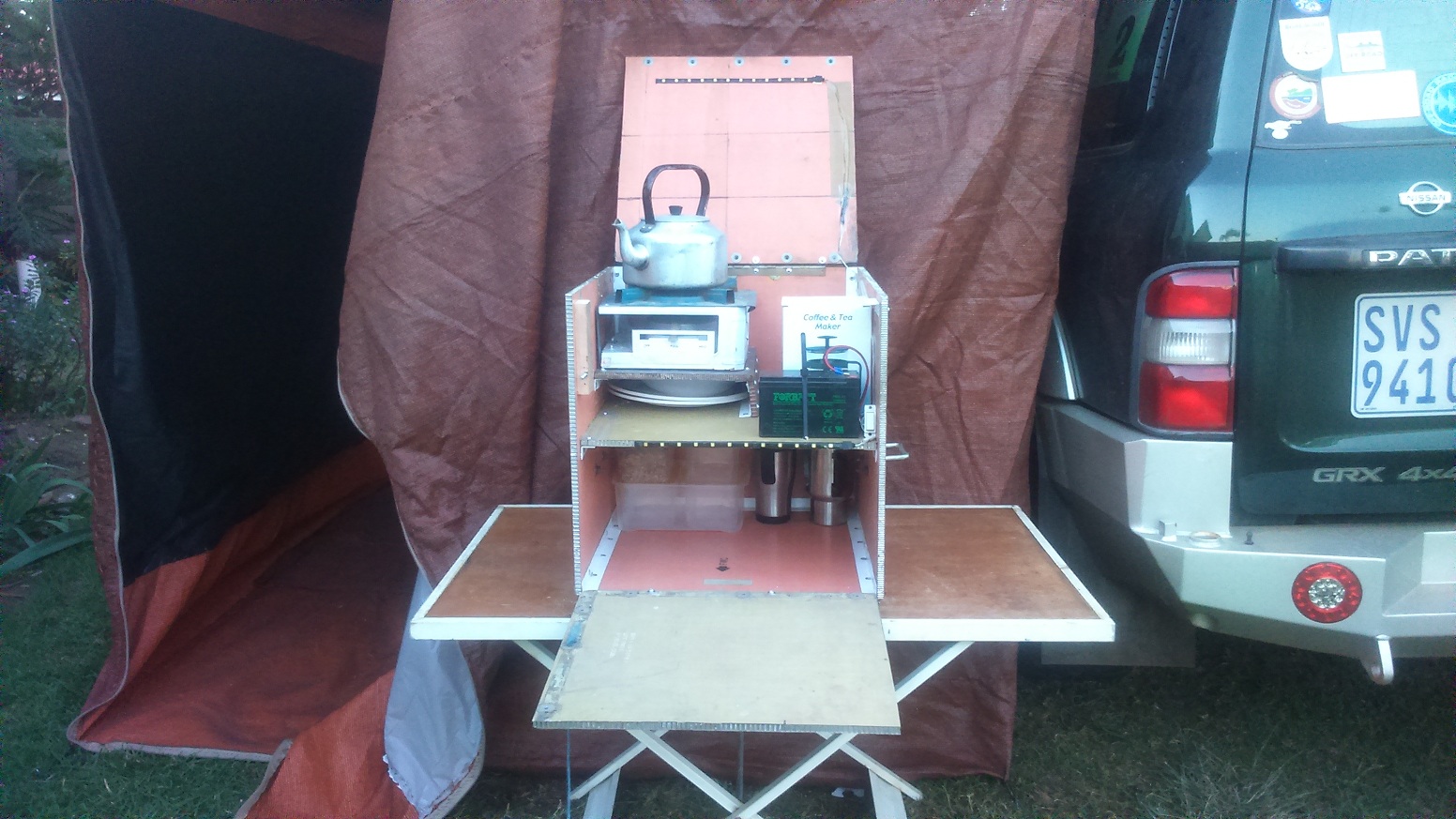

I used those aircraft floor panels to build my kitchen unit.
- Kombuis_4.jpg (387.27 KiB) Viewed 13323 times

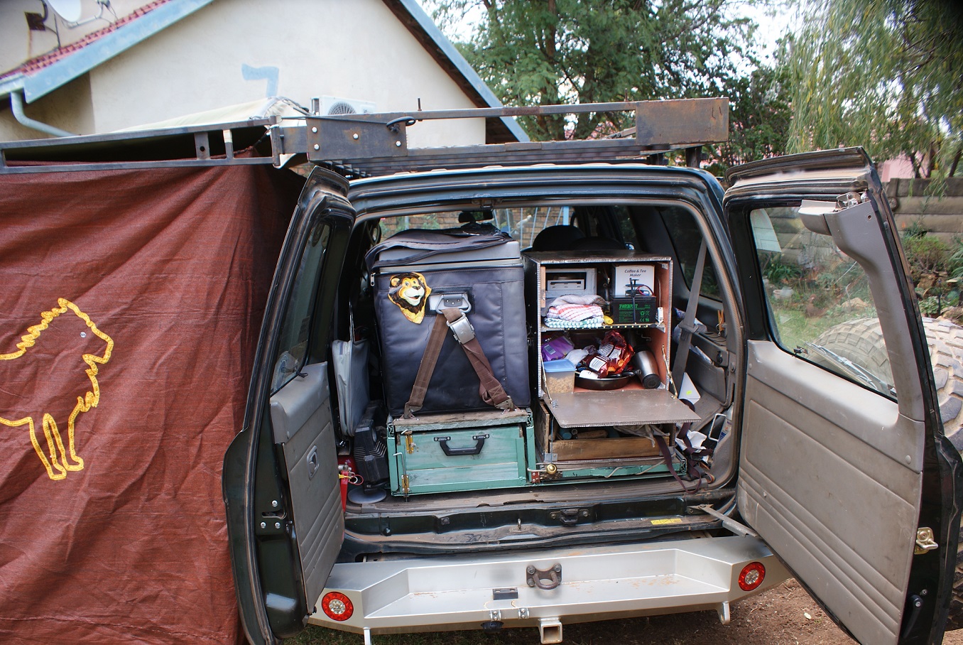

Re: DIY DRAWER SYSTEM
I also use it in my Patrol and in the tent.
- Kombuis.jpg (560.76 KiB) Viewed 13323 times

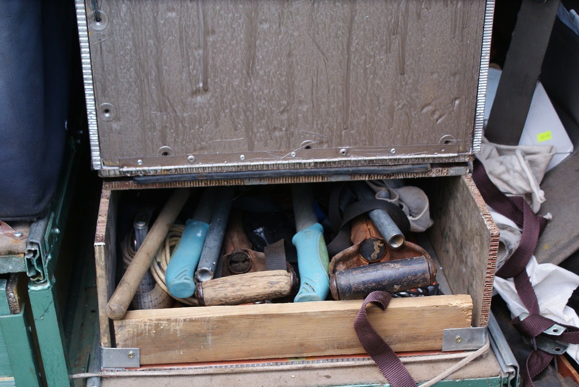

I also build a long unit to but my tools in when I work the weekend in Pilanesberg NR.
- Tools.jpg (338.04 KiB) Viewed 13323 times

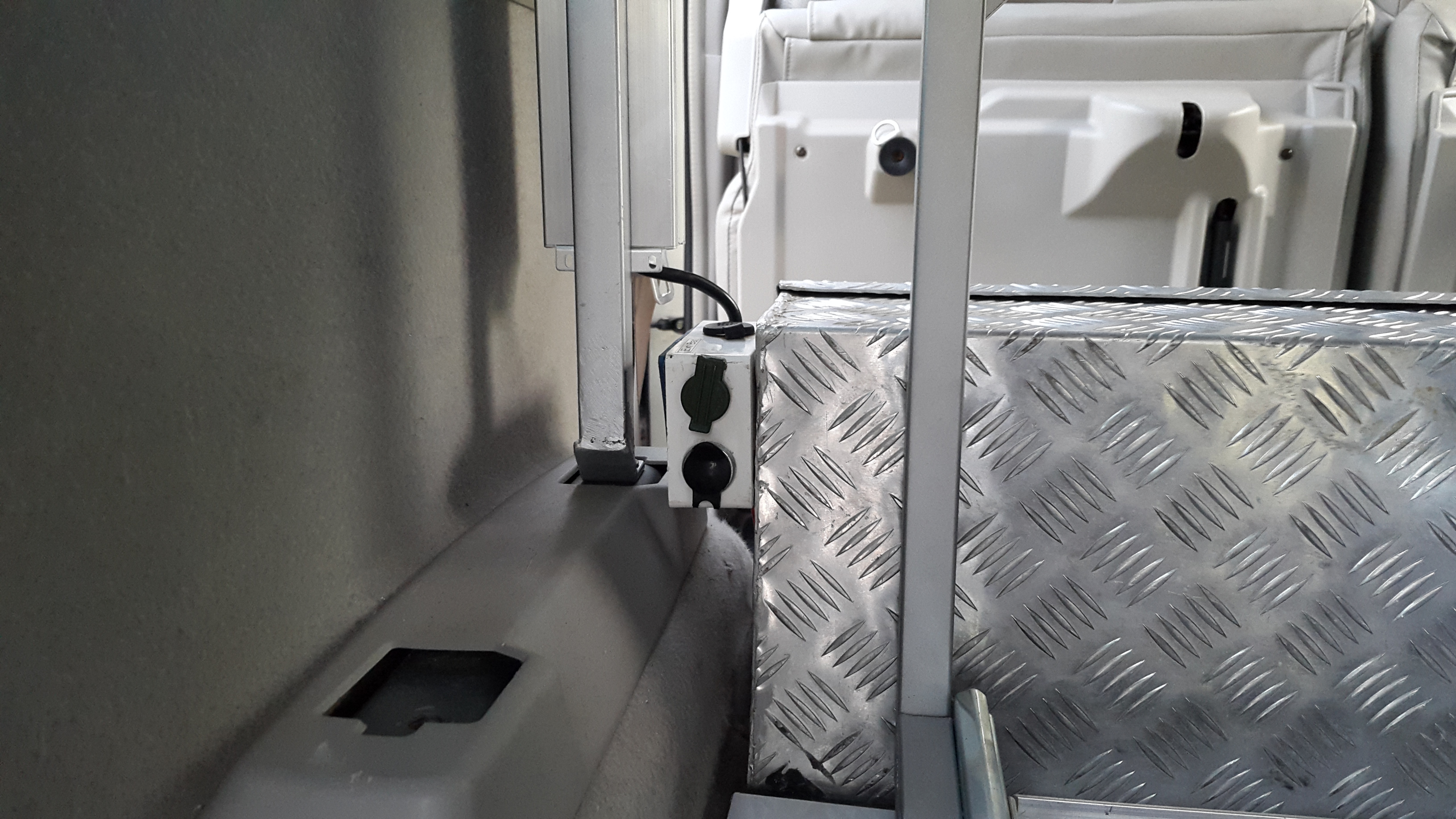

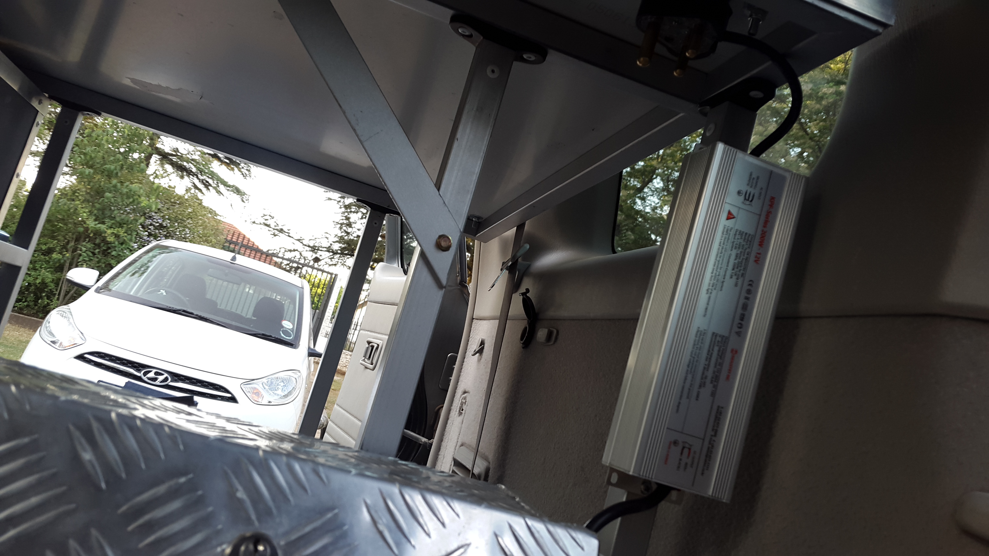

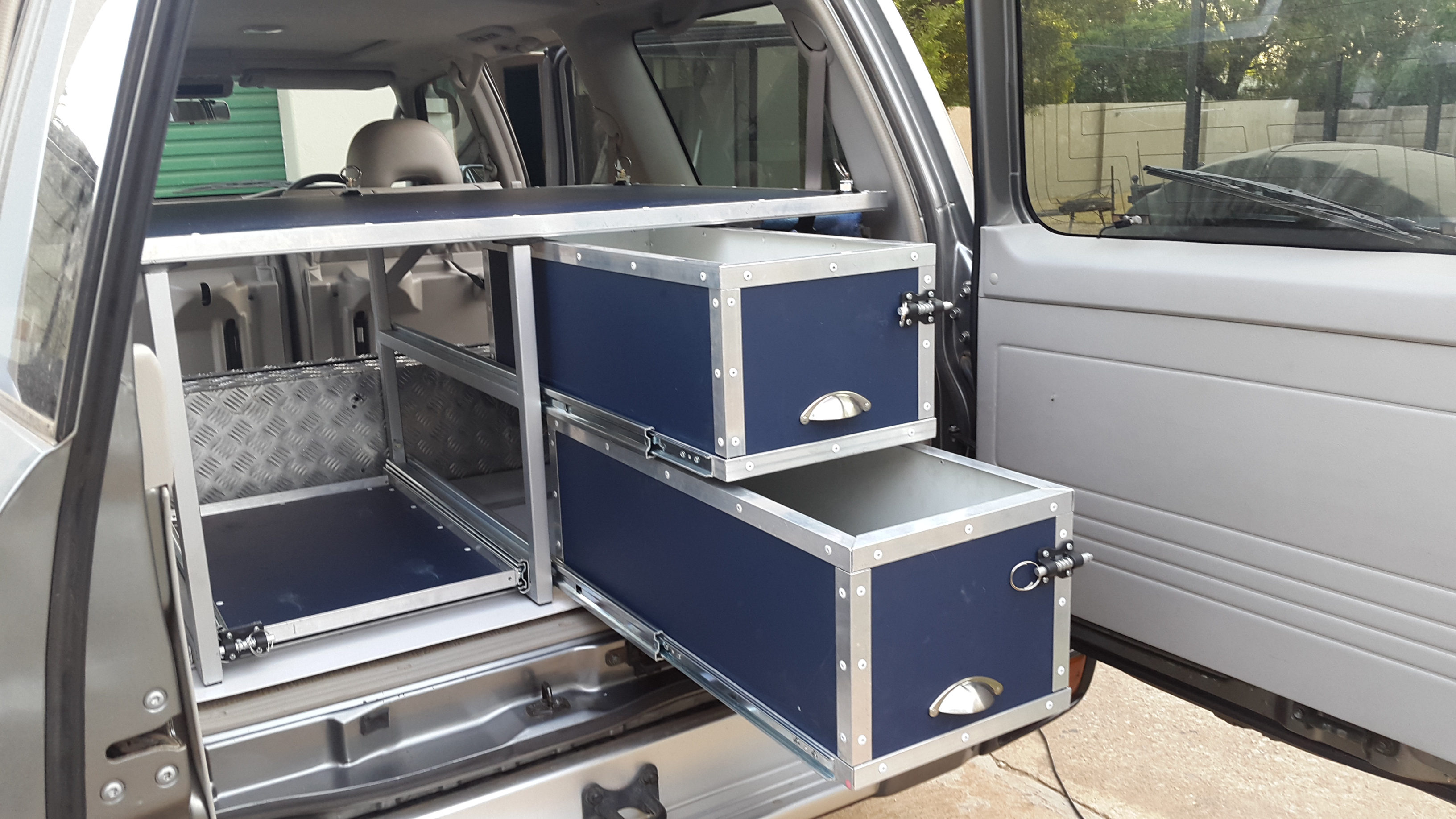

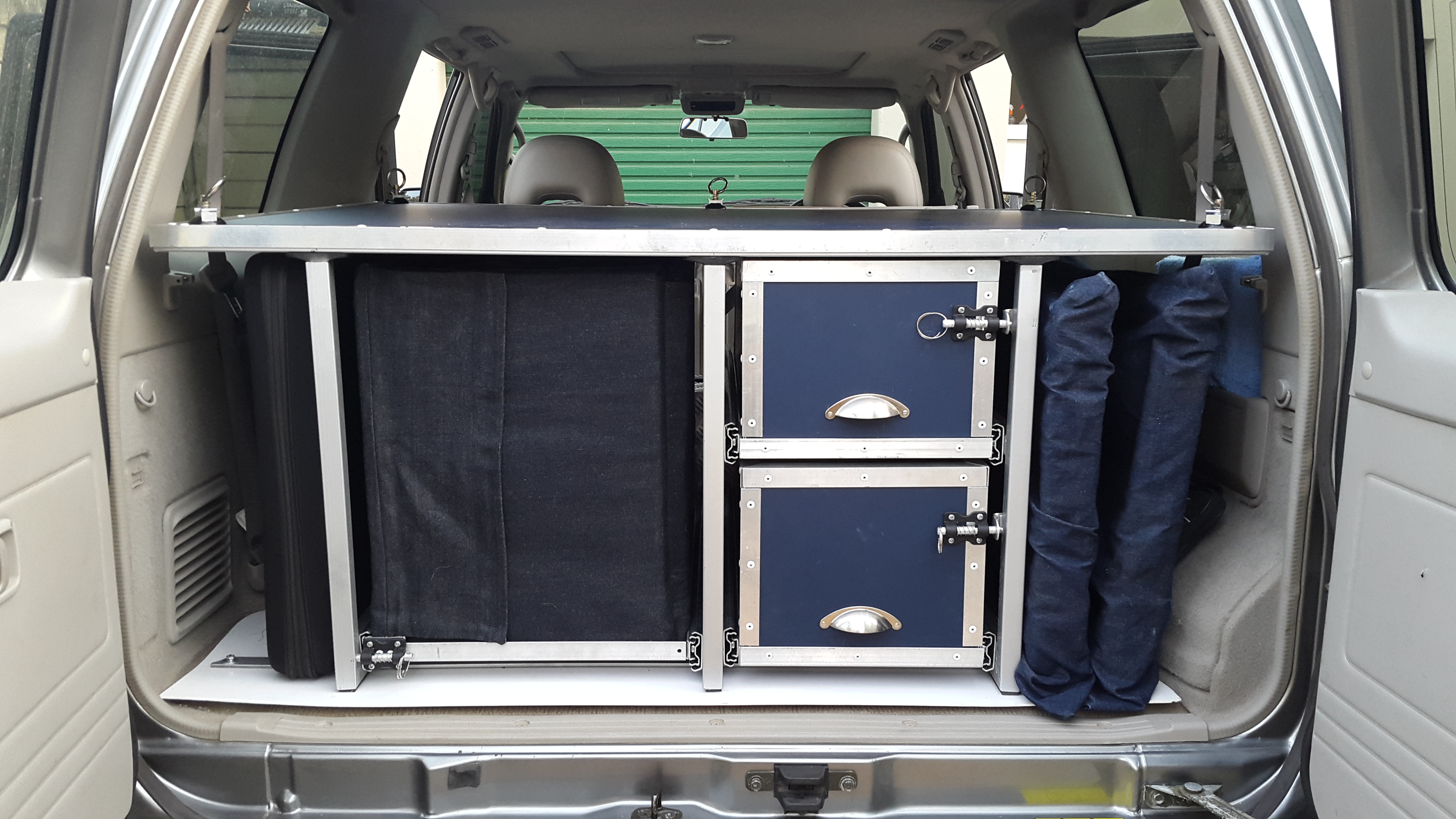

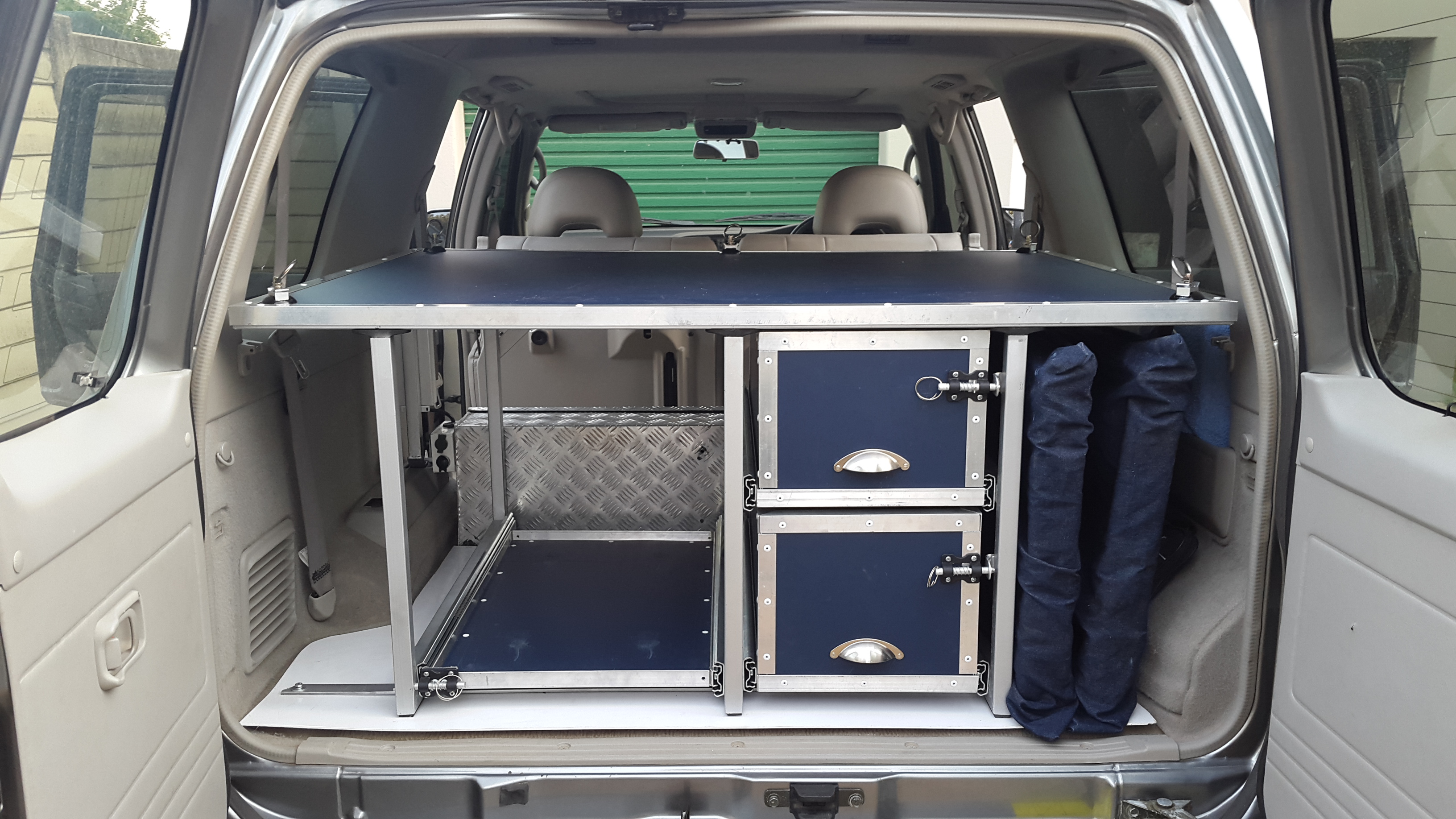

Hi all
Well, I would consider this project complete. I have minor things to do, carpet / rubberize the drawers inside, and fix a few more anchor points for bungee cords. But the final stages were as follows:
Top drawer complete and handles and drawer locks in...
Happy with the accessibility...
Three extra plug points - 2 of them run off the secondary battery, and the third is connected to a power supply. So at a campsite with 220v, I can run a fridge or lighting off that socket...
This is how I mounted it: And that is all. I attribute this effort to hard work, hard whiskey, and a hard wife:
