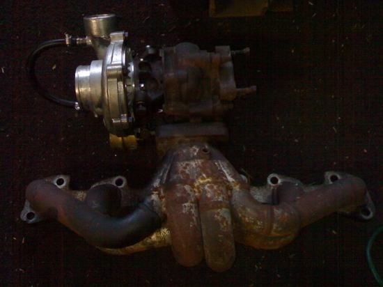

This is what my branches look like ( this was taken when I did my motor rebuild about 5 years back )
I'll leave mine as is at the moment ( touch wood ) as it's still going strong.
I like the second pic Dustin, that looks like a winner for sure. Nice curves for air flow too !!!

Re: TD42 Turbo Manifolds
Looks pretty solid.
I suppose if something works, best not fiddle with it. I've made that mistake a few times
It would be nice if the cast manifold could have each header 'pipe' curving up slightly to feed the turbo, so as to eliminate turbulence.
I mean I suppose I'm being nit picky, or it's just the OCD flaring up as usual, but in my little mind the exhaust gases just 'bumping into each other' before being taken up by the turbo impeller just means less performance, but I know it's probably marginal at best.
Still... if each header pipe curved into the turbo, but still maintained the low profile of the cast iron manifold design, that would be a winner.
Only problem I could foresee is that the converging gasses could possibly create hot spots in certain areas which could cause that area to weaken over time.

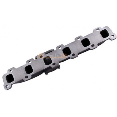

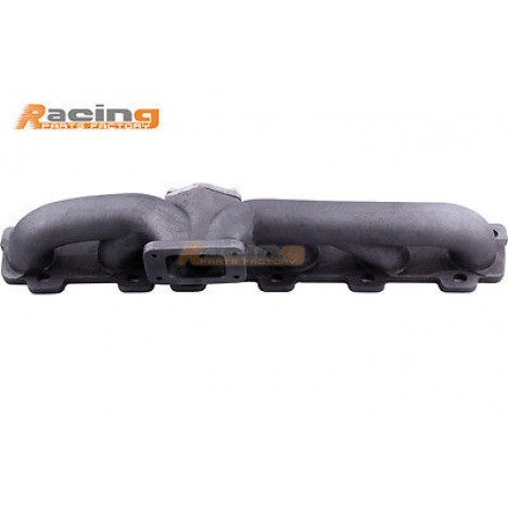

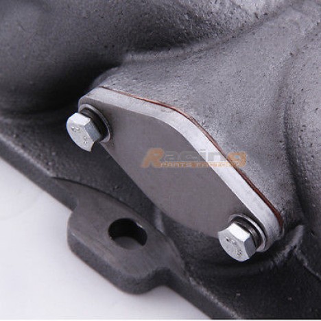

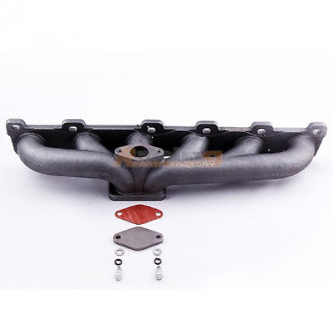

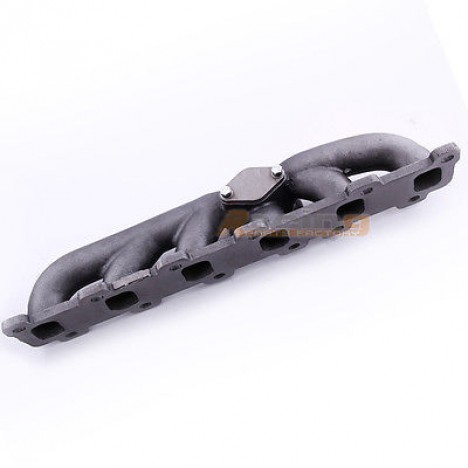

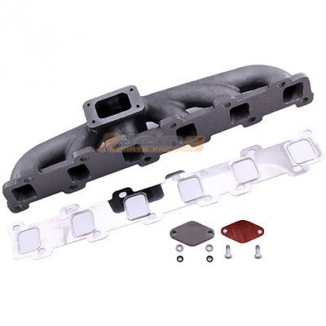

Hi guys
I spent the last week or so trying another angle.
I managed to find a supplier for new TD42 turbo manifolds (high mount).
I emailed and spoke to the supplier, and pushed them for a better price, etc.
The absolute best I could push them to is the manifold and shipping to SA for $330 USD.
Depending if Zuma can keep his mouth shut, that would be around R4500 and some change for a brand new high flow cast iron manifold, all gaskets and shipping to SA.
I'm told it's about R7000 if you order an original 2 piece one from Nissan/UD trucks, so R4500 is not bad.
I can't get an idea of the import duty cost, or if there will be one. If anyone has a contact in customs, this would be the time to ask them.
The secondary port with the blanking plate is for if you want to run an external waste gate, so you can really push the boost up.
They do also have a complete turbo kit (stage 1 - no intercooler) for the TD42 motor as well for $650 USD.
If anyone is interested, drop me a PM and I'll forward you the email correspondence to attach to your email as a reference for the better pricing, etc.
As for myself, I spend 2 days solid phoning every single scrap yard in PE, EL, CT, DBN and JHB...but I found 1 manifold for myself.
I'll hear more on Monday about it, and pics.
If that falls through, I'll probably order one from these guys.
