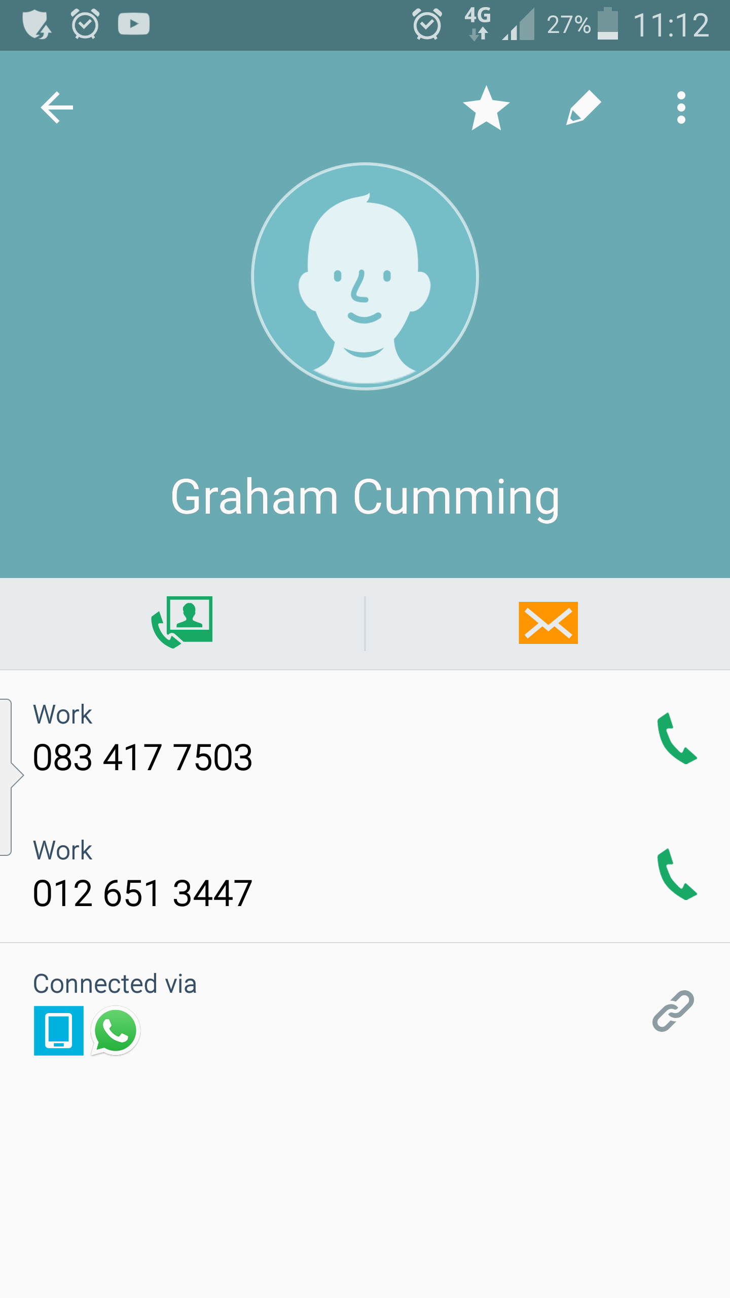

Do you have a number for me or his workshop name so i can google the number and to find out where the place is?

Thanks a million Tinus :)
