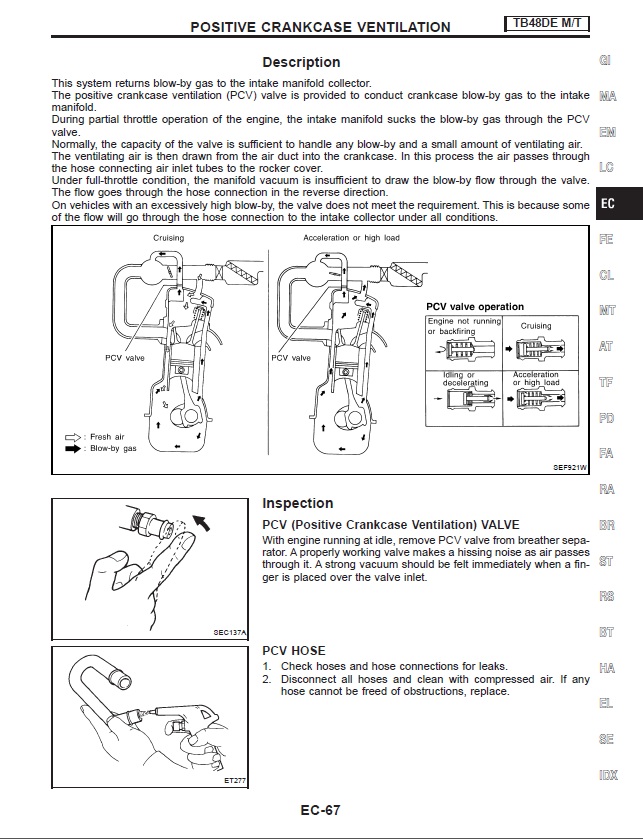

This is part of the manual to check the PCV:
- PCV-48.jpg (171.16 KiB) Viewed 5838 times

Herrie the PCV is working fine. Also inspected the MAF and cleaned it with carb cleaner. The Patrol seems to be idling and running a bit smoother, but time will tell. I did notice that the plastic connectors of the exhaust probes have melted at some point and may not be functioning properly. They were clearly too close to the viper branches at some point. I'll be replacing those soon. 63mm exhaust going in some time this week.Herrie wrote:This is part of the manual to check the PCV:
