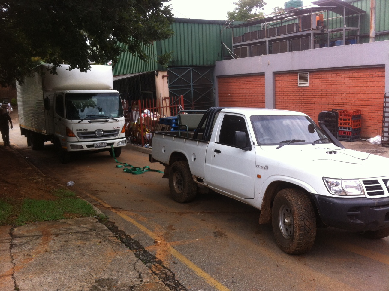

Het gou hierdie HINO 500 trokkie wat in one receiving bay gebreek het, uit die pad gesleep.
Die trokkie is vol water en koeldrank. (So amper 'n vol vrag). Die trokkie se tare gewig volgens lisensie skyfie is 5.1t..

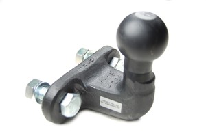

If your tow bar and tow ball in particular is the standard everyday tow hook like this,
then one needs to know that that ball is designed to sheer off at a certain load ( for example if the trailer flips over ). This ball becomes a projectile of massive proportions and can easily go through a human skull....
So basically on this setup of towball/hitch.... never do a recovery.

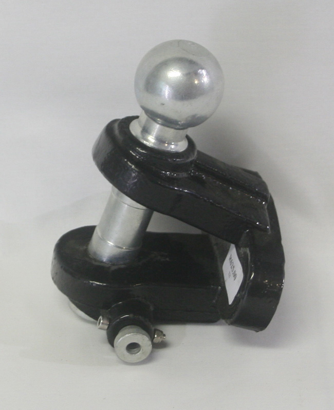

If you have this set up
then things change a bit. The weak point then becomes either the bolts holding the tow hitch to the tow bar, or the bolts holding the tow bar to the chassis. However leaving the tensile strength out of the equation at the moment, in theory you can attach the strap through the pin and .....

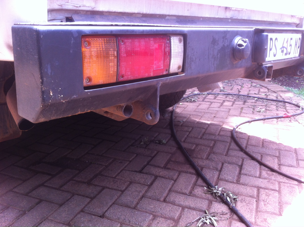

Yip, i got decent recovery points on my rear bumper. The removable towbar spends its days lying in the garage gathering dust.
Used a 14t rated pull strap with the biggest bow shackle i got in my arsenal.

Excellent !!!.... but again always keep in mind where the weak point is... a weld that is hidden or rusting out over time or the bolts holding the bumper to the chassis.

Hold hard here a minute guys...
Safety is good and right, and should always be considered whatever you do. But.
If towing a lorry slowly on level ground with a pull strap, there is absolutely no danger whatever recovery point breaks. Because a pull strap is not really elastic and doesn't store energy.
If it were on an angled recovery (uphill), then should something break the lorry might run away and one would need to take steps to prevent that.
Things only turn into missiles when excessive force is used, or when snatch-ropes or snatch-straps are used.
