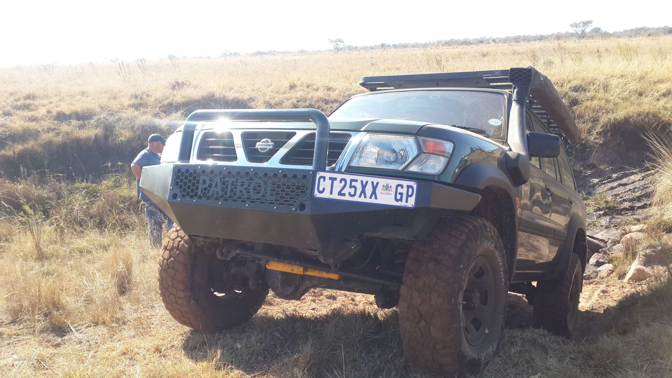

Dave, I am a big fan of a front mount cooler. It really cools better (IMHO) than a top mount cooler because you can install a much larger cooler than the top mount and it has zero heat soak from the engine. The down side of the front mount is firstly the amount of word...... took me about 3 days to in stall mine and to do all the plumbing. Secondly you need to make sure that you get enough air flowing over the cooler otherwise its not really that effective.
Her is a post I did when I rebuild my engine where you can see how I installed the cooler and how big it is,
http://patrol4x4.co.za/viewtopic.php?f=44&t=4458
Also, this is the mod I did to the front bumper to get more air to the cooler.....works like a bomb!

Thanks Tinus.....I've just called about the bumper.
They have one in stock and are keeping one back for me :biggrin:
I wasn't originally going to go with a new bumper, but I think it makes such a big difference to the look of the vehicle, and also to have some decent recovery and hi-lift jacking points is a big advantage.
Wow Michael, your intercooler and bumper mods look fantastic.
