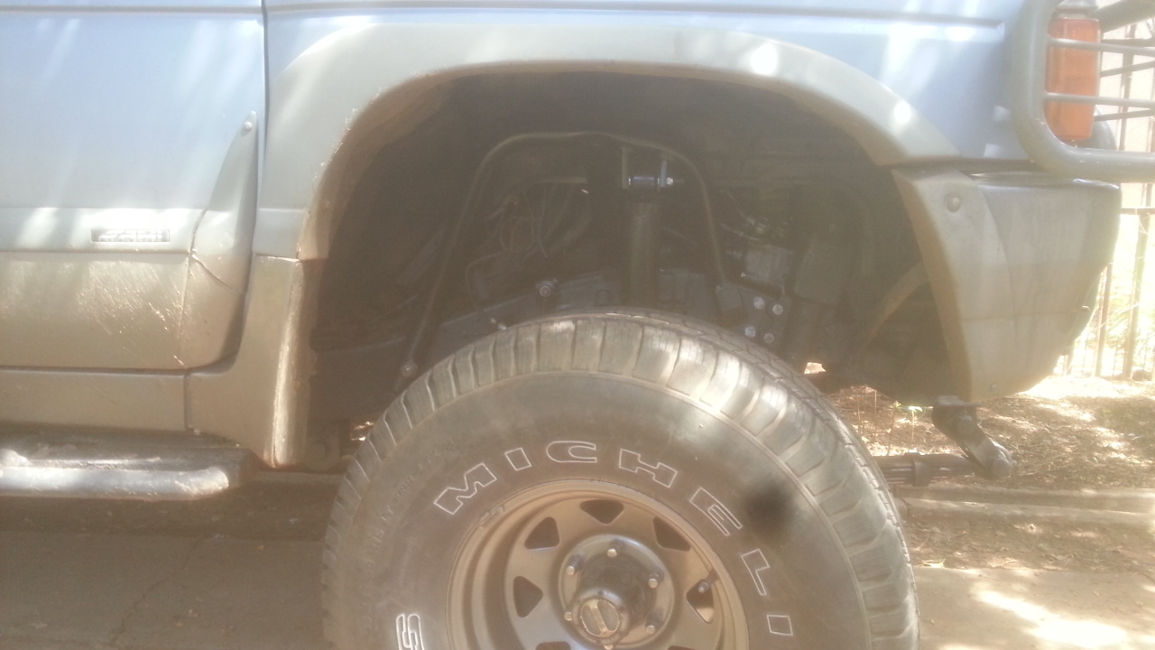

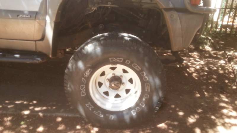

Funny enough ,i think the Nissan Patrol is the only "lorrie" where the rim ID is a 110mm,well that is like you said,at the brake disc and the Safari is 109mm
I think I must try Tinus's spacers first and see how it sits on the vehicle....
kind regards
kind regards

Chuck (Christo's 4.2 diesel ) has 15" rims on.... not sure if he has spacers on or if its just a deep dish rim.... looks brilliant though with big tyres and small rims !!

I have the MQ Patrol front diff on my lorrie, and the only rims that fitted, was the Sani rims, but looked rubbish because I could only fit 31" tires as they were 7J.
The Sani Mags were also 110mm centre hole.
I then got a set of steel 8,5J's with 30mm negative offset, but only have 4 of them and also looking for one or two more to fit as spares.
The 30mm Negative offset gives you the clearance for the brakes.
