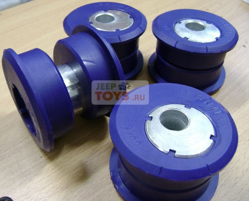

Here is a pic of how the adjustable bushes look, seems like they press in way easier than the fixed bushes. Each bush is basically a three piece unit where the centre bush can be removed and turned to the desired degree of offset you require

Wow!... so there's no "outer sheath" to the bush? thats interesting.
