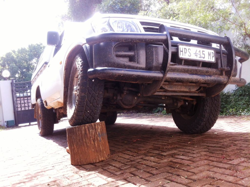

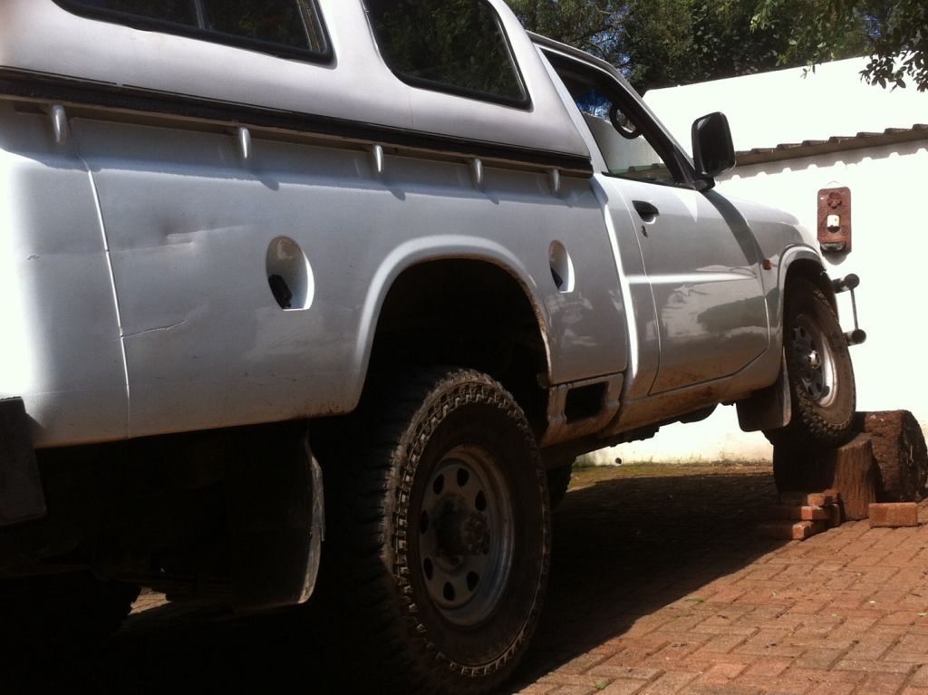

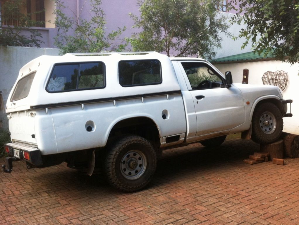

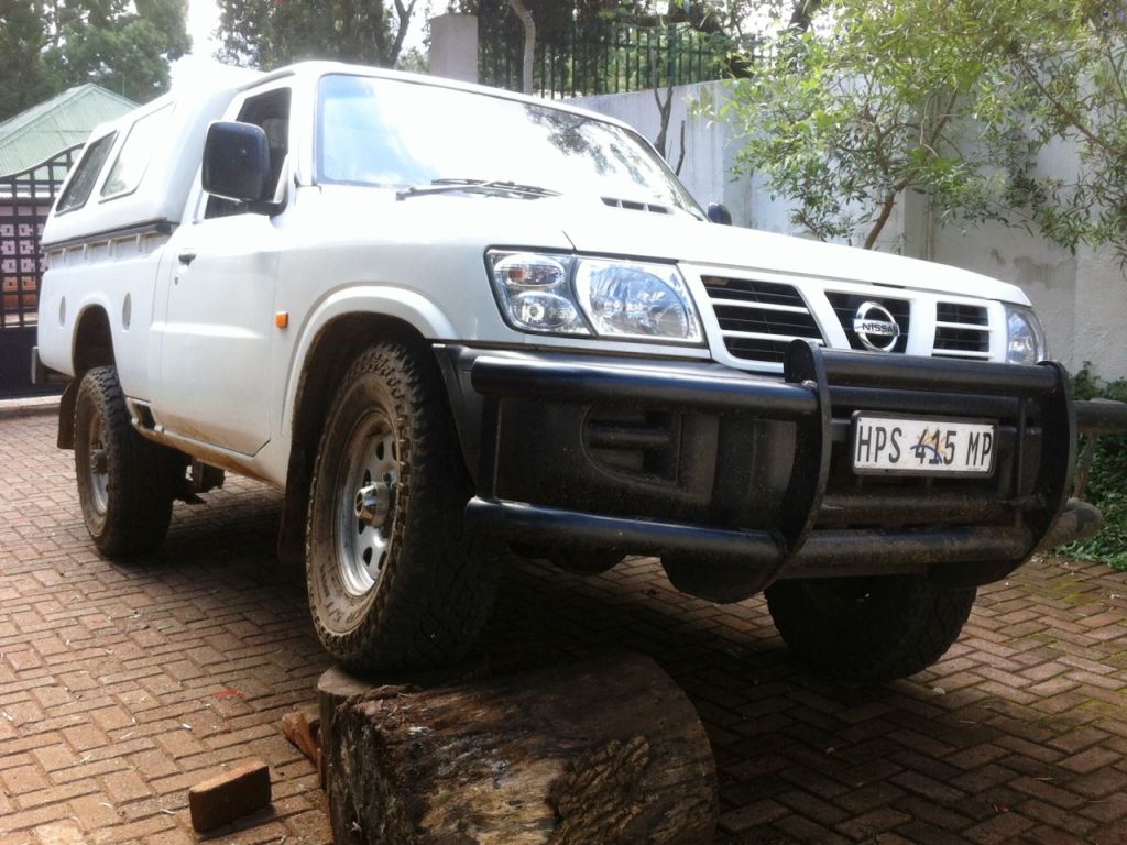

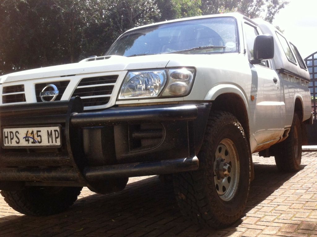

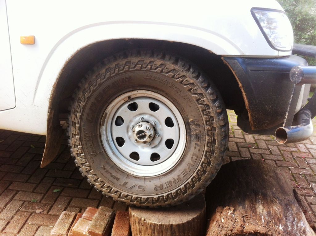

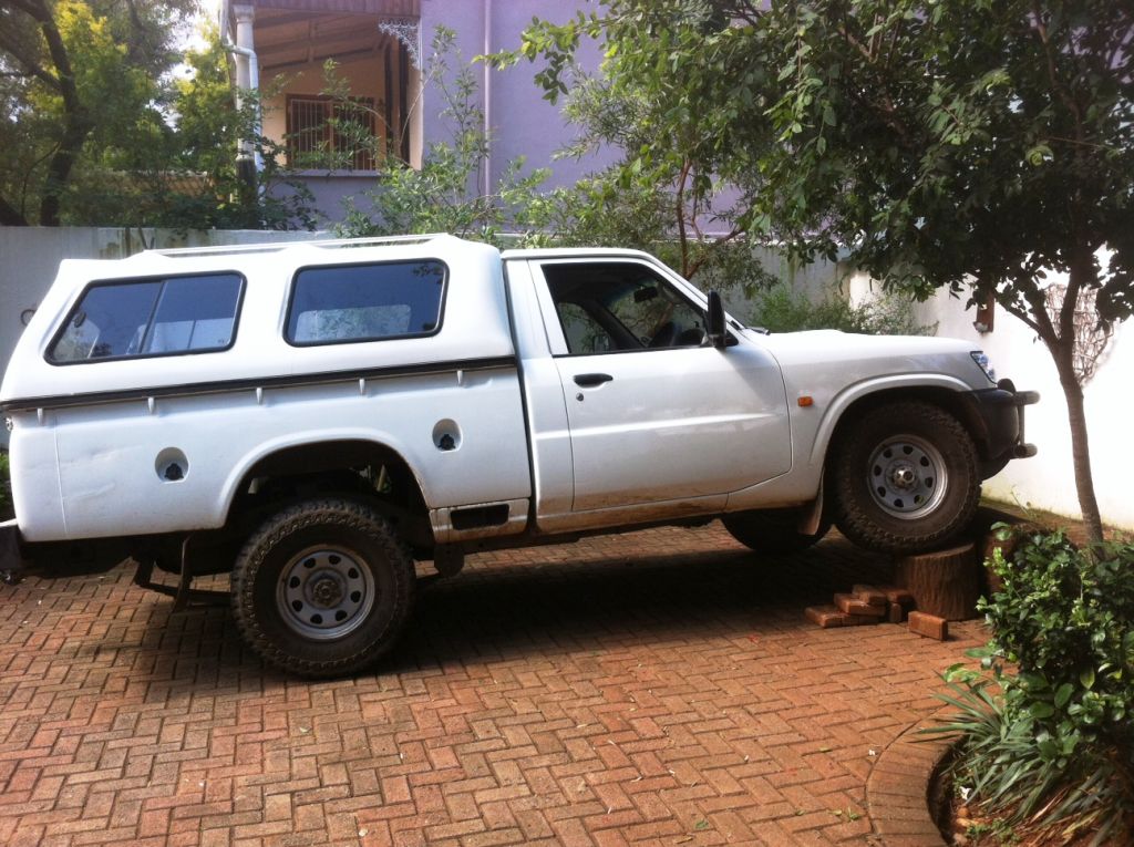

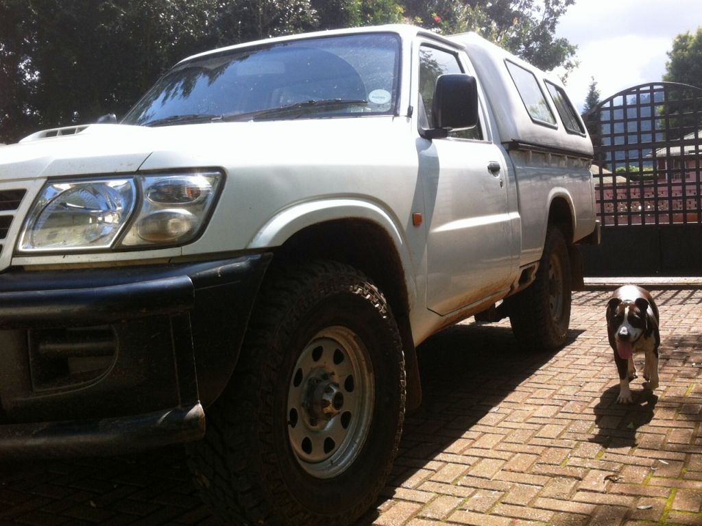

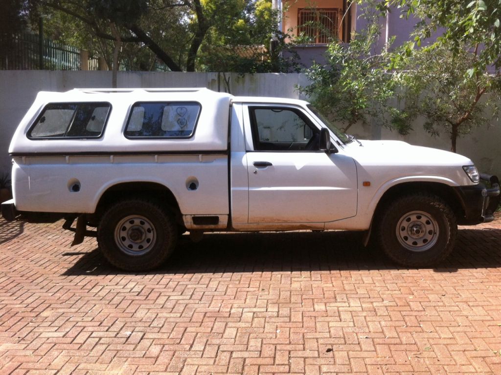

Some pics as promised...
- 11.jpg (116.22 KiB) Viewed 5751 times
- 9.jpg (119.7 KiB) Viewed 5751 times
- 8.jpg (153.06 KiB) Viewed 5751 times
- 7.jpg (141.53 KiB) Viewed 5751 times
- 6.jpg (94.09 KiB) Viewed 5751 times
- 5.jpg (131.9 KiB) Viewed 5751 times
- 4.jpg (123.53 KiB) Viewed 5751 times
- 3.jpg (136.6 KiB) Viewed 5751 times
- 1.jpg (158.21 KiB) Viewed 5751 times

42mm spacers each side will do the trick boet.
Also, if you cannot do the suspension lift for a while, then i suggest the following as a far cheaper alternative that will work perfectly fine until such time.
- Make some extended shackles for the rear leaf springs , easy, if you extend 75mm pin to pin you'll gain a good 1.5"-2.0" , depending on your current leaf pack
- Install front coil spacers that suit the vehicle once your extended shackles are in. All you do is lift the coil and slip them in. most likely 1" - 1.5" will be max.
I made extended shackles for my pickup as Mickem suspensions buggered me around big time, waiting months for them to even quote me and finally they said they can't make them,... i got the moer in and made myself, will post pics and writeup soon as i can for you. easy.
Anyway,.. i would do these 3 things and when you have the loot then put the 2" suspension lift in and remove the coil spacers in front.

It looks good and will look a bit better with the lift kit!
