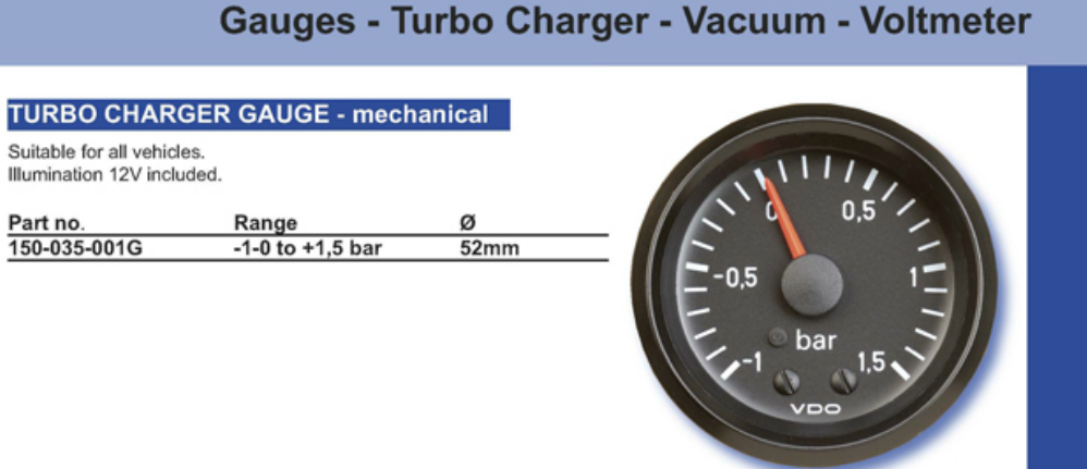

Hi JoshJoshJ wrote:Is there different boost gauges for petrol and diesel. My mind tels me there is no difference. Its an instrument that measures boost. I might be wrong. Want to fit madman for egt and oil pressure then ad aditional turbo boost gauge.
Can some one reffere me to a post of a boost gauge fitted by one of you or post pics please.
I did get permission from the stealer to add these. They feel it adds value.
I have been looking for a boost guage myself for a while now and I also want to install a manual boost guage alongside my Madman system. I feel it is best to use the oil pressure on the Madman and have a dedicated boost guage.
The ideal boost guage will be one that shows boost only up to 1.5bar but unfortunately the best I could find was a VDO that starts at -0.5 up to 1.5 bar.
Except for the vacuum that it can display I think this one will be perfect for your vehicle, buying one that goes till 2.0bar is a bit of a waste in my opinion.
The ideal guage for my vehicle would have been a 0 - 1bar gauge but could not find one...

Hi josh
Just check what you max boost pressure should be,the pressure that tinus stated are usually for standard turbo set up
On the zd30 motor are a lot higher than normal setup , it can peak to 1,5 bar so a 0 to 2 bar gauge if you look in the back of
Installation manual the is a part code phone diesel electric they cost around R950 the last time I bought one

Re: Madman / Landy on line
Here is the website of the place I found in JHB that sells VDO gauges
http://www.vdoautomotive.co.za/automotive.php
As Juice then mentioned, if your Patrol's peak boost is 1.5bar you will need a 2.0bar gauge. I will also have a look at Diesel Electrics products
Here are what is available at the above mentioned store
The -0.5 to 1.5 bar gauge is R960 if I remember correctly.
- -0.5-1.5.PNG (359.18 KiB) Viewed 3472 times
