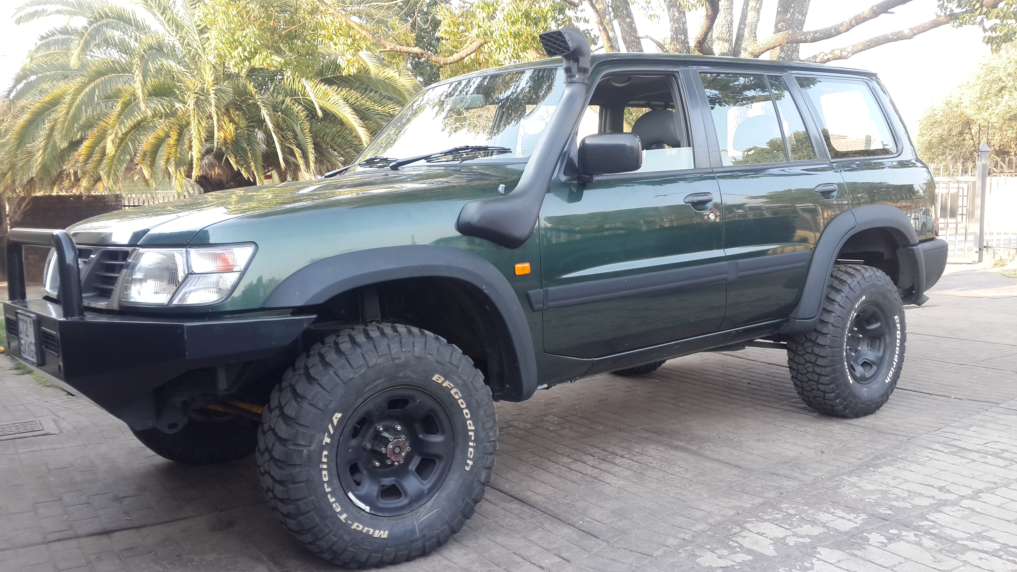

Ok Gents, I have fitted the snorkel so far but have not yet connected it to the air cleaner yet.
Also fitten my new 33" tyres and I like the look

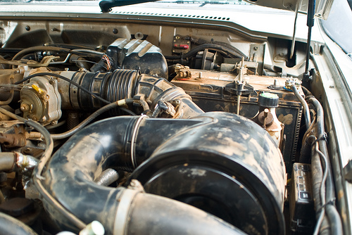

I am currently looking at the air box of the ZD30 as well as the 4.5 as I think both of tjem will fit perfect in tje engine bay.
What do you guys think of the 4.5 air box?
Re: Air cleaner for 4.2TD
I can't recall the look of that.... Have you got a picture of it?
I was searching on the net for 4.5 air cleaner housing and found the following. Not sure if this is actually how it looks, but this looks like the 3.0 filter housing?
How does yours look Cedric?
Yip.... mine looks almost identical to that... I think that is actually a 4.2 diesel with the ZD30 airbox.

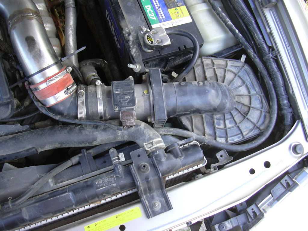

Yes it is a 4.2D if I am not mistaken.
Found this one as well which might be the 4.5 air box
- 3371261197_84b2b59d26.jpg (134.18 KiB) Viewed 2720 times
