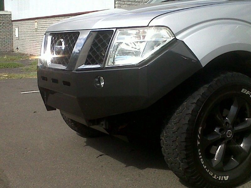

Thanks to all of you for the warm welcome and thanks for the towing info Chris. What kind of set up do you have as a front winch plate/replacement bumper and front tow ball. It's just a personal thing on my side, but I think the Patrol is a good looking vehicle that just might be spoiled by a big, heavy replacement bumper etc. I realistically only use my winch for hauling the boat onto the trailer on the beach.
It would be great to see a few pics of the front end of a few vehicles to get an idea of a few options.
I found this guy in Cape Town that makes a good looking bumper for the patrol and he can incorporate the winch plate and tow ball. The set up before shipping is R12,000 and it will accommodate my 12,000 lb winch hidden behind the bumper and slide front ball.
See pic below.
See pic below.

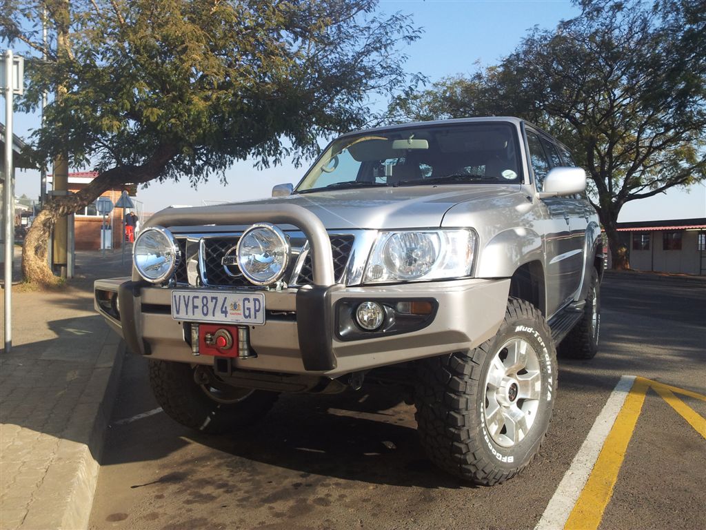

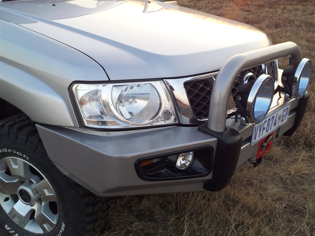

Re: Good day, I'm new here
My front end - cant beat the look in my view. If you in the area come and look at the set-up.
I have a Warn M8000 upgraded the motor to the 6hp motor of the 9,5XP - devastatingly powerful now..
