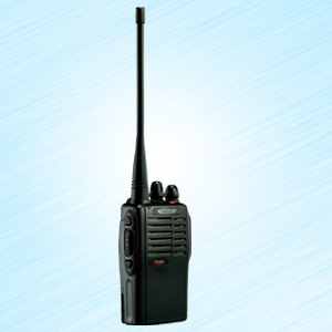

One of the better, cost-effective VHF Portable Radios available for use by forumers has been the Kirisun PT4200 VHF portable Radio, which is a 16-Channel unit covering the full VHF spectrum. Featuring a 1200mA/Hr Lithium-Poly Battery, this light-weight robust unit has been tried and tested for use in harsh environments and has come through with flying colours. Hence it has become my recommendation for an excellent "value for money" portable radio.

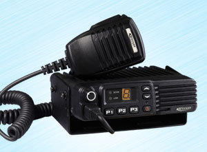

Kirisun has recently introduced a brand new Mobile VHF radio, the PT8000, which we have tested and are happy to announce that the short-comings of the older model radio have been addressed. This model is now totally approved by us for use in a 4x4 vehicle. The PT8000 unit is a solid eight-channel VHF Mobile radio at an affordable price.

Re: TWO-WAY RADIO CONSIDERATIONS FOR 4X4 DRIVERS
What prices can we get them for?
