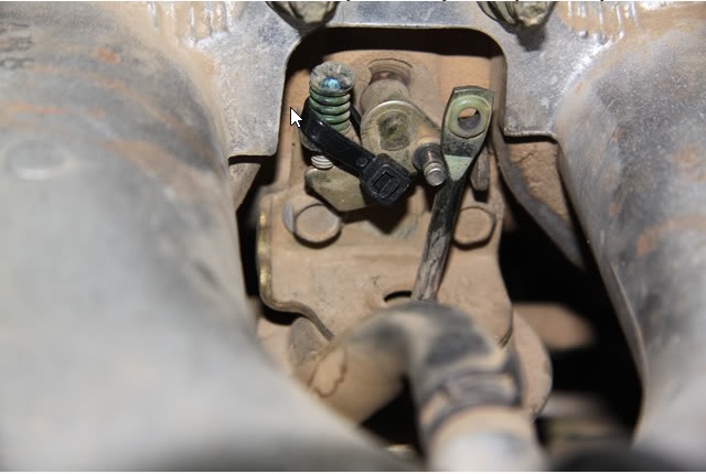

man all you need is a cable tie .....he says you cant break it other than butterfly screws dropping into inlet like jacobez 4.8 did but it happens rarely :oldtimer:

Re: Power Valve Actuator (PVA) Mod
graham says that we are happy with it in the open posison it will be better to remove the butterfly and screws just leave the shaft .....in he full open it vibrates a lot and can come loose like jacobez one did

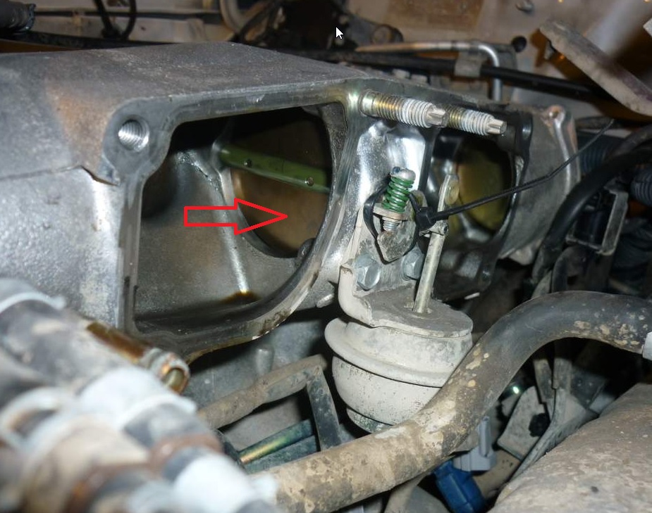

I have the instructions from the AUSSIE forum, but there is no pictures? Is there one available with pictures so I dont tune the wrong thing?
After seeing this picture......I had a very different view to what it should look like. :confused:
Post by David »
Jacques, the picture above is from the Aussie forum but they actually removed part of the intake which is not necessary.
Pictures Post#34
Post by NISMOnator »
Thank you David, :salute:
The arm I see on the right? Was that connected to the part that should be cable tied? Just unclip and leave it there? :think:
