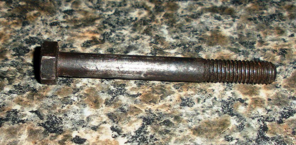

Gents,
Just went through a similar process. My GQ's right rear wheel was getting very hot. More than the right hand side. I changed the discs, pads and found the calipers in order. To my disgust the problem had not gone away. After cleaning the bolts holding the caliper on I found one of them to be catching ever so slightly. Below is a pic. Changed the bolts an bob's your uncle.
- Caliper Bolt.jpg (133.86 KiB) Viewed 3640 times

@Grant: if you say the bolt was catching, because the shaft was not smooth anymore?
