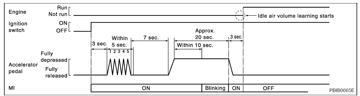

Idle Air Volume Learning
DESCRIPTION
“Idle Air Volume Learning” is an operation to learn the idle air volume that keeps each engine within the
specific range. It must be performed under any of the following conditions:
+ Each time electric throttle control actuator or ECM is replaced.
+ Idle speed or ignition timing is out of specification.
PREPARATION
Before performing “Idle Air Volume Learning”, make sure that all of the following conditions are satisfied.
Learning will be cancelled if any of the following conditions are missed for even a moment.
+ Battery voltage: More than 12.9V (At idle)
+ Engine coolant temperature: 70 - 95°C (158 - 203°F)
+ PNP switch: ON
+ Electric load switch: OFF
(Air conditioner, headlamp, rear window defogger)
On vehicles equipped with daytime light systems, set lighting switch to the 1st position to light
only small lamps.
+ Steering wheel: Neutral (Straight-ahead position)
+ Vehicle speed: Stopped
+ Transmission: Warmed-up
For models with CONSULT-II, drive vehicle until “FLUID TEMP SE” in “DATA MONITOR” mode of “A/T”
system indicates less than 0.9V.
For A/T models without CONSULT-II, drive vehicle for 10 minutes.
Without CONSULT-II
NOTE:
+ It is better to count the time accurately with a clock.
+ It is impossible to switch the diagnostic mode when an accelerator pedal position sensor circuit
has a malfunction.
1. Perform EC-31, “Accelerator Pedal Released Position Learning”.
2. Perform EC-31, “Throttle Valve Closed Position Learning”.
3. Start engine and warm it up to normal operating temperature.
4. Check that all items listed under the topic “PREPARATION” (previously mentioned) are in good order.
5. Turn ignition switch “OFF” and wait at least 10 seconds.
6. Confirm that accelerator pedal is fully released, turn ignition switch “ON” and wait 3 seconds.
7. Repeat the following procedure quickly five times within 5 seconds.
a. Fully depress the accelerator pedal.
b. Fully release the accelerator pedal.
8. Wait 7 seconds, fully depress the accelerator pedal and keep it for approx. 20 seconds until the MI stops
blinking and turned ON.
9. Fully release the accelerator pedal within 3 seconds after the MI turned ON.
10. Start engine and let it idle.
11. Wait 20 seconds.
12. Rev up the engine two or three times and make sure that idle speed and ignition timing are within the
specifications.
ITEM SPECIFICATION
Idle speed 675±50 rpm (in “P” or “N” position)
Ignition timing 10±5° BTDC (in “P” or “N” position)
13. If idle speed and ignition timing are not within the specification, “Idle Air Volume Learning” will not be
carried out successfully. In this case, find the cause of the incident by referring to the “Diagnostic Procedure”
below.

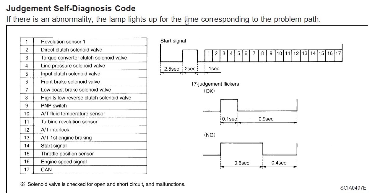

A/T SELF-DIAGNOSTIC PROCEDURE (WITHOUT CONSULT-II)
Description
In the unlikely event of an abnormality in the electrical system, when the ignition switch to “ON” position, the
A/T CHECK indicator lamp lights up for 2 seconds, then flashes for 8 seconds. If there is no abnormality,
when the ignition switch to “ON” position, the indicator lamp lights up for 2 seconds. As a method for locating
the problem position, when the self-diagnostics start signal is input, the memory for the breakdown location
is output and the A/T CHECK indicator lamp flashes to display the problem position.
1.CHECK A/T CHECK INDICATOR LAMP
1. Start the engine with selector lever in “P” position. Warm engine to normal operating temperature.
2. Ignition switch to “ON” and “OFF” position at least twice, then leave it in the “OFF” position.
3. Wait 10 seconds.
4. Turn ignition switch to “ON” position.
(Do not start engine.)
5. Does A/T CHECK indicator lamp come on for about 2 seconds?
Yes or No?
Yes >> GO TO 2.
No >> GO TO AT-168, “A/T CHECK Indicator Lamp does not come on”.
2.JUDGEMENT PROCEDURE STEP 1
1. Turn ignition switch to “OFF” position.
2. Push shift lock release button.
3. Move selector lever from “P” to “D” position.
4. Set the closed throttle position switch to “OFF”. (Depressed accelerator pedal at half throttle)
5. Depressed brake pedal. (Brake switch to “ON” position.)
6. Turn ignition switch to “ON” position.
7. Wait 3 seconds.
8. Manual mode switch to “ON” position. (Move the selector lever to “M” position.)
9. Released brake pedal. (Brake switch to “OFF” position.)
10. Manual mode switch to “OFF” position. (Move the selector lever to “D” position.)
11. Depressed brake pedal. (Brake switch to “ON” position.)
12. Released brake pedal. (Brake switch to “OFF” position.)
13. Depress accelerator pedal fully and release it.
>> GO TO 3.
3.CHECK SELF-DIAGNOSIS CODE
Check A/T CHECK indicator lamp.
Refer to AT-74, “Judgement Self-Diagnosis Code”.
If the system does not go into self-diagnostics. Refer to AT-164, “PARK/NEUTRAL POSITION,
MANUAL MODE, BRAKE AND THROTTLE POSITION SWITCH CIRCUIT”.
>> DIAGNOSIS END

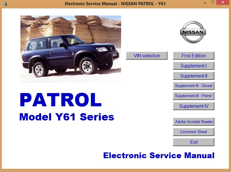

I would like to search for this text in the service manual I have but don't recall ever seing this much detail.
Do you know if the electronic manual you are referring to is different from the service manual.
This info is worth gold. :thumbup:

Hello Bruin Beer
Dit is hierdie een - Supplement III : ESM
