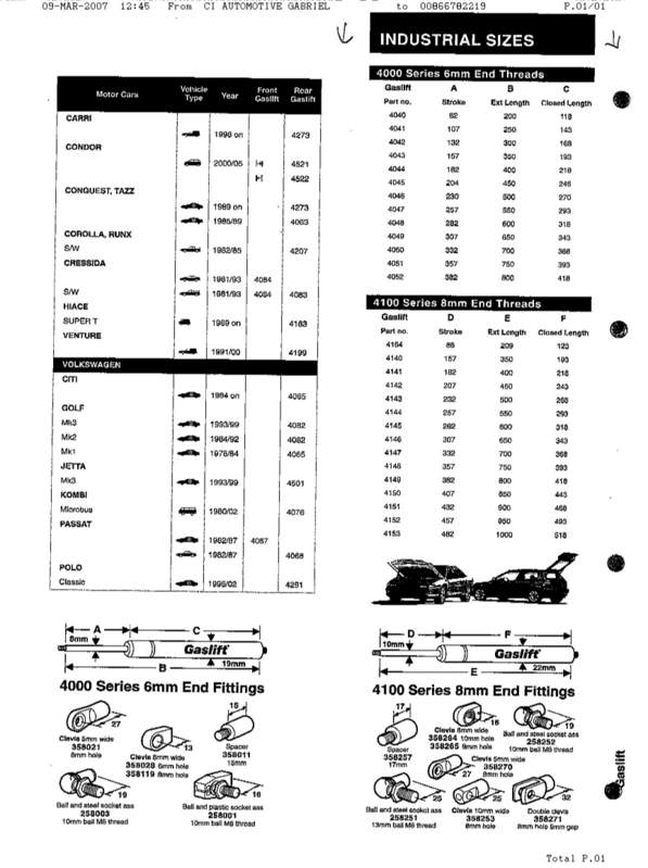

The pressure in the gas lift can be increased, but not decreased. They force air past the seal on the rod. Start with a light pressure and increase as necessary. If I can remember correctly you can specify the Newtons it must push.
Here is something I once got of the net:
Hope it helps

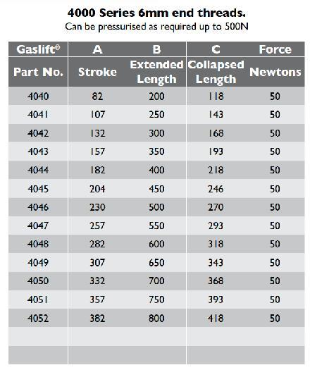

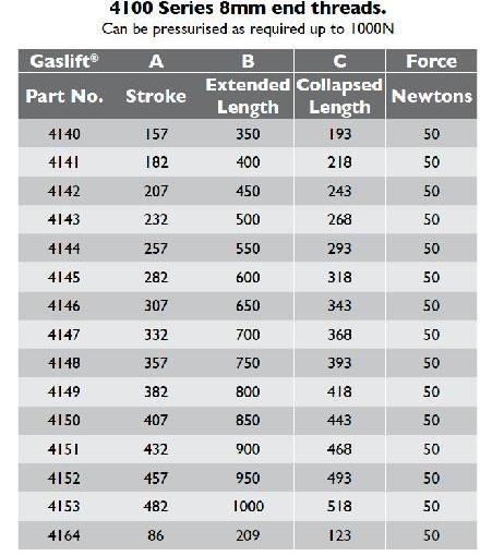

I am a bit unsure which is the correct gaslift to use in my GU Pickup. :think:
Some recommend 4141, some say 4043. My 4.5 got 4041's..(Gabriel Gaslift).
Does it make so much difference? Will they all fit?
I ordered some 4141's - hope they will fit...
http://gabriel.co.za/wp/?page_id=210
gaslift 4100.JPG (40.97 KiB) Viewed 4370 times
gaslift 4000.JPG (37.77 KiB) Viewed 4370 times
Been thanked: 432 times
Re: Gas Lifts on Bonnet
Al twee sal pas Fanus, die 4141 maak net verder oop as die ander een. Ek het 4141's in en hy maak so groot oop dat ek in die engine bay kan in pas.
Pomp hom 400Nm en hy is perfek

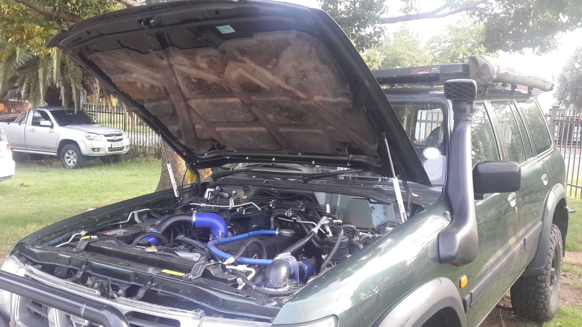

Gabriel Gaslift 4297 onder Chuck se bonnet.
Geen ekstra druk bygesit nie, maar hulle kan bietjie langer kon wees want hulle lig nie heeltemal so hoog op soos wat ek sou wou nie...

This is how far the 4141's open
