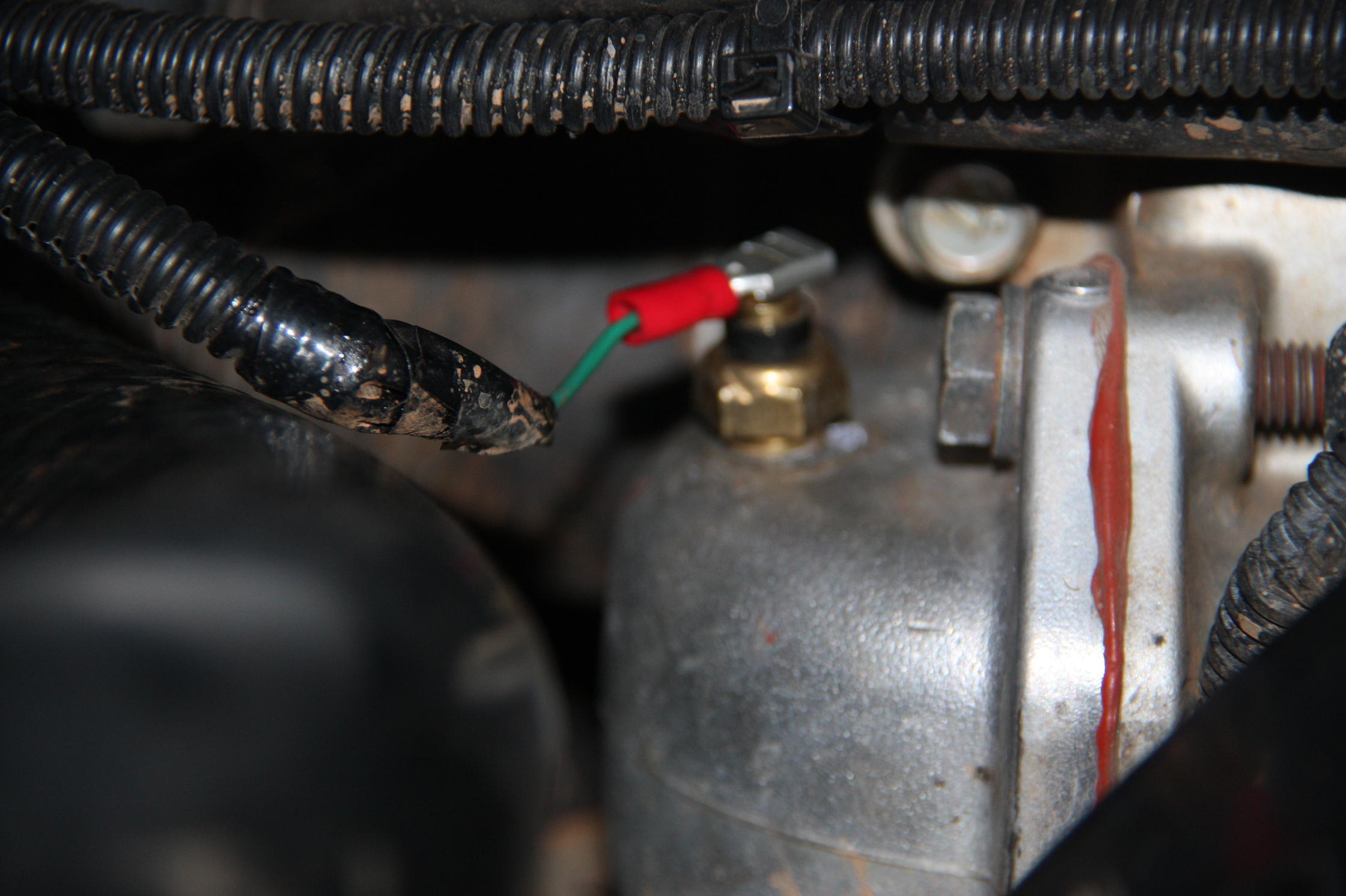

Well according to Myngardt, there is a wire inside (in contact with the water) so they must have drilled through the casing. I have attached a photo of the coolant sensor, followed by I presume the boost sensor, and lastly the EGT sensor. I apologise for the poor focusing but you can all see what the installation looks like. (The EGT sensor is too difficult to get to, it is installed in front of the turbo, and the photo was taken sideways - sorry I should have rotated it!)
- You can see how the probe is attached to the casing of the thermostat.
- IMG_0636(1).JPG (277.91 KiB) Viewed 2037 times

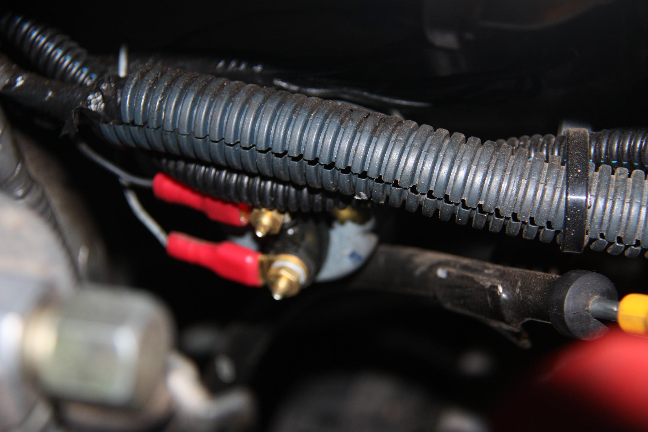

- This I assume is the boost sensor.
- IMG_0637(1).JPG (276.67 KiB) Viewed 2037 times

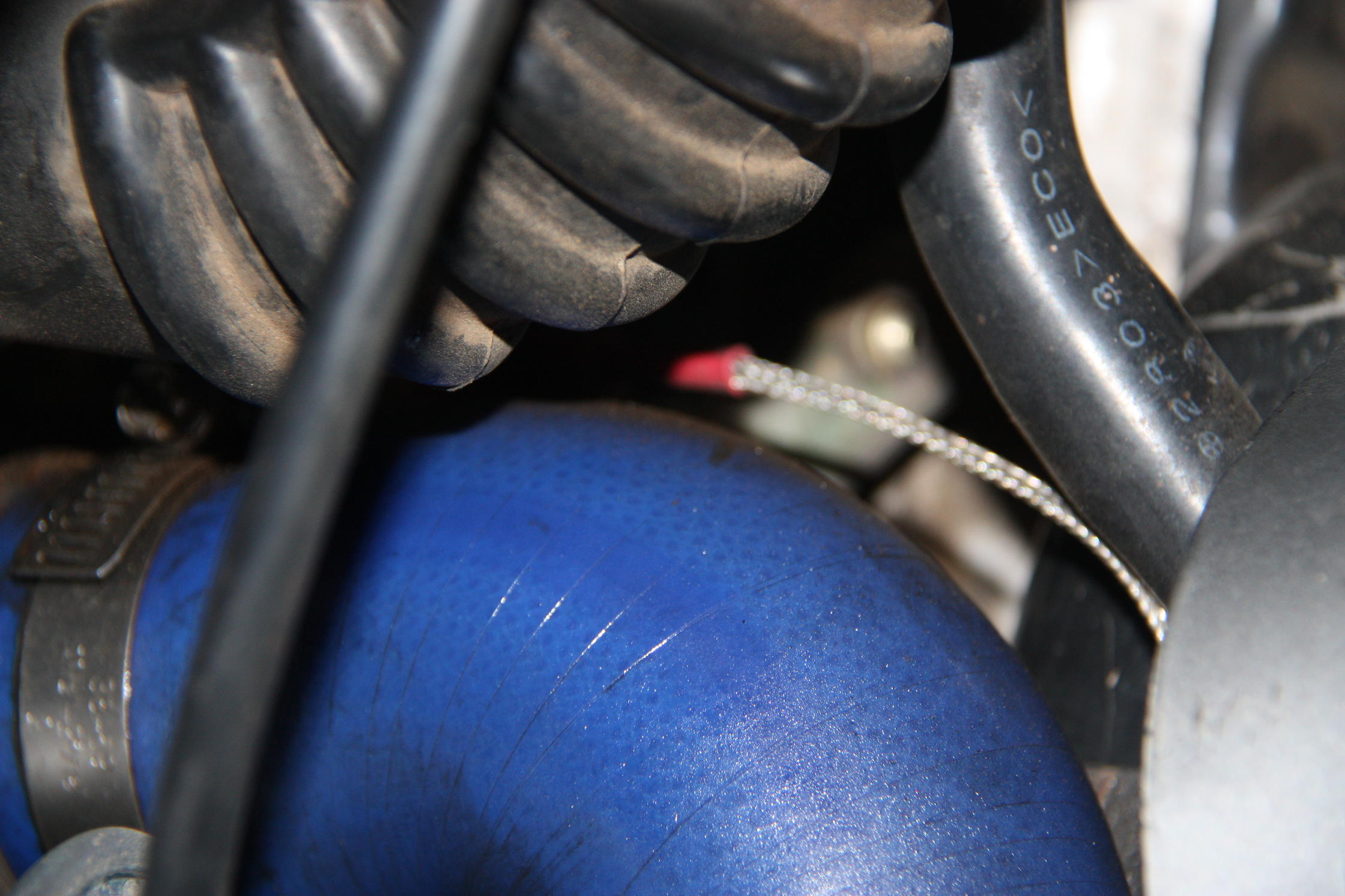

- This is the EGT sensor / probe before the turbo. (Pic should be rotated - sorry).
- IMG_0639(1).JPG (318.81 KiB) Viewed 2037 times
Re: Madman not compatible with Patrol??
Hmm... ok my theory is out the window.... that water sensor looks like it is the correct set up. Must be a bad earth
.... What if you ran a wire from the negative on the battery to the body of where that sensor connects to. Maybe onto that bolt where the red gasket sealer is. Then drive around and see if there is a difference. Not sure what size wire to use though
Cedric,
That was where I was going.
There is a ground issue between the engine (reference point for all the input sensors) and the Madman ground (measurement ground) which I would guess was connected somewhere inside the car close to the Madman installation.
I would suggest un-doing the Madman ground and connect that to the engine (or bolt described by you).
Test and verify.
Hope this helps
Bruin Beer
