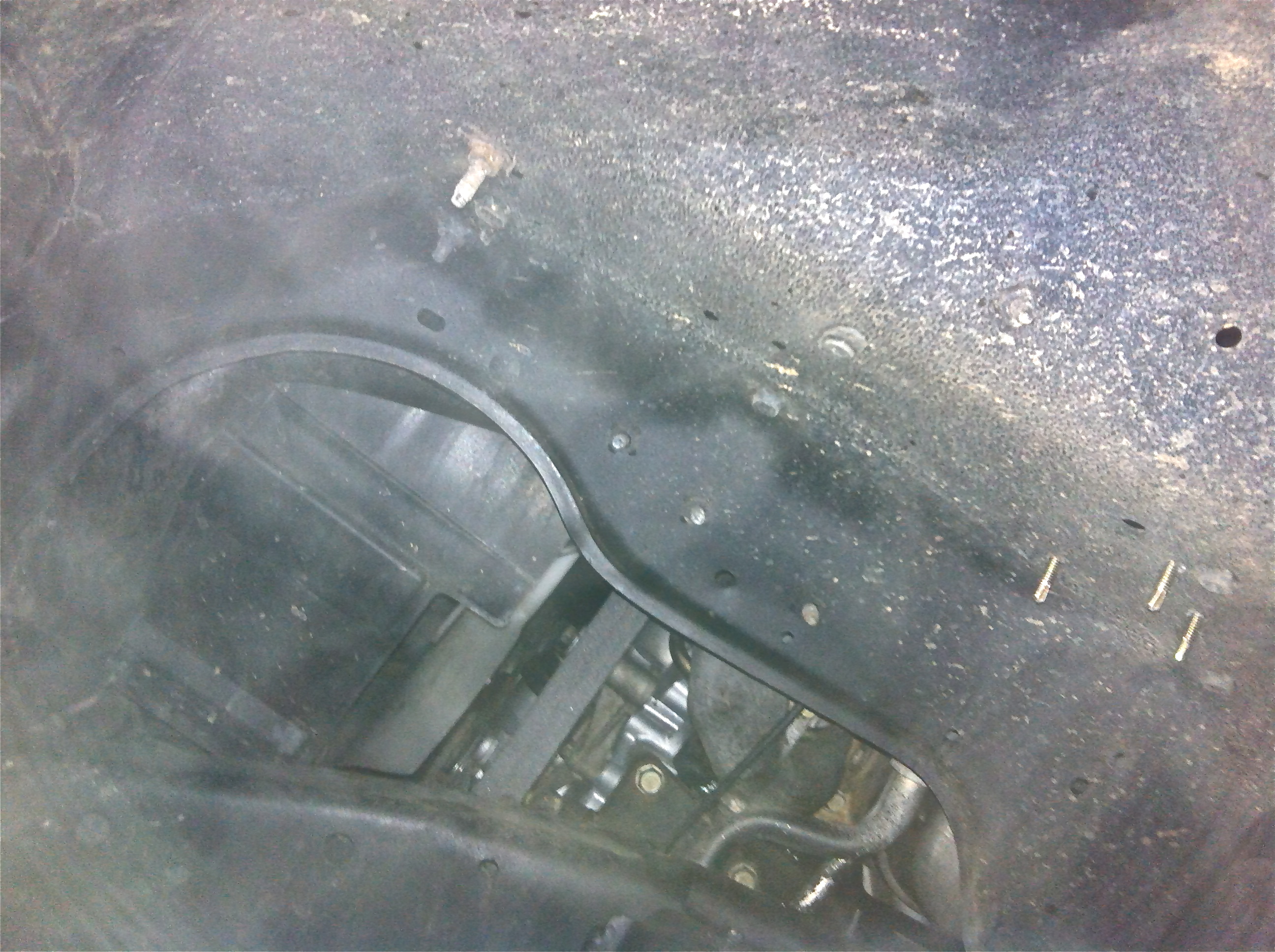

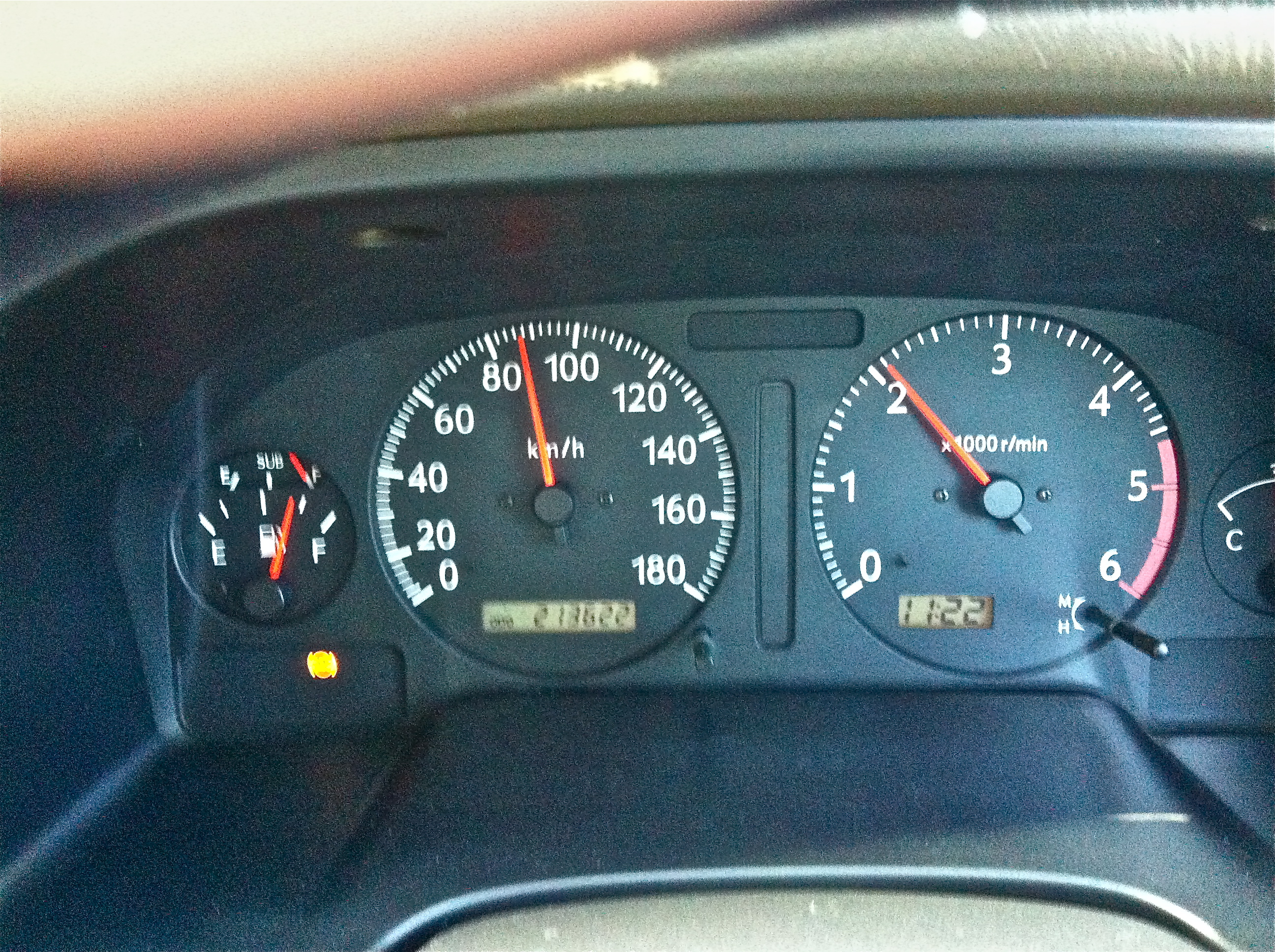

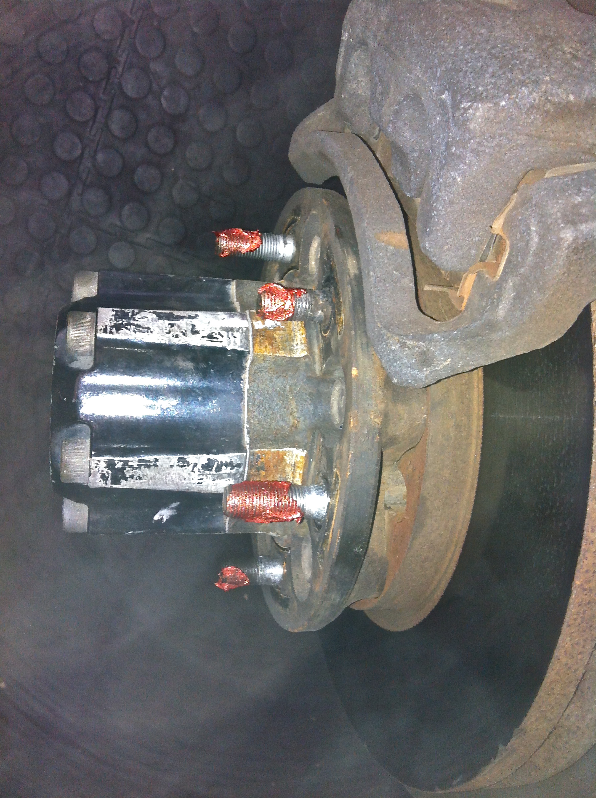

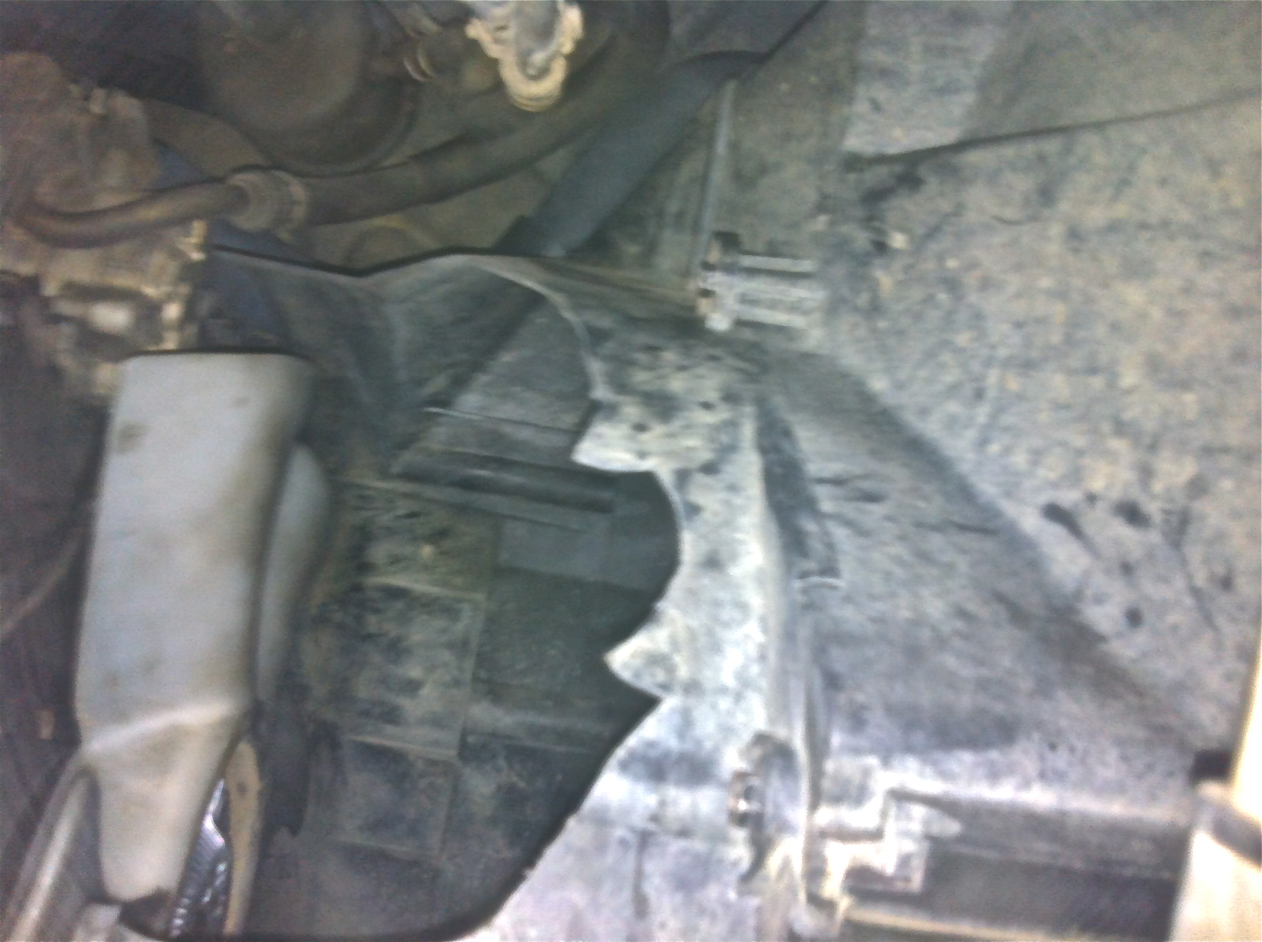

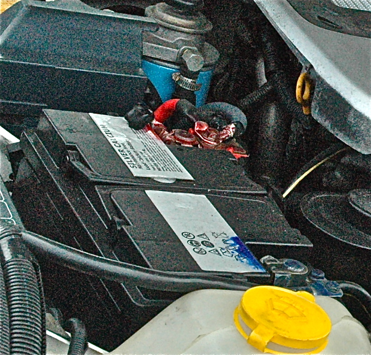

These are the list of problems found, on first inspection, after receiving the Patrol:
Included in this list is (though not shown), are the 3x (of 4x) aircleaner clips that are missing,the refund of the roadworthy test fees and an exhaust that has "blown", after only 800km of ownership...
As I've said, It's not an insurmountable list, ..... Just one that is "YET TO BE ADDRESSED, by the Nissan Dealership....
I'm considering all options at present, but want to return Patrol, only as a last resort, if possible.

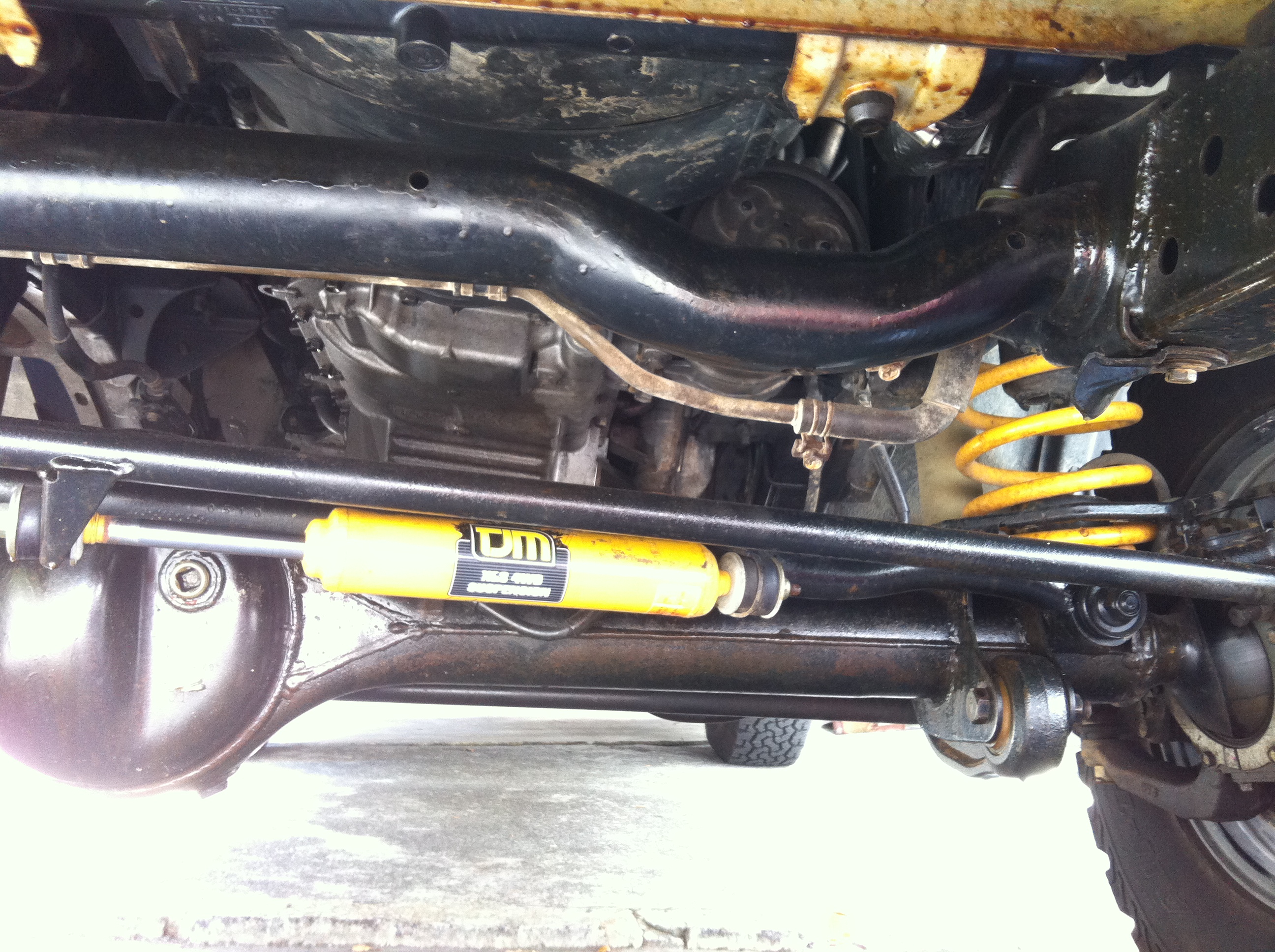

So far, this is what SHE looks like .... and I think SHE'S worth "opening up a can of whip-ass for" ....??
I'll keep you's posted on the progress, AND, like I said before, if proven wrong / or all is "SORTED" ..... I'll eat humble-pie

Remember that according to the consumer protection act, you only have a limited time to get a full refund.
If you are determined to keep her, better be prepared to fix her yourself and try and reclaim (sue) for the monies
1. Re the ABS light, this is what the service manual states:
>When the vehicle speed is less than 10 km/h (6 MPH) this system does not work.
>The Anti-Lock Brake System (ABS) has a self-test function. The system turns on the ABS warning lamp for 1 second each time the ignition switch is turned “ON”. After the engine is started, the ABS warning lamp turns off. The system performs a test the first time the vehicle reaches 6 km/h (4 MPH). A mechanical noise may be heard as the ABS performs this self-test. This is a normal part of the self-test feature. If a malfunction is found during this check, the ABS warning lamp will stay on.
> While driving, a mechanical noise may be heard during ABS operation. This is a normal condition.
> While DIFF-LOCK is on, the anti-lock brake warning light flashes. This indicates that anti-lock may not be fully operated. (ABS only)
From the service manual, it seems that there is quite a comprehensive error guide that the guys with the computers can check, so like always, have them test and isolate the problem before just starting to replace components.
I have no idea what this may cost, so I guess you'll have to budget for the R5K they estimate. (I would take it to an independent though)
2. The battery holder should be generally be available
3. Have a search on the forum, can't think that studs would be impossible to get hold of.
4. You're going to have to spring for a new cowl cover. I doubt that they will be generically available and Nissan is going to charge like a wounded buffalo. (Unless you want to fix it with fibreglass, or see if you can get one from a Patrol being broken up for spares)
5. You can cut some debris skirts from conveyor belt.

WRT the faults on your car: I doubt that the fender skirt will have any effect on operation or performance. The wheel studs can be sourced from a decent fastner supply shop, but it's quite a big job to fit them. The fan shroud will cost you a couple of grand from Nissan SA, but if you can find somebody who travels to Arabia for business they can be had for much cheaper over there. Or try Jean Volschenk on this forum, he has recently stripped one of those for parts.
The ones that worry me are the exhaust (which I would take to a normal exhaust shop), and more importantly the ABS.
I reckon your first usefull steps will be going to the ombudsman with all your correspondence, and thereafter the threat of legal action...
