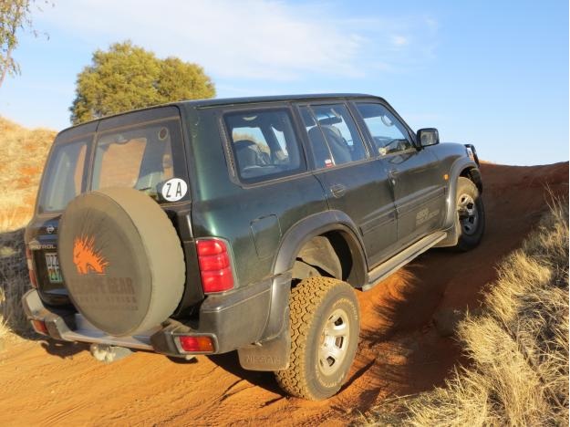

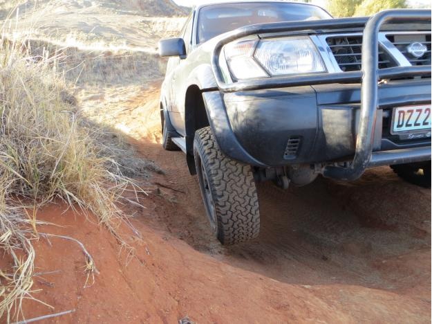

Hi
Yesterday I had some time to go and test the new Bilstein shock off-road. Here are some pictures of the travel I have on the suspension.
I must say that the ride quality of the car is much better now. It is like a different car. On the open road the handling is very good and off-road it is nice and comfortable with good feedback.
The nice thing is that they are already painted yellow.
