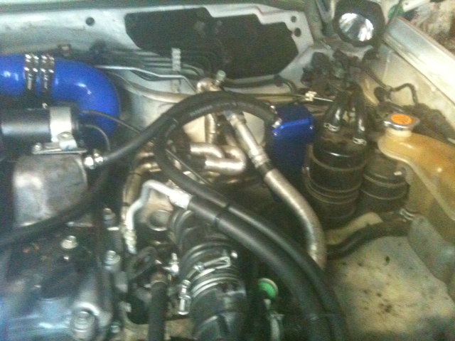

May I pretty please get some advice whom I can speak to, to help me install an oil catch can and fan like that, very urgently?

When I have the catch can, where in which line do you tap into for the can?
How did you guys mount the can so it does not rattle loose in the engine bay?

Mailed you some pics , feel free to reply or even pop through one day and come see how i did all of mine

That catch can is very neat. Dirko does yours look the same?
I want one 2 but my technical knowledge is not there yet to do it myself so info on where and how will be great.

Mine is exactly the same yes ,
The can itself you buy and immediately throw away the pipes it comes with they are useless , get proper piping - simply remove your breather pipe form the tapper cover to the air cleaner replace with the new longer pipe and place this inline
I will try to take clearer pics tonight but here is one of mine
