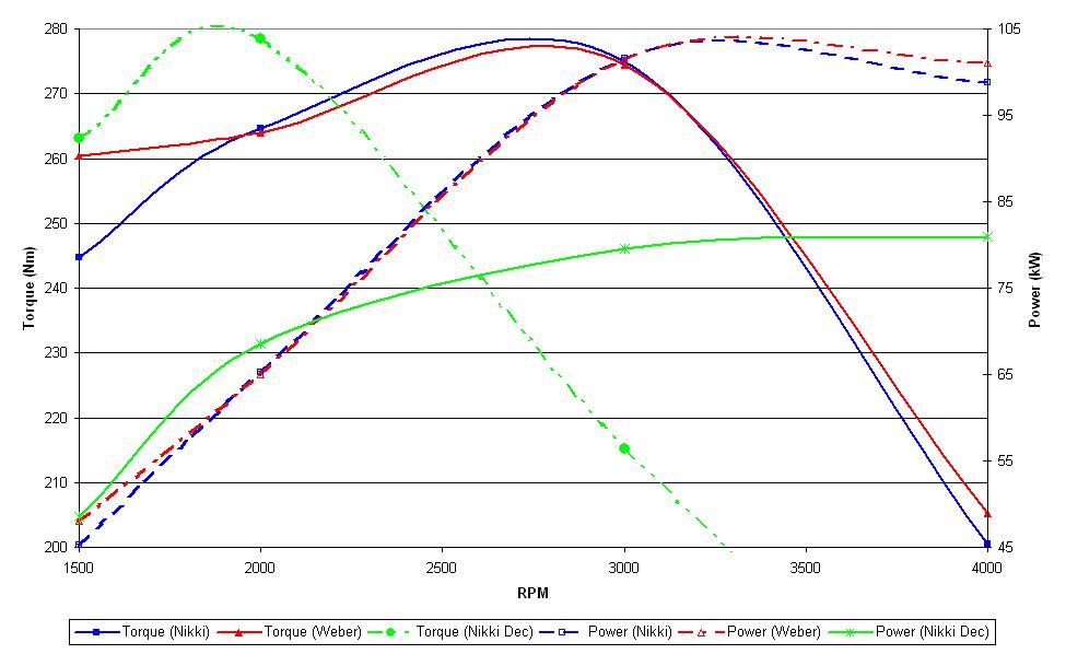

For interest I have put this graph together comparing the power and torque for my Patrol previously and currently.
The blue lines was a dyno test done in August 2010.
The green line was a dyno test done in December 2010 when things start to go wrong, before the Weber modification.
The red line is a dyno test done on Friday afternoon "as is" with no tuning. The ambient temp. where the test was done was 45deg C, I dont think this is ideal to get a true reflection of the power available, as the Patrol is much more responsive and where I used to gear back on inclines from home to work I can now stay in 5th gear. I think there is some room for improvement with a good tune-up but are more than happy with the performance as is.

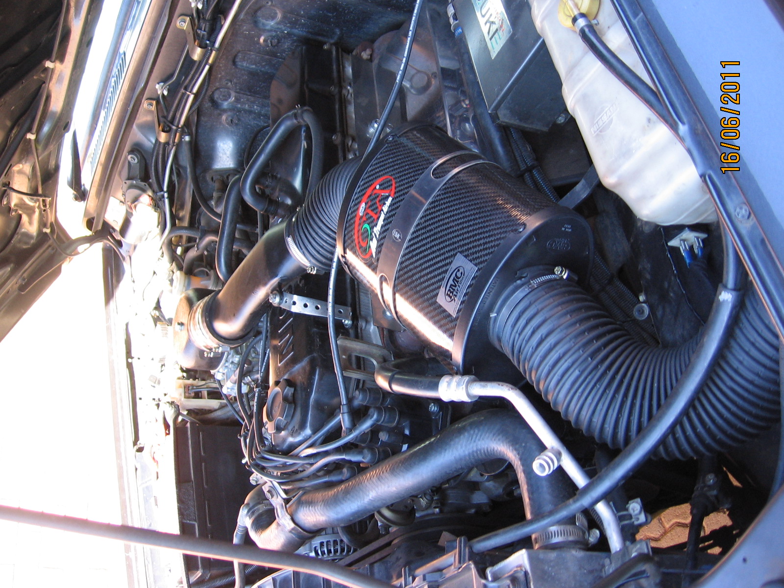

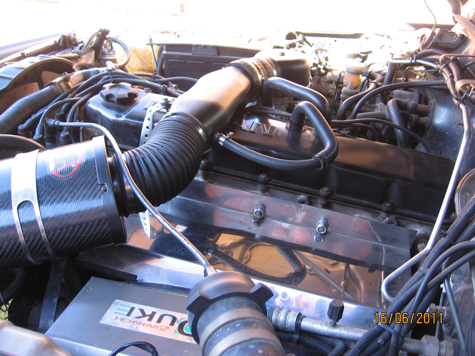

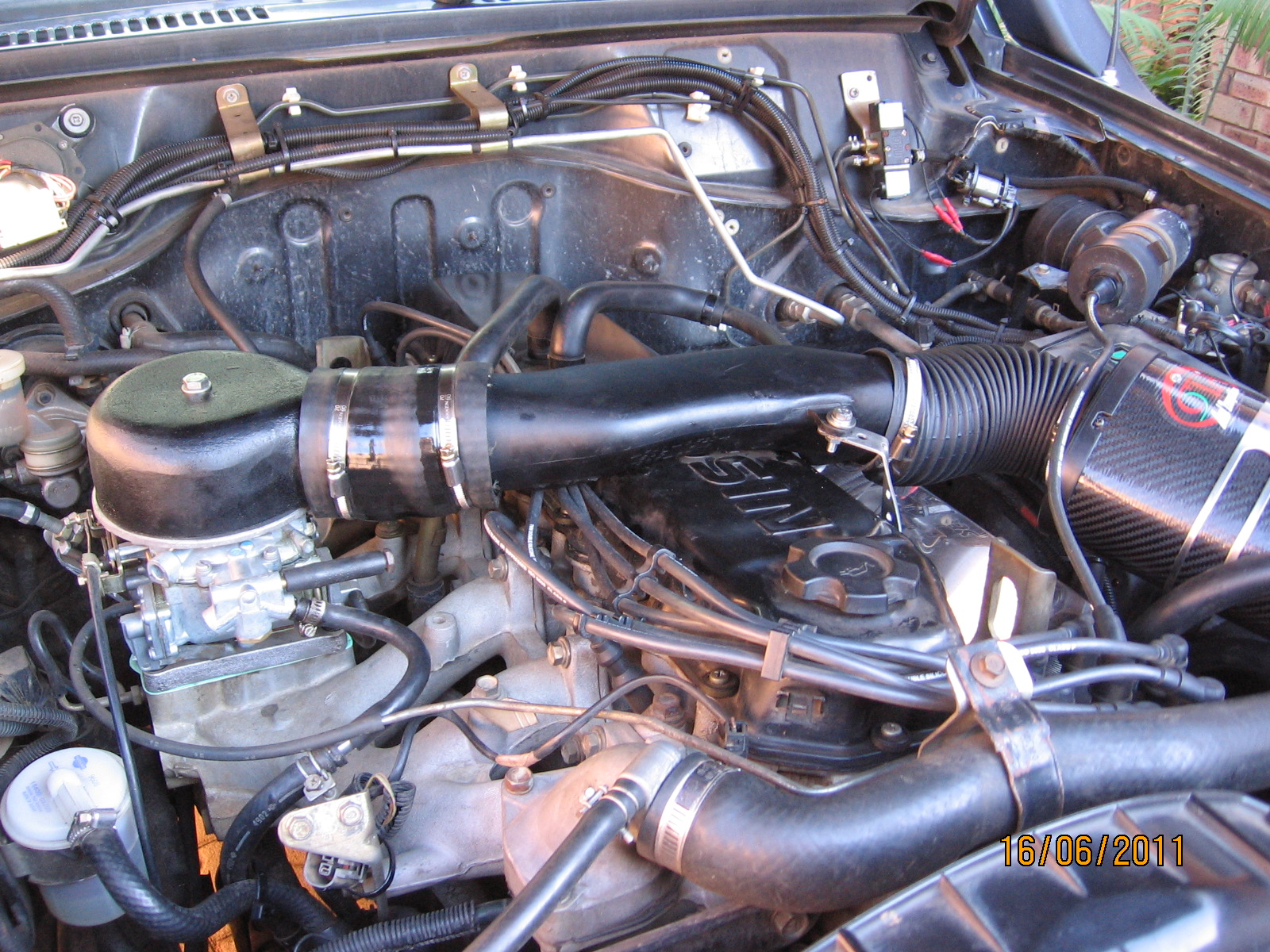

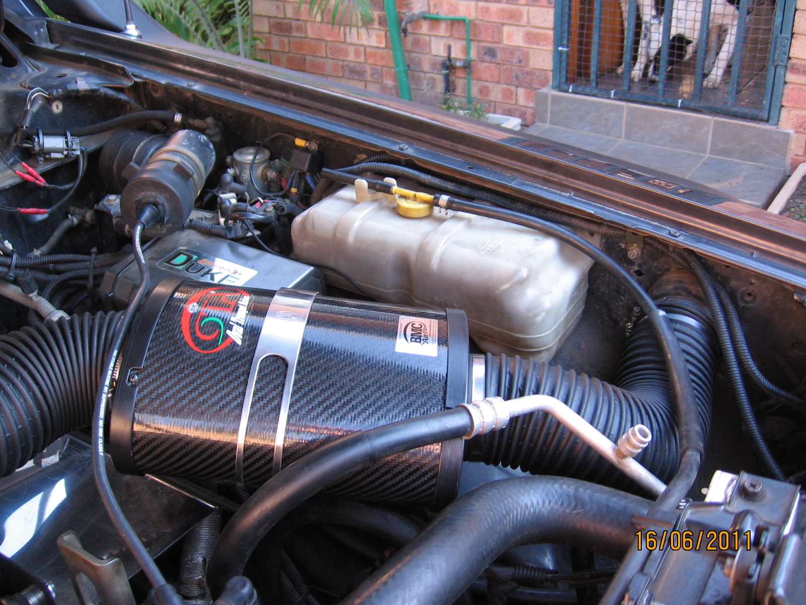

After months of searching high and low for an air cleaner box to fit into the engine bay to connect the weber carb with the snorkel the end product looks like this (pictures attached). My first choice was to find an airbox from a TD42 or ZD30 which bolts in nicely into the Y60 engine bay with no mods necessary to mount it. But these airbox is hard to find second hand and new from Nissan is just too expensive. The second option was this Oval Trumpet airbox which is available aftermarket. The carb plenum was sourced from Carb City in Pretoria. Attached is a few pictures. Enjoy.
- Foto 007.jpg (602.69 KiB) Viewed 2508 times
- Foto 004.jpg (641.26 KiB) Viewed 2508 times
- Foto 003.jpg (741.37 KiB) Viewed 2508 times
- Foto 001.jpg (632.75 KiB) Viewed 2508 times

Baie Mooi Rudolph
What is your fuel consumption now, and what was it before?
Thanks
Thanks

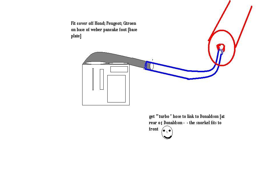

Now oompie thinkx - if you can get a-hold of one such - fit that to the webers pancake base - get one of the blue hoses for turbos in the right angles - OR get Noize Boyz to make you the pipe [R100] - and then link to Donaldson & snorkel ... can be done [Lobo runs with donaldson ... it must mos work in your Troll too ?

Dankie Peter,
Will check the fuel consumption over the next few fill-ups. Needs to get a good tune-up again as well and hopes for some improvements.
Dankie Oom Mac, vir die deel van jou kennis en voorstel, maar dit is nou hoe hy gaan lyk en werk vir nou.
Cheers
Rudolph
Cheers
Rudolph

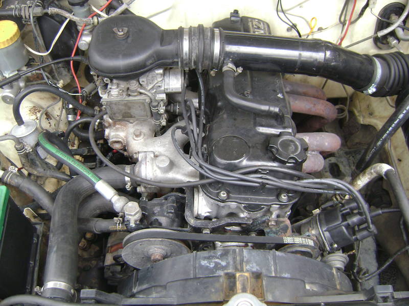

Hai Rudolph - Ek sien nounet - die 2,4 Nissan HighRider carb modelle het presies op wat jy nodig [SCRAPYARD ... hier kommmmmm Rudolph] Ek het R300 betaal vir die Donaldson 'box' by One-Tonner Spares in Pta Was [Mitchellstraat] -
die ding lyk so:
die ding lyk so:

Ooooooooooooooooooohhhhh - slattik nou my naampikjie me 'n moederma se plank !!! - ek het jou posting van jpou oplossing gemis - maar nouja, iemand anders wil dalk dieselle doen - dan het hulle dieantwword ook.
Bakgat oplossing daai wab jou Rud - en ek HOU vad die fibre box -- bly koel en gee dus ook koeler lug deur. Mooi man.

Dankie Oom Mac,
Sorted out the timing and the air mixture this morning, now I can check the fuel consumption. The engine response is very nice on high driving, as if the engine is breathing alot better.
