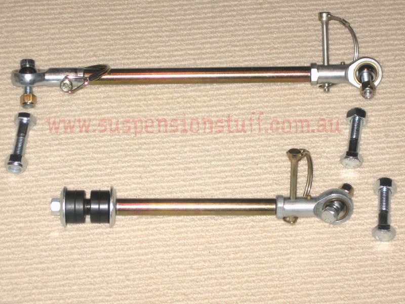

Below a pic of after market disconects. I am having some made for my Troll. I already have some extended bump stop for the rear in but want to increase the articulation on demand.
- GU%20Sway%20bar%20disconnects%20800%20web.jpg (121.64 KiB) Viewed 2347 times

It looks like my prayers have been answered!Grant wrote:Below a pic of after market disconects. I am having some made for my Troll. I already have some extended bump stop for the rear in but want to increase the articulation on demand.
Is the fabricator taking orders? How do you get the necessary cables for hooking it up?
