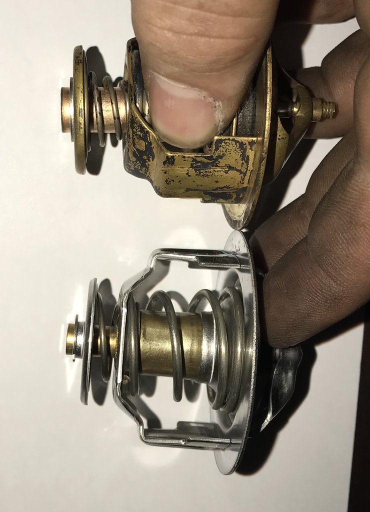

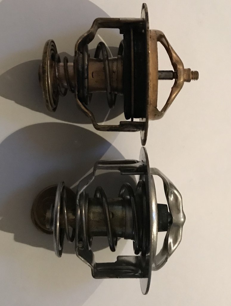

Sorry for all the questions gentlemen, I got the Nissan Thermostat today bit its shorter than the one that I removed. I am not sure if the old one was a Nissan part or fong kong so not sure which is correct.
Would you guys please advise.

Nope, looks good.
The old one is a non Nissan thermostat

Just check that it does reach that bottom seat!
