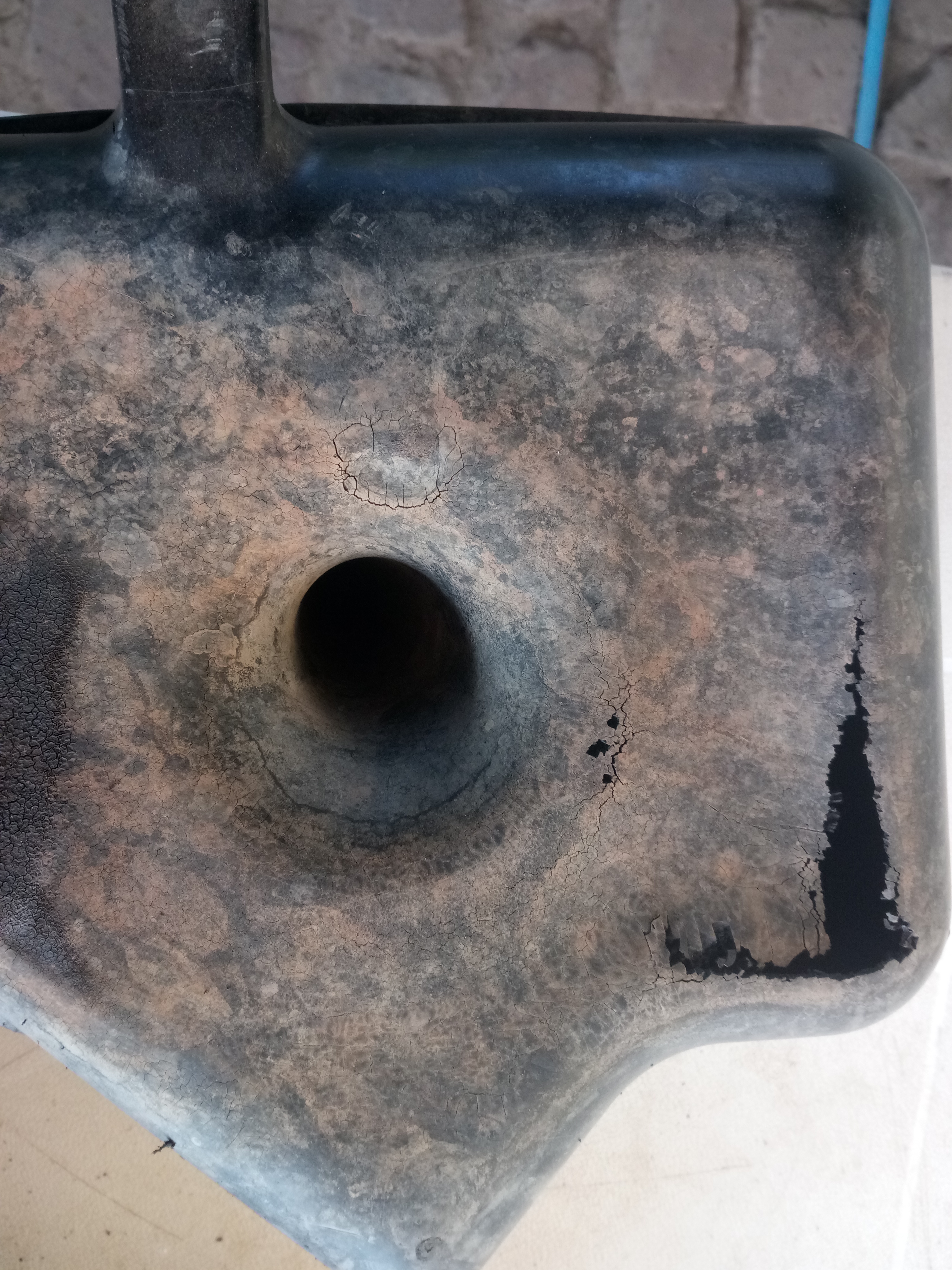

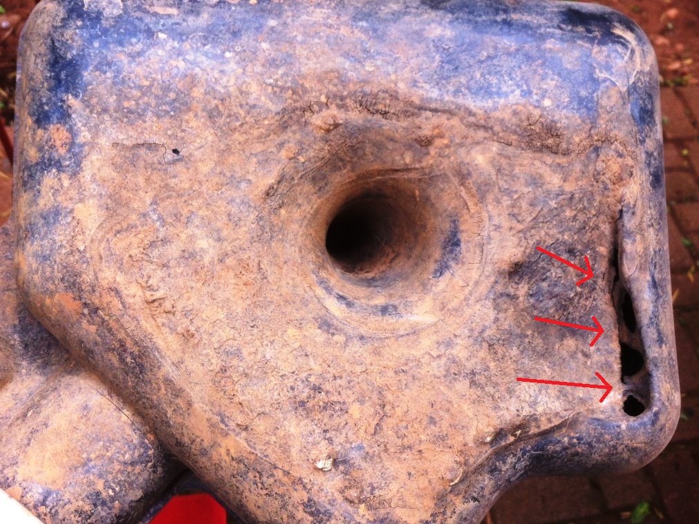

For a couple of years now my 4.5 has been running rougher and rougher and suffering from some bouts of pinging.
Have done all the tried and tested stuff like removing chip, replacing PCV valve, etc etc etc. These things have been discussed in depth before.
Took it to Graham the other day and after swopping MAS sensor and distributor among other things discovered this;
IM under resonator.jpg (3.73 MiB) Viewed 9084 times
Would seem that over the years the heat from aftermarket branch manifolds has slowly caused the underside of the resonator box between the air filter and intake manifold to melt allowing air in after the MAS sensor.

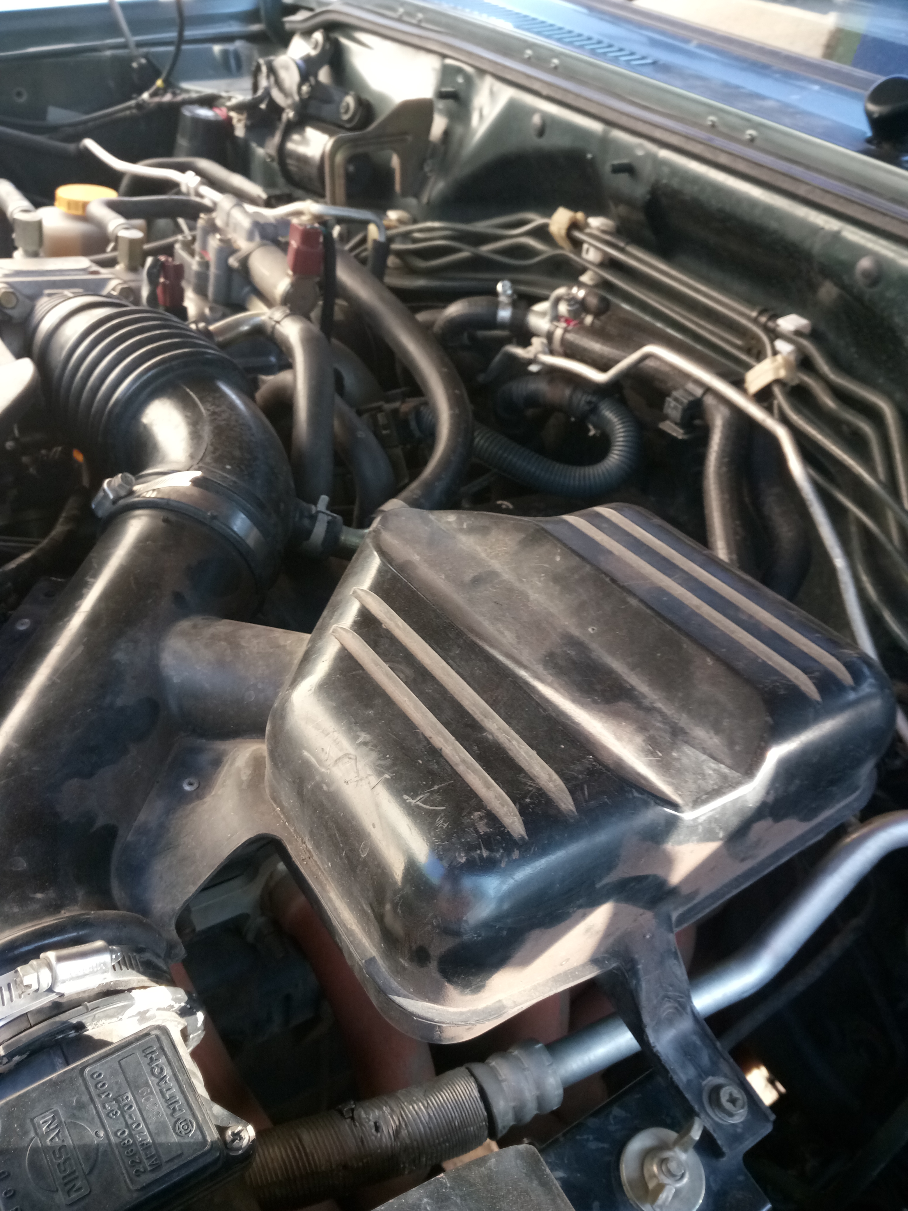

IM original.jpg (3.01 MiB) Viewed 9084 times

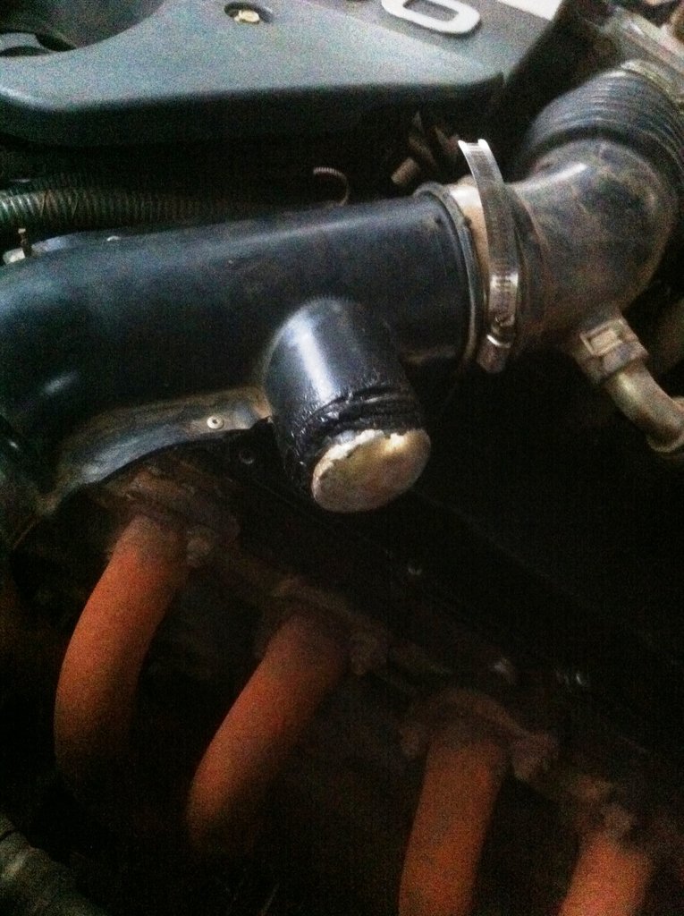

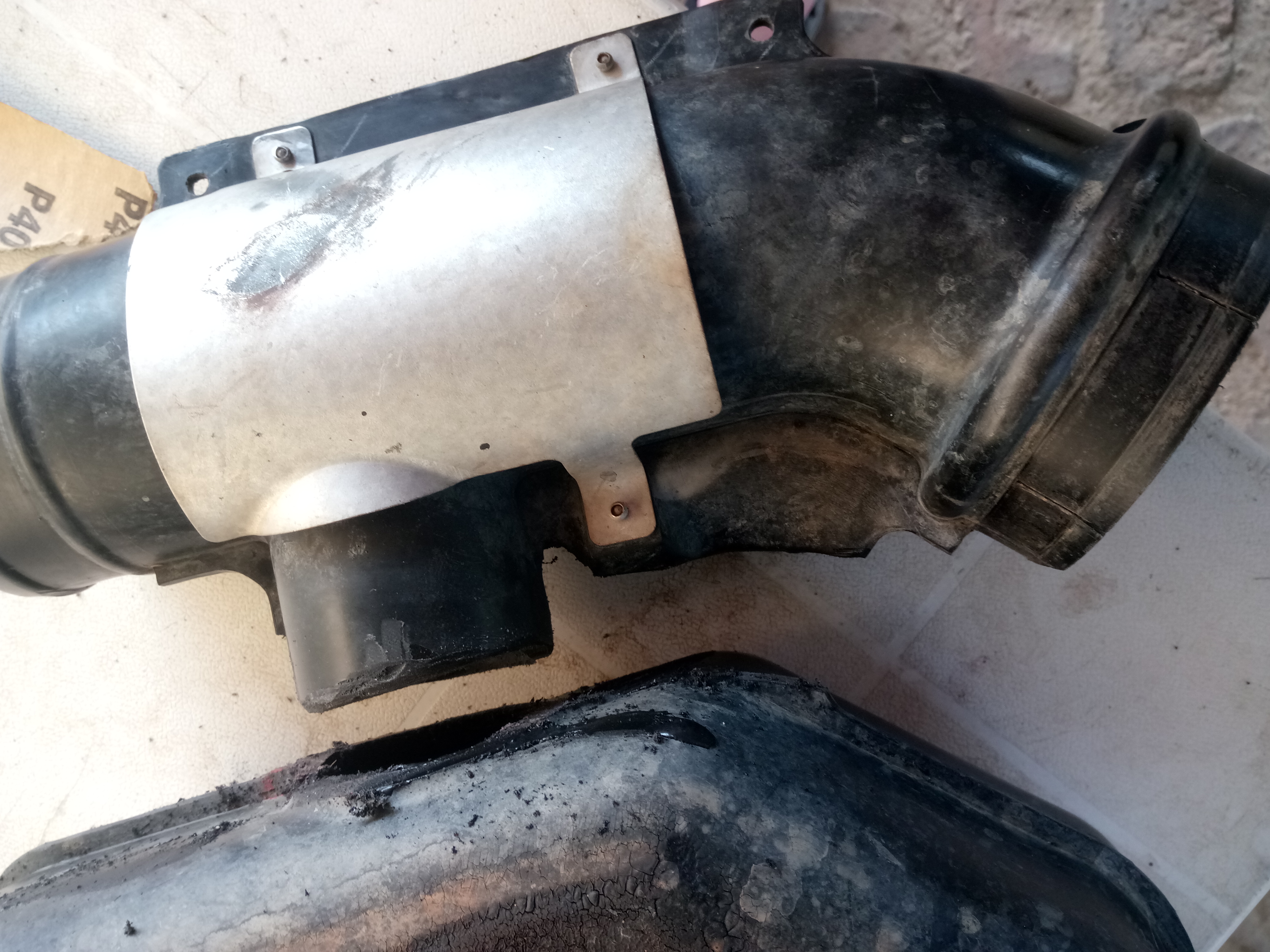

Borrowed one from Graham for the meantime but I can see no reason for the box so here is what I believe to be the solution;
1. Cut the box off of the intake pipe
IM cut.jpg (2.85 MiB) Viewed 9084 times
2. Seal the hole

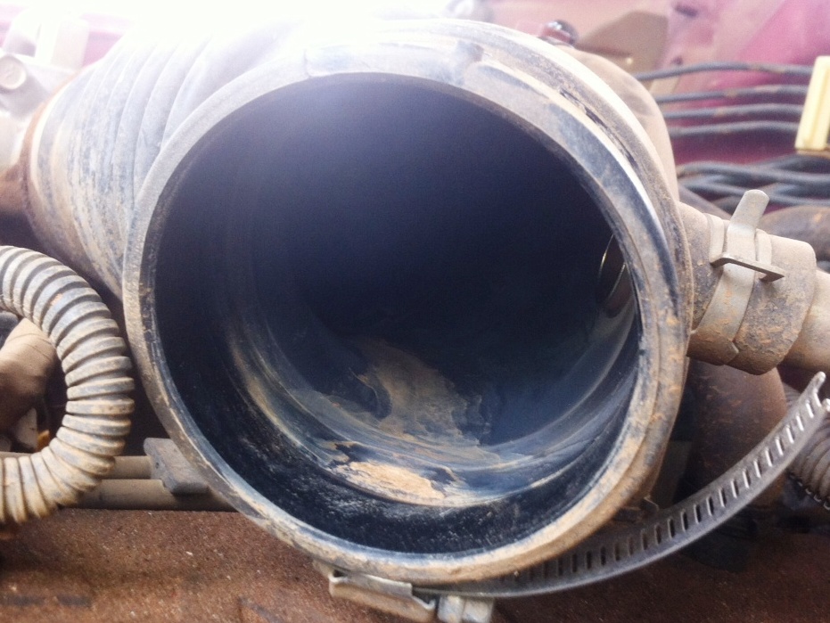

IM plugged.jpg (2.36 MiB) Viewed 9084 times

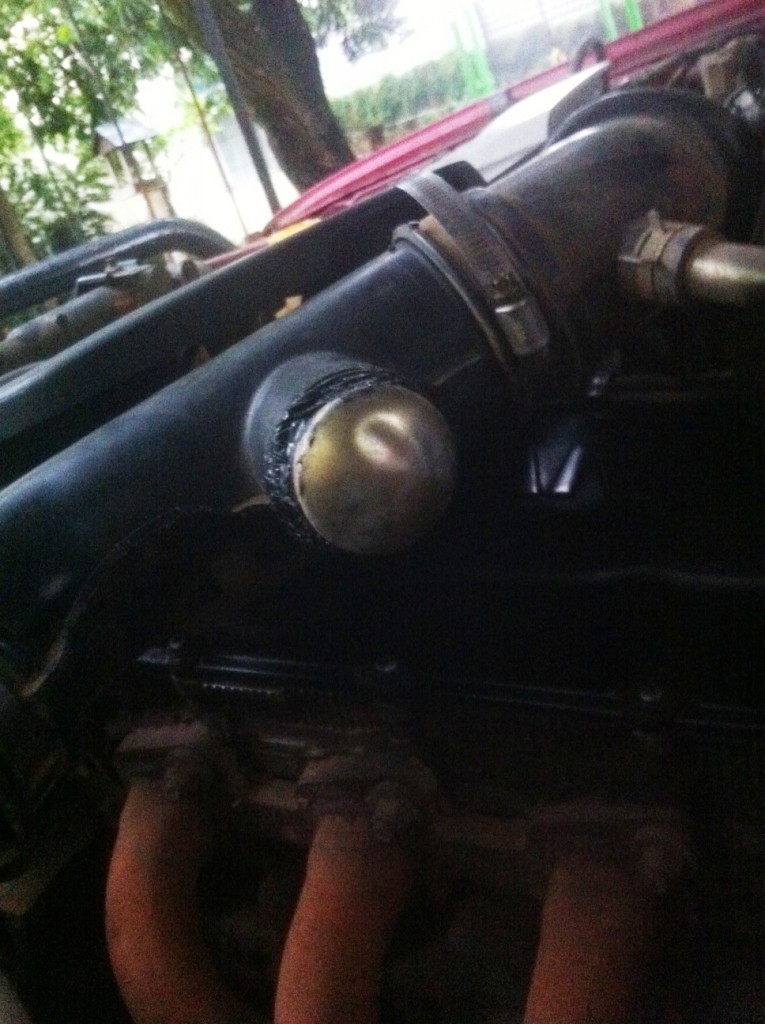

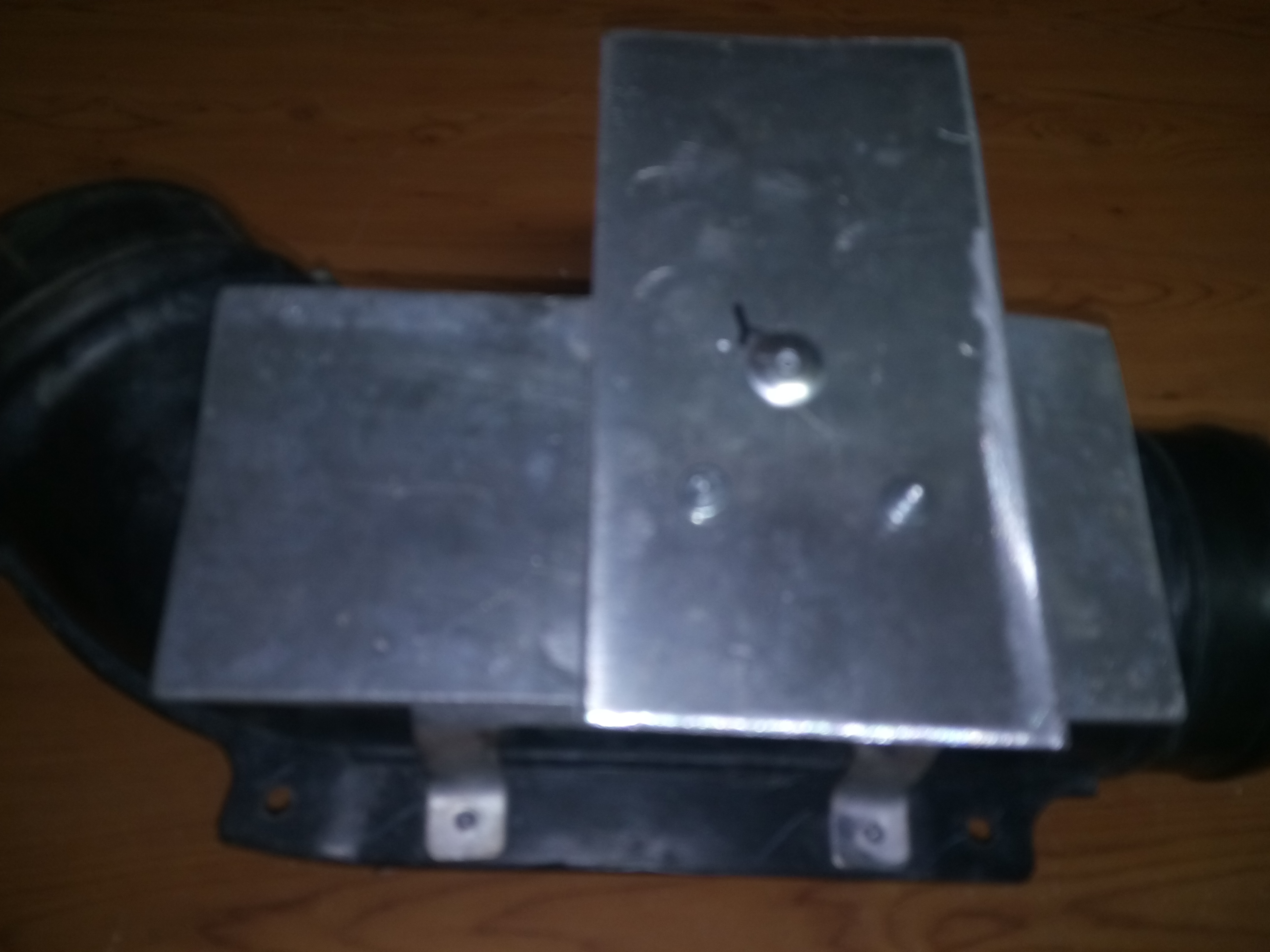

3. Add additional heat deflection
IM heat deflect.jpg (2.09 MiB) Viewed 9084 times
Will fit this weekend and see how it goes.
Moral of the story - If you fit or have aftermarket branch manifolds, ceramic coated or not modify and retain the heat deflection over the manifold.

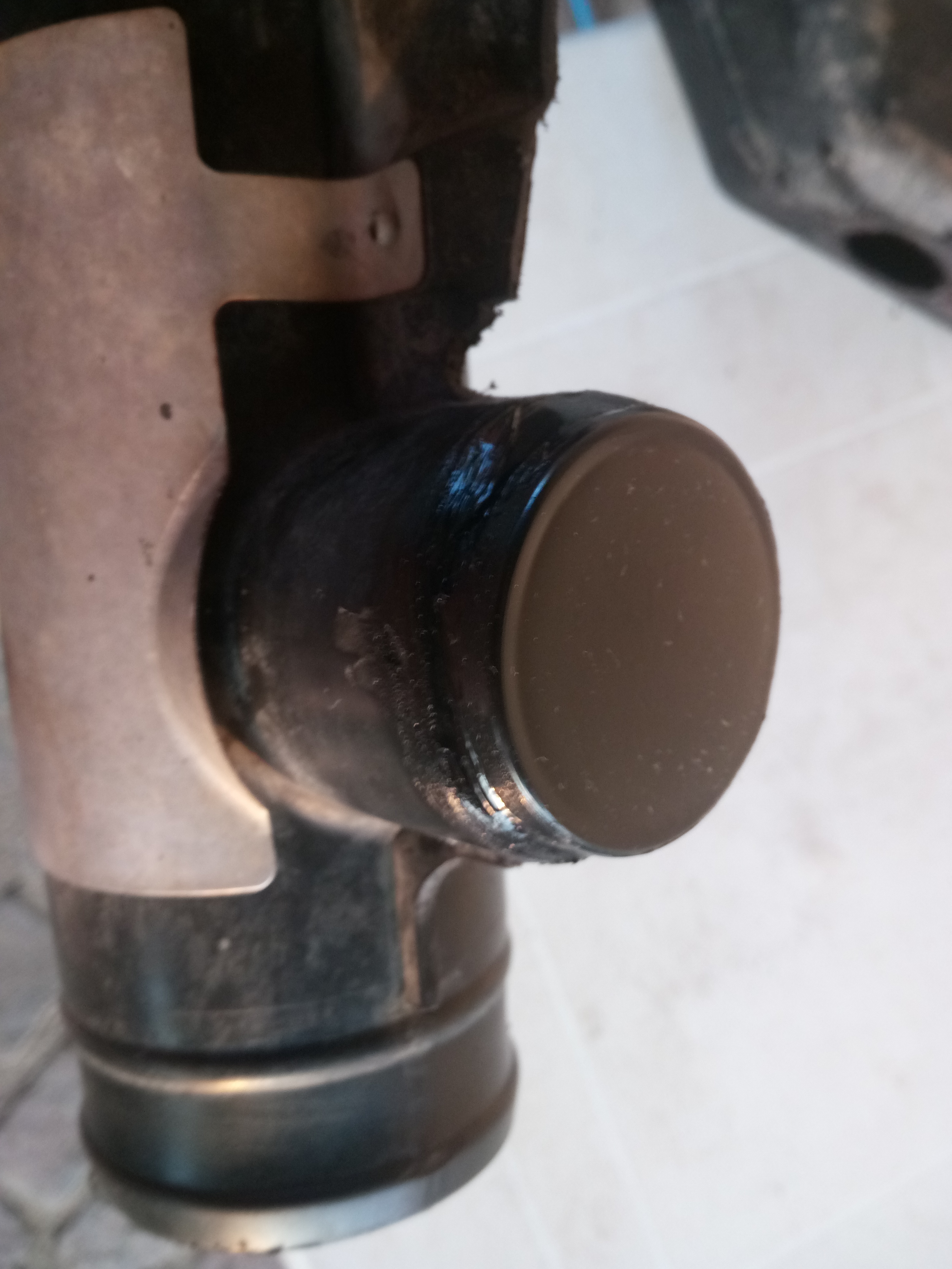

I took my 4.5 to Graham to have a look at it back when I bought it, he still warned me about this...
David what did you use to block the pipe of (where the box was cut off).?
Was busy today changing oil and inspecting condition of air filter..... also discovered a hole.
photo 2.JPG (398.41 KiB) Viewed 8893 times
Quite a bit of dirt alsready got past air filter..
photo 1.JPG (216.35 KiB) Viewed 8893 times

To block the pipe I just went to the local hardware with pipe in hand and tried different things until I found a plastic cap that fitted with minimum modification and siliconed it in.

Could not find a suitable "plumbing cap" but found a grease cap that I made to fit. Was slightly larger than the inner diameter of the pipe.
