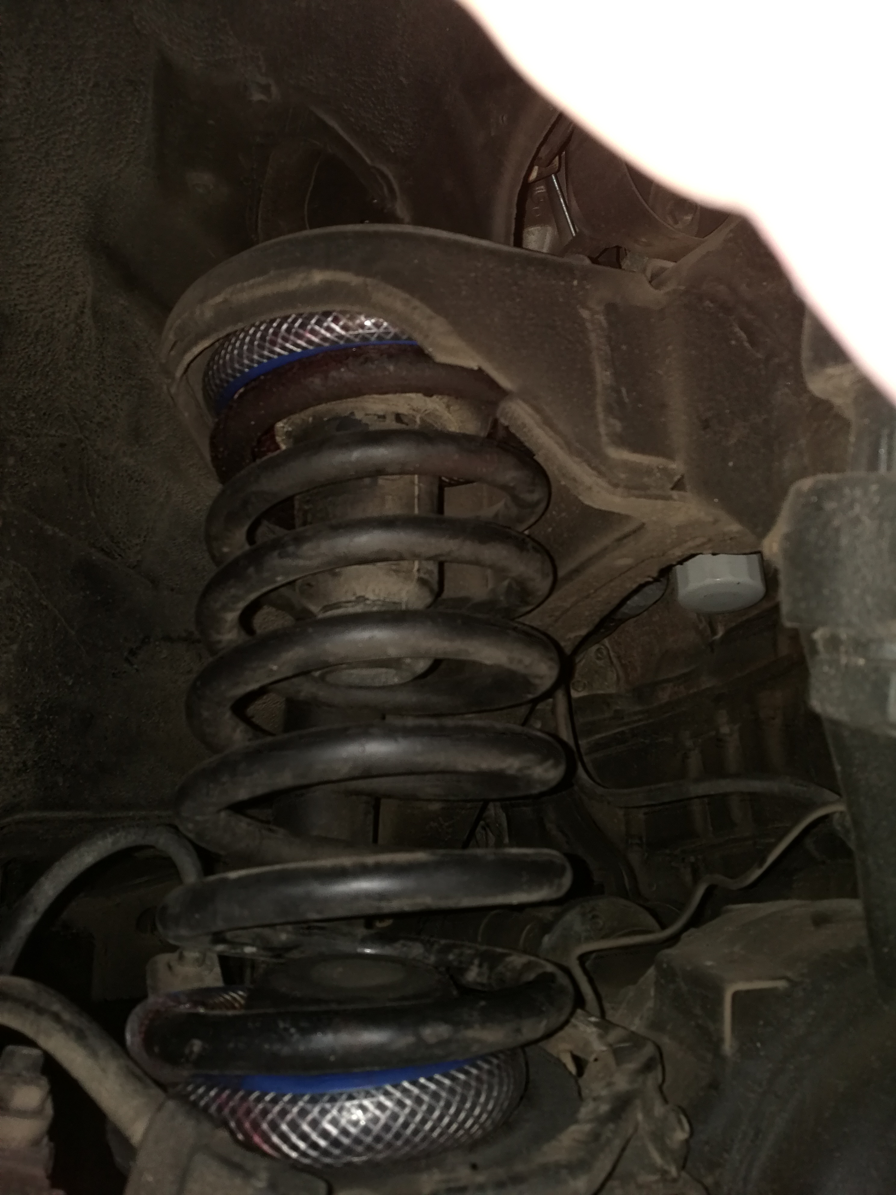

Hosepipe hey? Good one, thanks. Will try that on my hardbody :thumbup:

As n Hardbody se suspencion nie kraak nie is daar fout my Hardbody en sani het al twee gekraak as jy full lock gedraai het

The fix, and it works.
Voorveer 26 05 2017.jpg (2.73 MiB) Viewed 5901 times

That is a great idea!! Mine has been making some noises again recently, will do the same and see if I get the same result

Fitting progressive coils up-side-down will catch on the rubber bump stop and sound like a whale with a sore tooth
