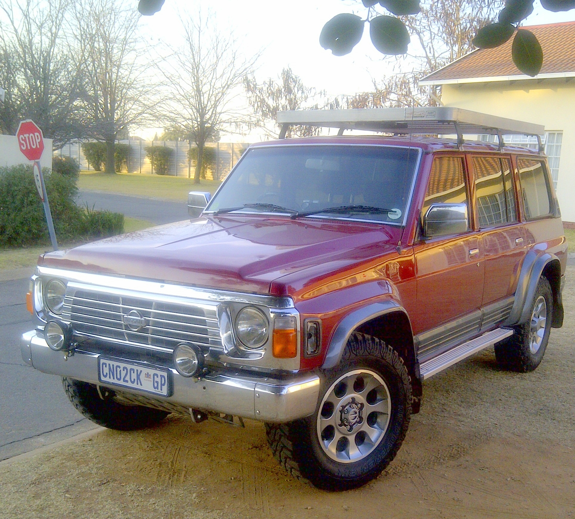

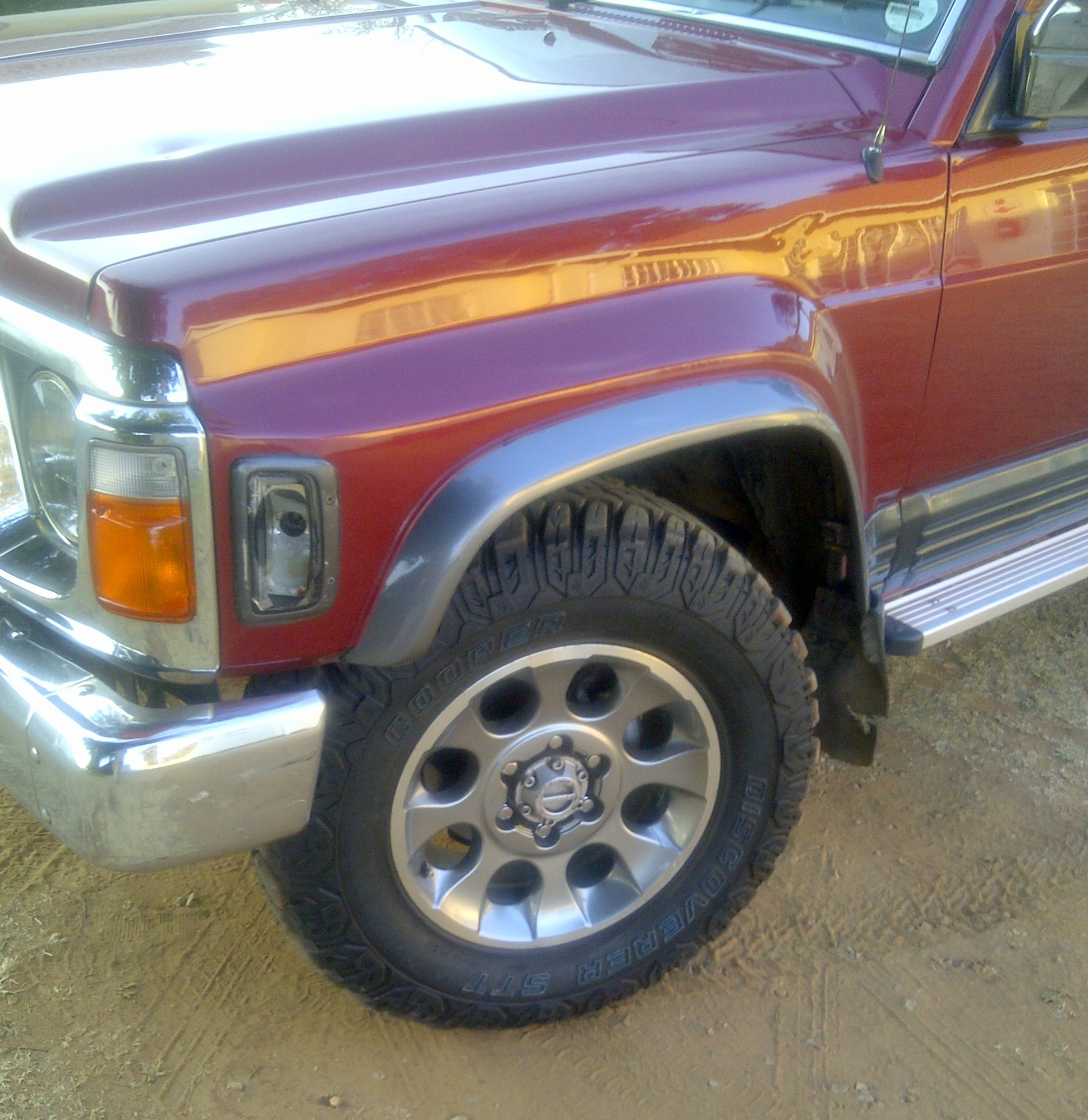

Doc Rod .. I had a set of Land Cruizer FJ rims machined to fit on THOR [my GQ .. now Andre Visser's GQ, the RED one]
I have yet to see more beautiful attractive rims on a GQ than those FJ rims [they are regularly on sale on Gumtree and OLX and such]
The PLUS is that they are 17" .. and these days you can get 17" tyres at MUCH better prices than on 16" [still sorry I swung from 17 " to 16" ]
I removed tha tyotta thingiez and replaced with NISSAN badges on die centre caps ..
OH yes, and NB NB .. the NUTS are the fal type .. you DO get the 1,25 nuts for those rims .. I baught my set at MALAS Tyres in Potgietersrteet, Pta [west]
