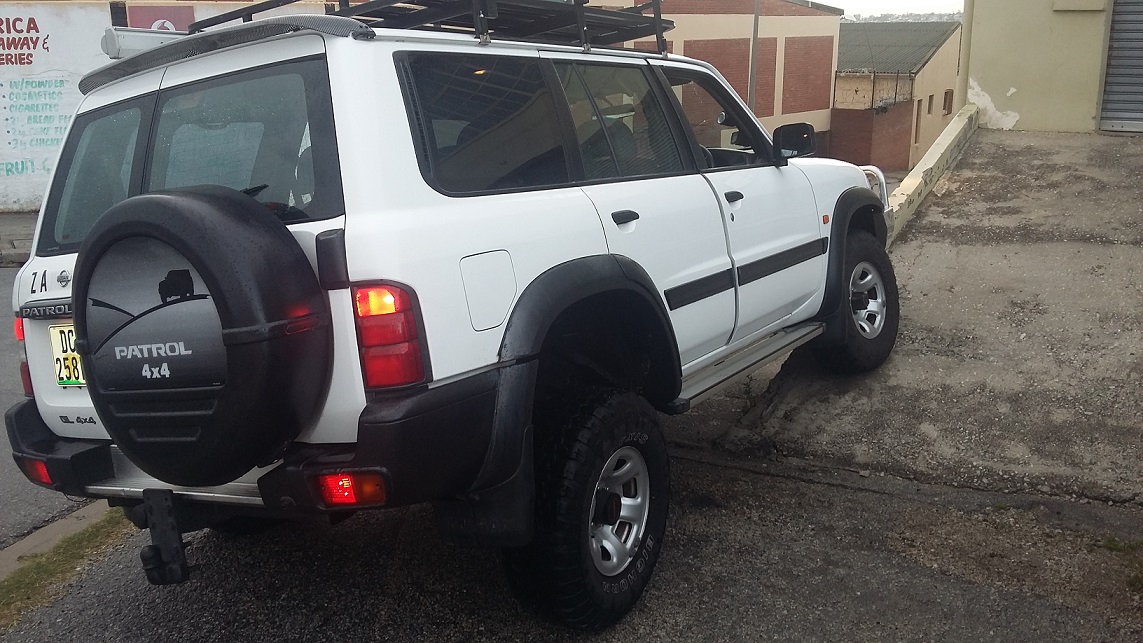

A little bit of Friday flex :lol:
Would have tried for more, but the ramp wall starts where my front bar is at that point and there's an open manhole less than 500mm in front of where the front passenger wheel is :biggrin:
