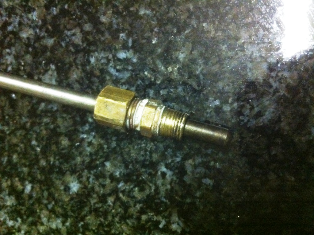

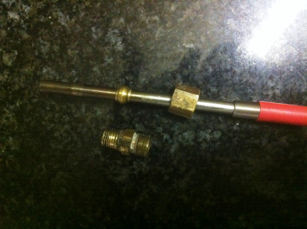

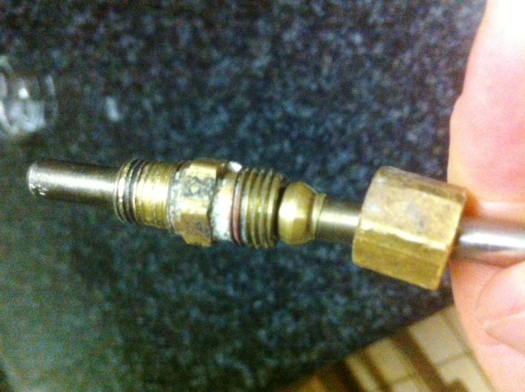

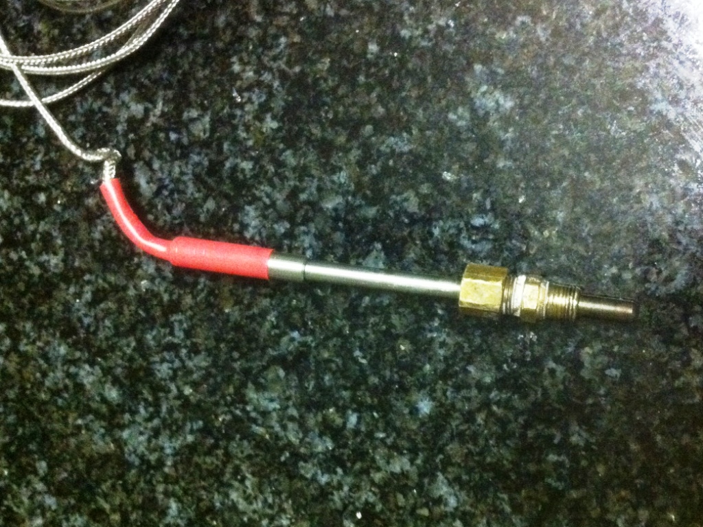

Lyk hierdie probe nog bruikbaar? Die skroefdraard is bietjie beskadig maar daar is seker maniere hier om?
Dit lyk of die draad geknak het. Moet daai "ringetjie" om die probe wees?

Feedback from madman regarding probe fitment:
"The brass "olive" must be there, it becomes locked on the shaft after the nut is tightened the first time.
Yes, you can buy a replacement fitting - it is here :
http://madman.co.za/index.php/products1 ... on-fitting
You would need to file the brass "olive" off the probe and slide it off to fit the new fitting."

ja daai brass fitting ( ferrel) grip die probe en die fitting vas aan mekaar hoe stywer jy hom draai, hoe meer hou hy vas. die res lyk wiele

From my past experience, just looking at your probe wires, don't even think of using that probe. One thing you must never do is to bend the wires anywhere close to 90 deg. The wires on your probe look way beyond that - check the thread on this forum "Madman / Landy on Line" and get yourself a new probe from Brian. I wouldn't trust the readings coming off that probe.

Thanks Tony, i mailed Brian(madman) about this, here is his response:
"The kink could be a problem, however, the cables are well insulated so it is unlikely that they are touching inside.
The probe works by simply joining the two wires in the tip of the probe, so, if they are touching at the kink, the measuring point is now at the kink rather than in the tip.
To test this, fit the probe to the unit and power it up. Heat the tip with a lighter, it should go from ambient temp to a few hundred deg quickly.."
I will test it first
