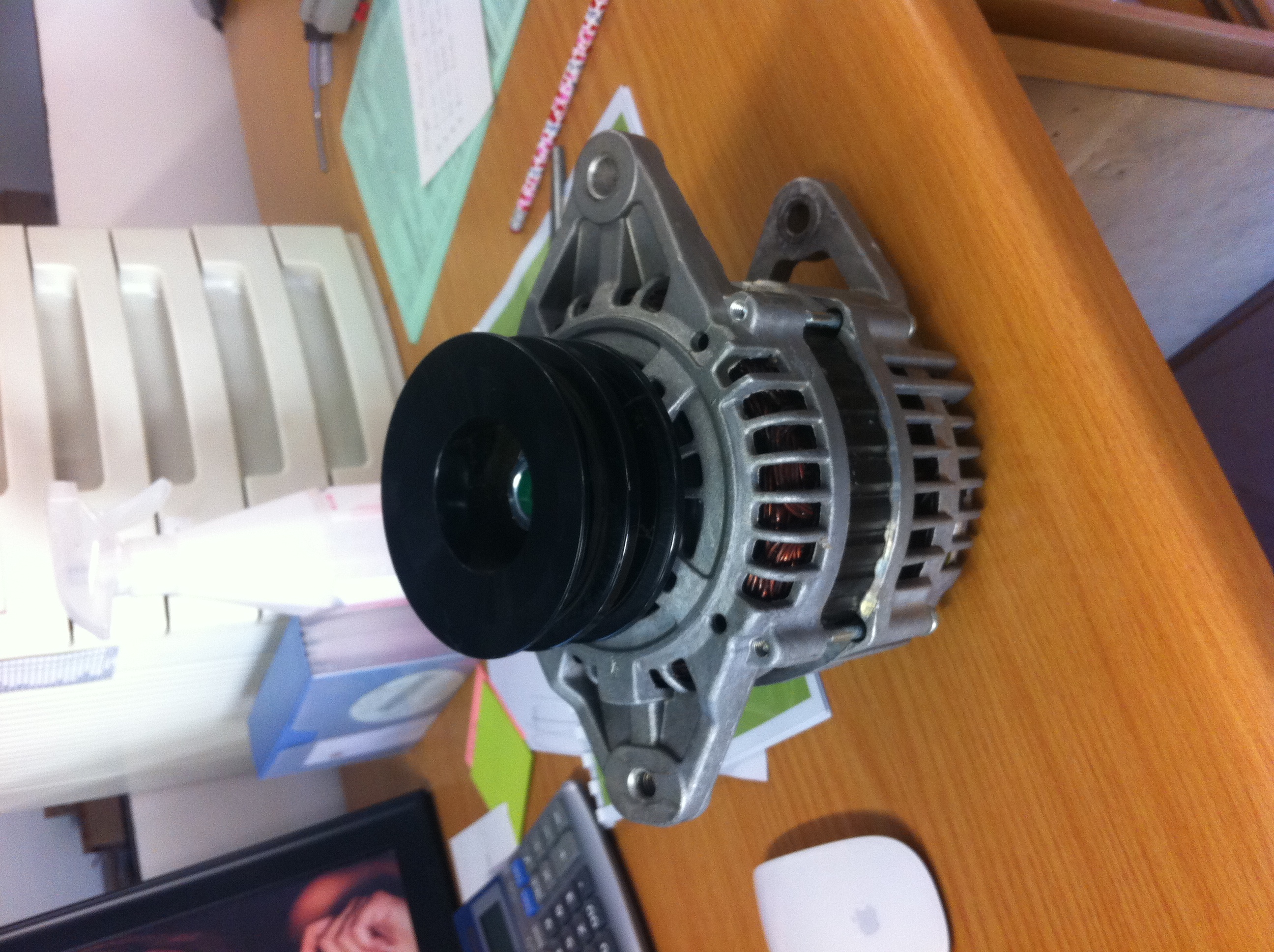

Re: Battery or alternator issue
is yours dbl v-belt or a single rib belt this alternator is a fong-kong aftermarket and fits almost perfectly on a 4.5tb,even the wires just clips in and is a 90 amp
autozone did sell them for R1000.00

Firstly the Lexus 1UZ alternators are not that easily available as you might think.
The engines outlast the alternators, and they get imported whole as one set-up. So free alternators are getting scarce.
Found one at last from good old Bet at BG Autofit.
On Wednesday morning I brought the new (newish) alternator to replace the old one.
The old one's stator will be rewound and put together again as the spare.

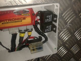

Call the guy who built the conversion. There must be a little fusebox installed, with two relays close to the Spitronix ECU.
No fusebox. Me and the auto electrician search. Still no fusebox.
So eventually the guys have to close shop and I go home very puzzled. What was not working and why?

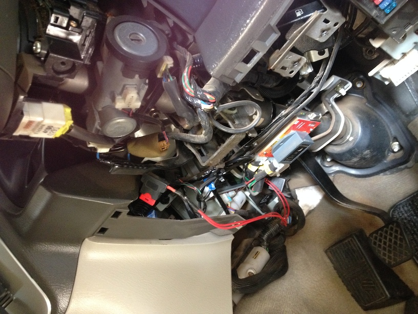

And the guy who built my conversion sends me a picture of what the ECU, with fusebox and two relays should look like. These items comes standard as part of the kit. So no reason why the fusebox cannot be found!
The standard picture of the engine conversion kit looks as follows: Mine looks like this: As from this picture, having taken off the cover just below the steering wheel, one silly innocent looking little fuse is found (see the red wire).
Now this picture above was taken after the auto-electrician moved it down from where it was. It was high up, right next to the steering wheel.
It was blown and once replaced, the pump worked again. But this fuse operates the ECU.
So for the record, I still have not found the phantom fusebox. I will make a strip to car builder to show me. That will be interesting.
Where the fuse used to be, it is certainly not the best place to hide a fuse, unless you do not want it to be found!
