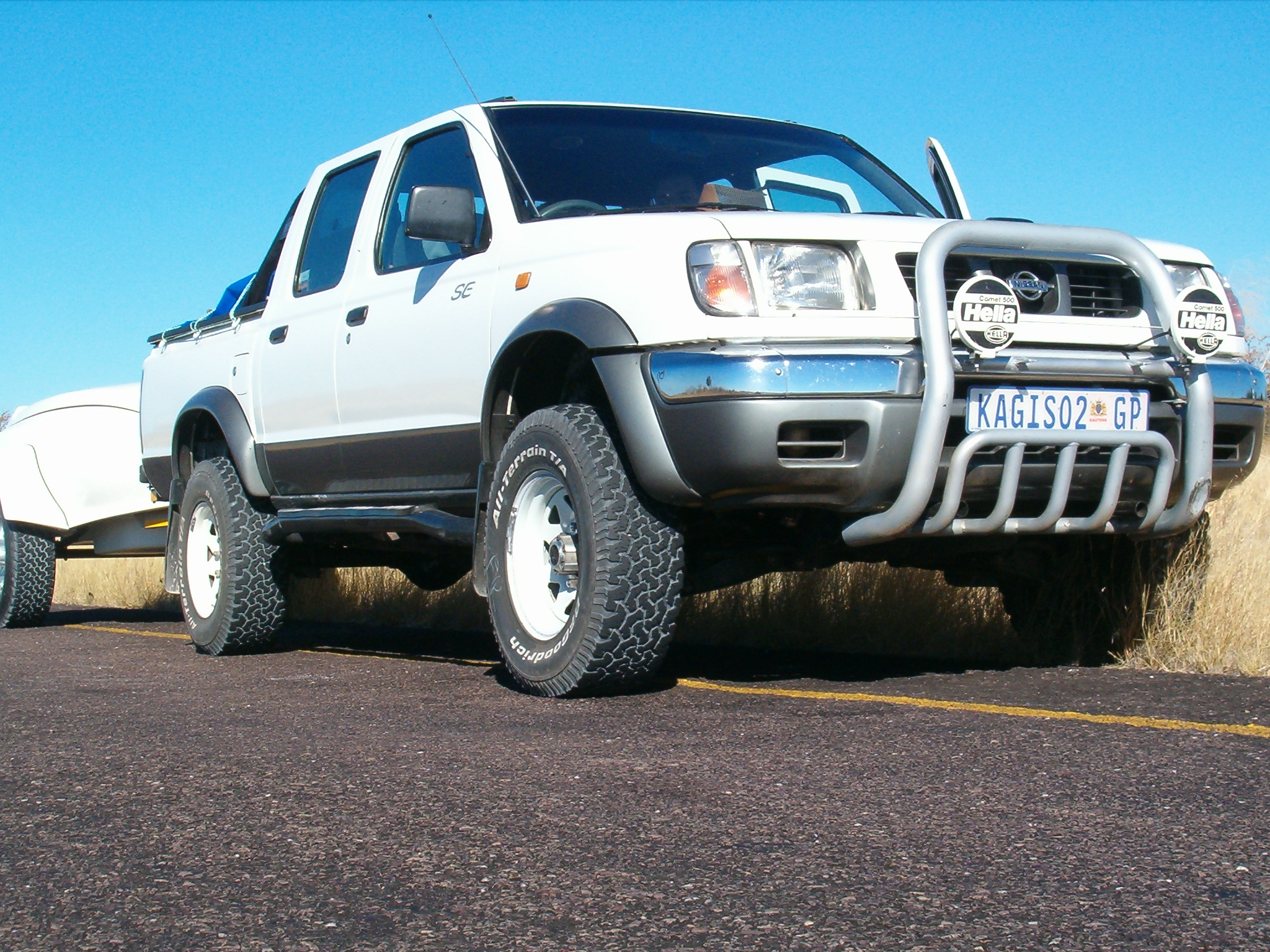

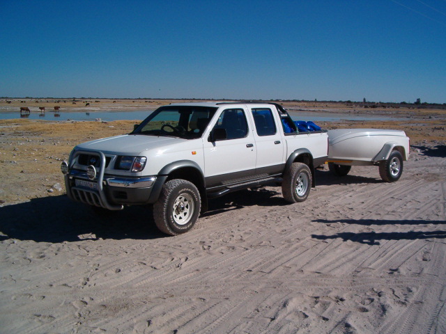

Re: CAMIL SHOCK MOD
BRUTUS -- standing straight & proud on his CAMIL suspension ..Fully loaded with 30 Jerry cans Water / Diesel & Petrol
One blade at the back removed for comfort for the outoppie's problem back.
