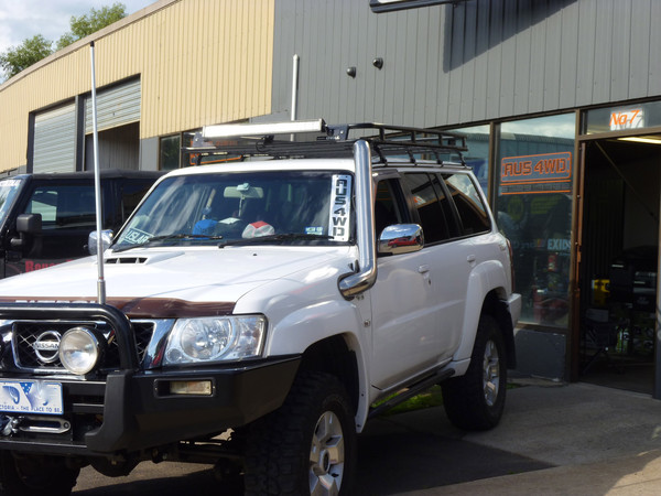

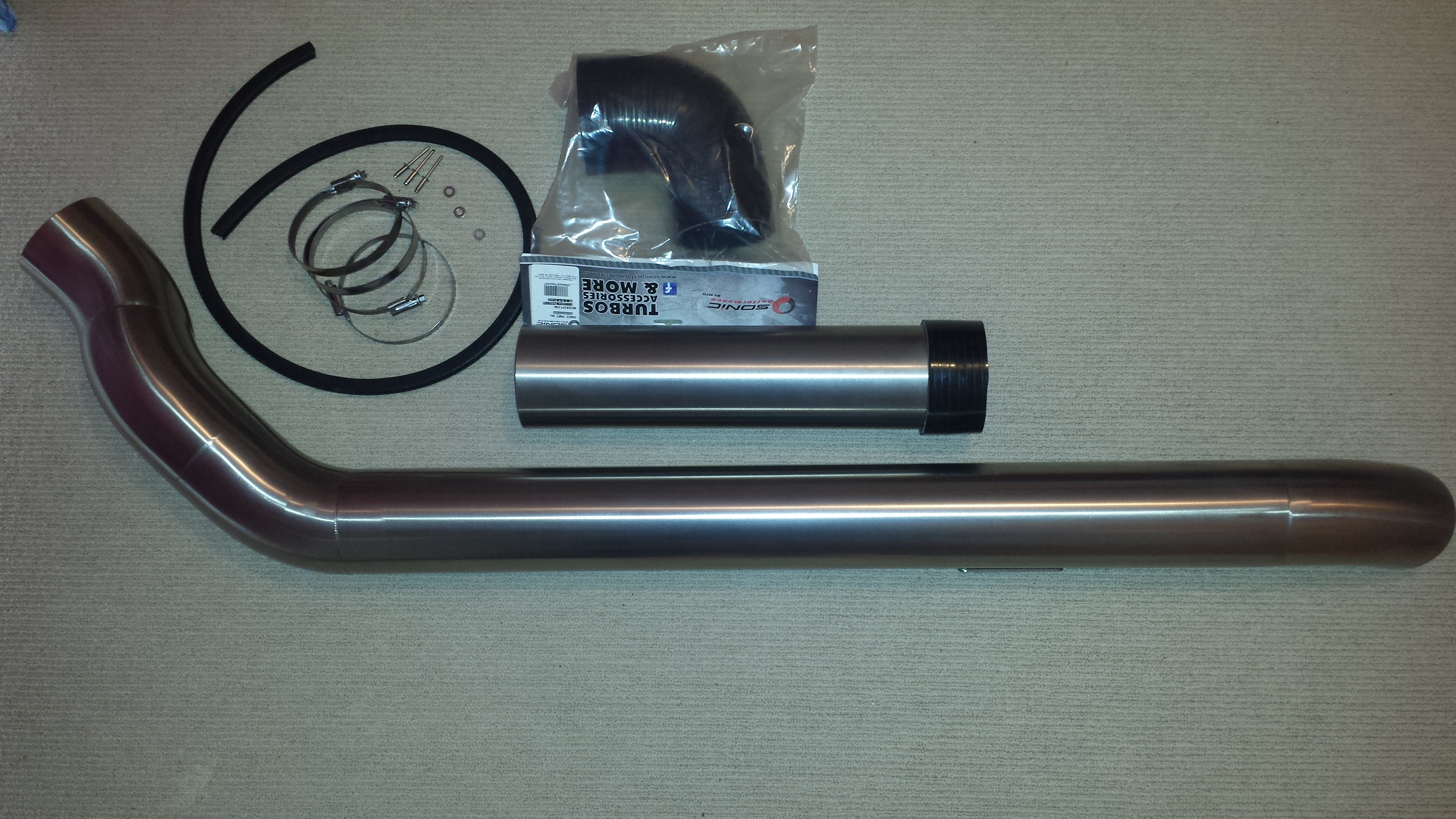

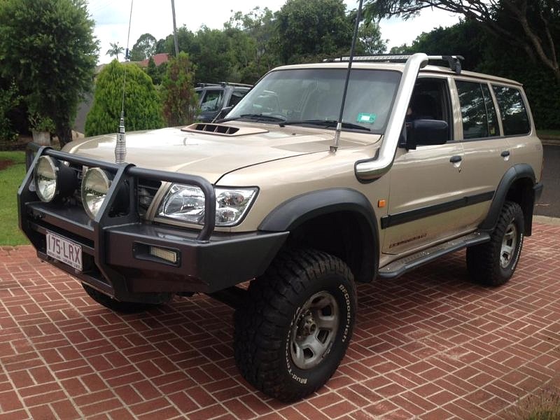

Hi All
I think its time to start a new Project with My Patrol..... So i was thinking of fitting a snorkel, While searching on the internet i came across Raslarr they are in Australia. They build stainless Steel 4' snorkel for the patrol's... really like the look of them and there kit is not a huge build... So it should not take long to manufacture.... but Before i build a snorkel, since i have never built one... is there any do or donts when it comes to them... i will post some pics to show you guys what the snorkels look like and the kit..... Any help would Great....

Hi Rob, why don't you just fit a standard plastic one (about R2000 I think) from the photos it looks like you have to cut a big hole in the fender that does not look like it is sealed, also a word of caution it is a mission fitting a snorkel to the 4.5 I ended up taking off the whole fender to cut the holes!!

So getting back to the snorkel idea... if i build a 3" or 4" snorkel i take it that there is no special baffels or ventures in them it is basicaly a straight pipe coming out the air box to a higher point??
